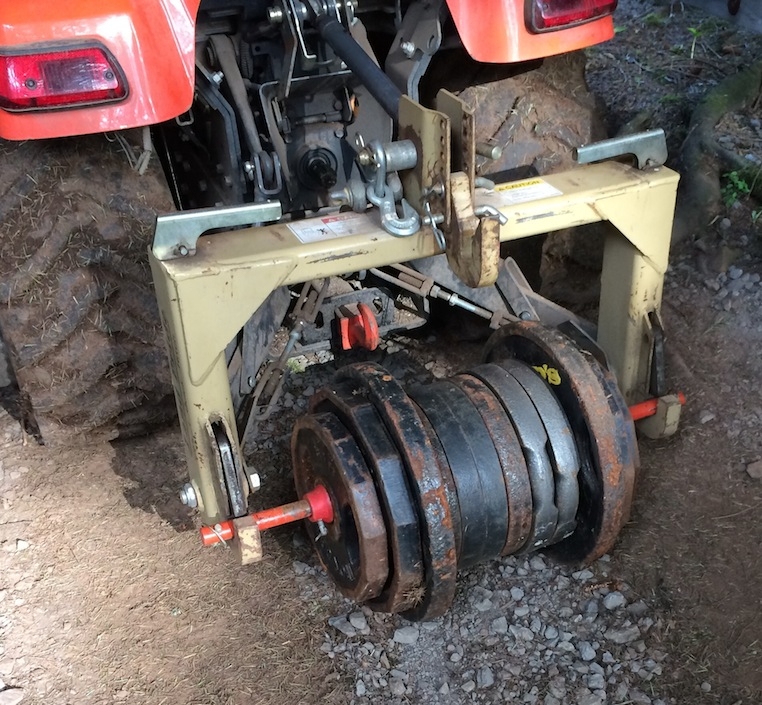

Not quite, but just as effective, unless you need an implement, too.
Bruce
   / Quick Hitch Suitcase Weights
That’s clever. I already own the suitcase weights, and thought about rigging up directly to the Quick Hitch similar to what you’ve done. That’s exactly what I did on my previous tractor. However, as I get older, I have made a number of dolly’s to enable me to remove & store all my implements w/o breaking my back lifting anything every time I need to remove.

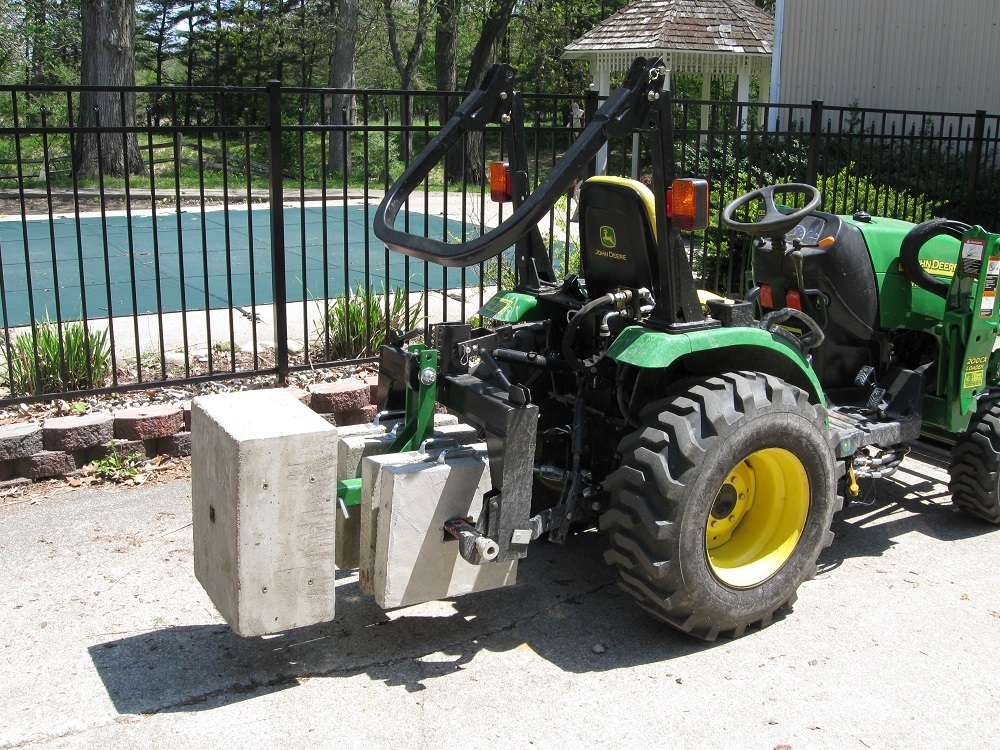

I made my own "suitcase" weights out of concrete, but this is the kind of bracket you need. Mine is also a trailer receiver. Mine is made of a drawbar, receiver tube and flat bar.

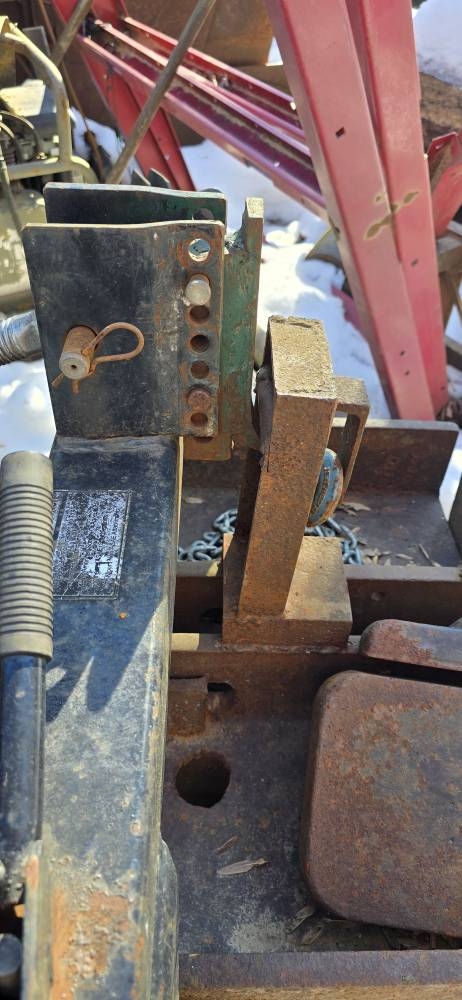

Here's how mine mounts to the quick hitch I have. (Harbor Freight) You should be able to fab something up that works for you. This was all scrap I had laying around.
