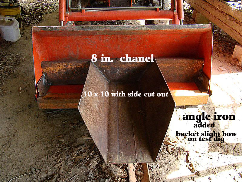

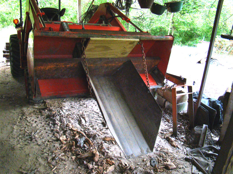

Here's my efforts so far, still need little more mods.
Have moved mounting back as far as it will go.
Not using the angle iron across bucket.

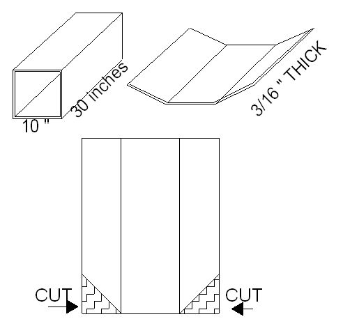

So you made yours out of 3/16 is that strong enough or does it flex around I would be doing something similar but I wasn't going to make me ears stick up so far more like a spade shovel.
No flex in the "spade", but a little in the FEL front edge.
That's why the chains were added.
The most difficult part of this was bending into shape after cutting out one side of the column. Finally had to impose on a friend with a "multi" ton press.
Also the channel iron bent on first try. Straighten it out and put block behind.
