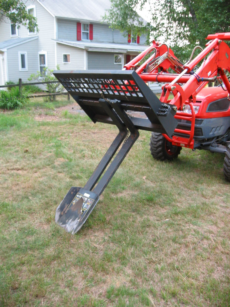

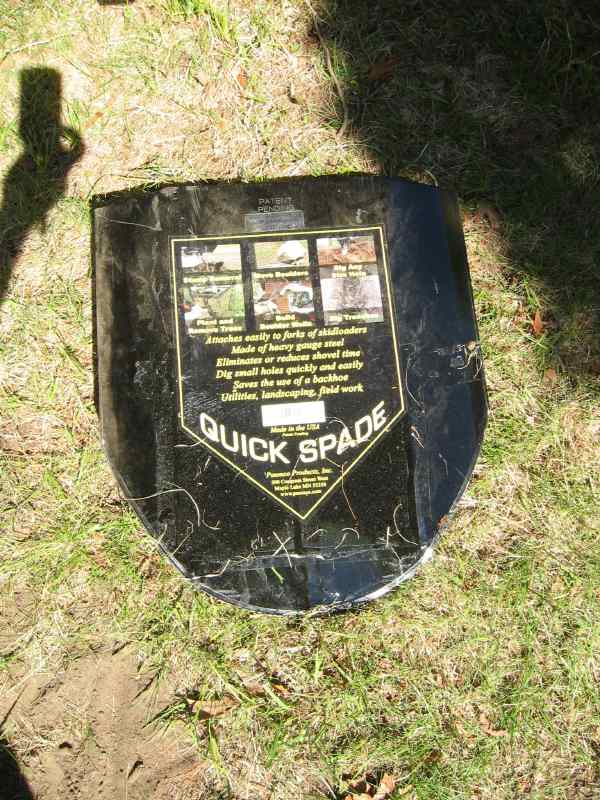

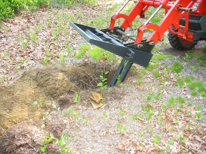

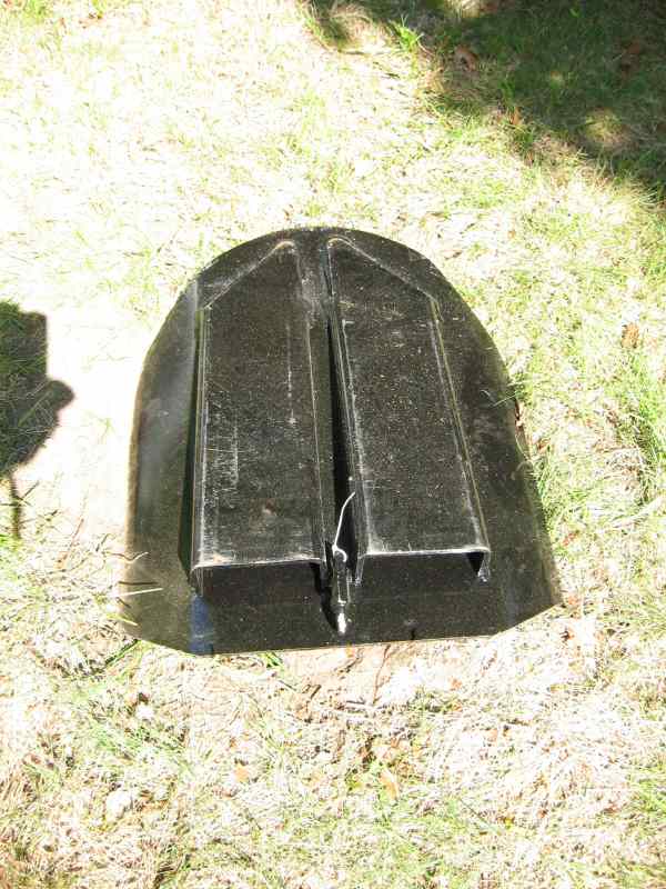

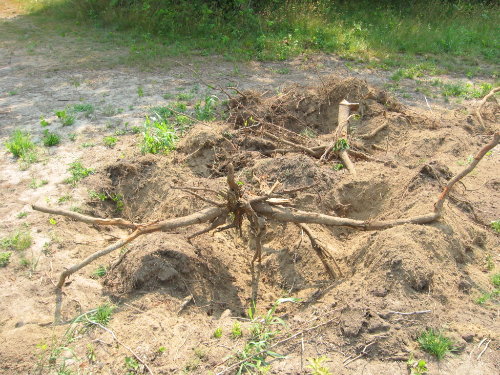

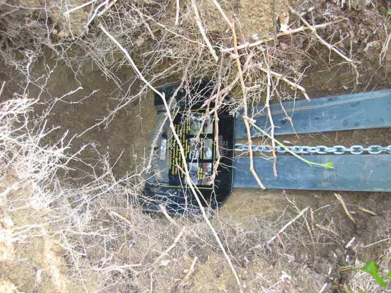

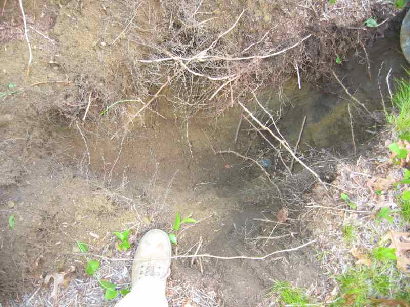

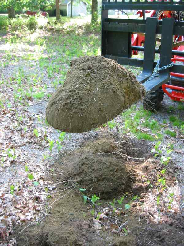

I have hooked mine up a few times and think it is a very useful attachment for anyone with adjustable forks. I don't recall exactly what I paid for it but I think it was about $150. It would not be too hard for someone with half decent welding and metal working skills to make one up but it seems a bargain compared to most implements.
My major pros are: makes quick work of shovelling. Each Quick Spade bite is about the same as 4 or 5 manual shovel fulls and you can use the weight of the tractor rather than your foot to dig in compacted soil. Allows digging to about 4 feet without the hassle of putting the backhoe on for a small job and without the five foot wide hole you get with a standard FEL bucket. Very good for preparing to transplant small/medium size bushes as you can dig under the roots without hurting the plant as you would with a BH. Would be just as quick as a BH for trenching, maybe faster. Also works well to dig out small stumps and is much faster than moving the tractor/backhoe to do that on the stumps up to 4 or 5 inches. Also less mess than with a BH stumping.
Cons: I wouldn't like to trench with a tractor with a standard tranny as you need to move the tractor to dump a shovel full to the side. Requires a whack with a sledge hammer to get it off the forks once jammed on by digging. I have the fork version but a con for the bucket combo version is that it would only dig about 18 inches before the bucket itself touched ground. Still, if you don't have forks it would be a worthwhile addition IMO. You could always add forks later if you wanted to dig deeper. I would not attach this thing to the bucket mounted temporary forks though. It can generate quite a lot of lever force while digging and it would likely bend your bucket. (I can lift the front end of my 40hp tractor up easily while plunging and can lift the rear of the tractor when trying to pop roots).

Not sure there would be any change in breakout force. The lever arm would be the same if the Markham is equally long. I have ?42" forks and the quickspade adds about six inches to that.
The Markham would be easier to mount but harder to store. Mounting the quickspade on forks just requires adjusting the forks to the closest position, sliding on the quickspade then hitching up the retainer chain (which is probably not necessary if you just "jam" the quickspade into the ground hard so it doesn't pull off). As noted, getting the quickspade off requires a whack with a sledge hammer (I use a small single hand type).
I'd imagine the Markham version would be more to ship as well.

I've only had the quickspade for a couple of months. However I find that I am leaving it on the forks as I use it more than I use the forks alone. I'd never attack a major digging project with it in preference to the BH but for digging up a bush or two, especially if I want to keep them healthy for transplant, it is much preferred to the BH. I suspect it would be faster than the BH at cleaning out ditches too. To dig a trench it might also be faster than a BH given the amount of time you'd spend moving the BH. As a FEL mounted tool it also is very convenient to use as you are looking right at what you are digging etc.

Hey Island Tractor, in image #9, I notice your gloves on the ground. Have you been looking for them?
It seems to me, just butting the forks would do almost as much as the quick spade. I recently purchased some forks, and have been going after the deep rooted, painfully persistant, Canada thistle. God knows how much I hate that stuff.
Even if I don't dig it all out with my new forks, it feels like sweet revenge, having struggled for years with a spading fork, and a size 8 1/2 D boot.
   / Quick Spade Review? #11
Found the gloves. Thanks.
I think you are correct that the forks alone would also work for root and stump popping. Not so much for the true digging though.
