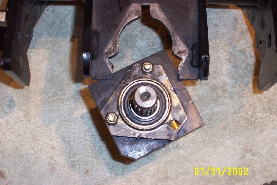

I'll take a picture of the new 4310 bracket when I get home tonight. My 790 bracket looks identical to yours. Here are pictures of what it looked like after it broke and what the repair in progress looked like.
Cheers
Perry

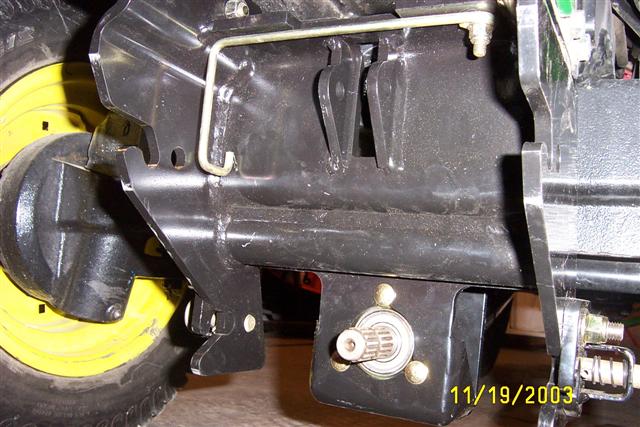

here's the second picture of the 790 bracket

I appreciate the info and pix. I'll certainly keep an eye on it, and seriously consider 'beefing it up" beforehand as well. Musta made quite a noise when it let go... Anything else get broken?

It didn't really make much noise. For a second I thought
that I had sheared a pin or got a rock stuck the blower.

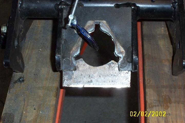

Nothing else broke. Here's the first of three pictures of
the new bracket for the 4310. This bracket has a cube
like cage that holds both ends of the pto coupling unlike
the 790 bracket.

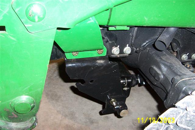

here's the second of three pictures

And here's picture three of three. I guess three strikes
and I'm out.
