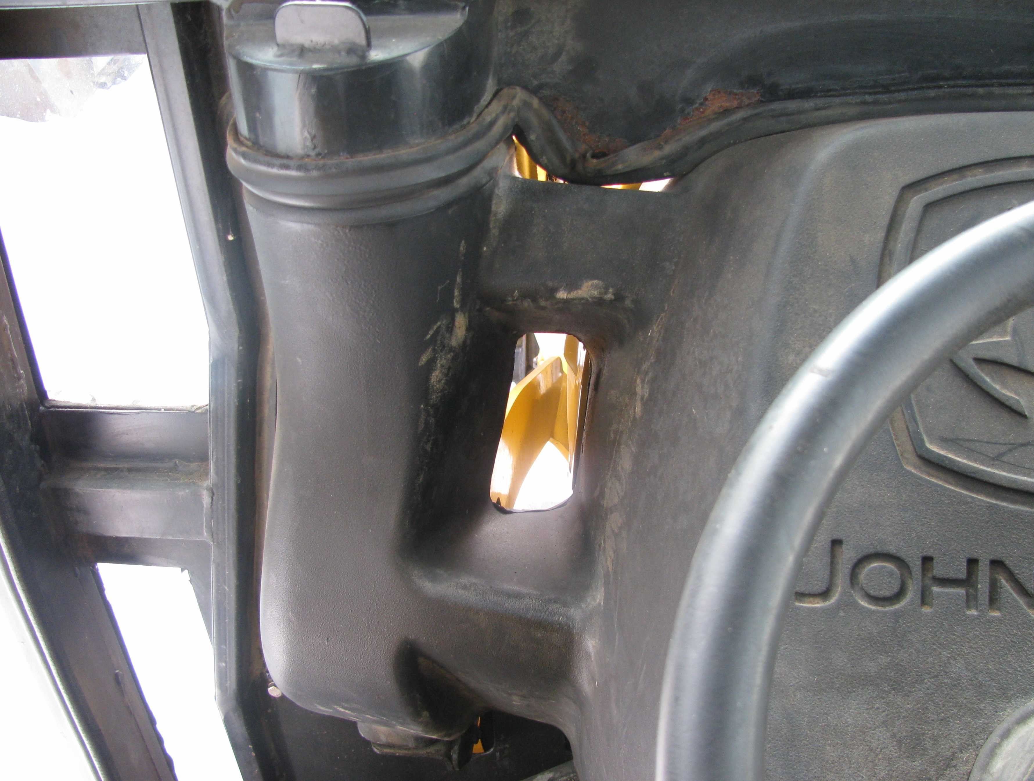

I find that I get more diesel exhaust in the cab than I care for. The voids around the fuel tank and adjacent to the steering wheel, particularly the left, allow the exhaust in. Are yours open or plugged? Ideas?

Your ideas on previosly mentioned voids in fuel tank housing?

Mine has the bulb seal as well. It seals okay but I do see gaps. The voids I speak of are inherent to the tank assembly of the JD110, visible dead center of images I post. Are yours plugged, open or...?
My cab came with two shaped pieces of clear lexan that I had to glue in those holes. Bet the dealer did not install them on your cab. I would plug the holes as I don't recall ever needing to see through the holes anyway.
The previous owner did the cab install. I believe I see the remnants of the glue there. Perhaps I'll contact Laurin for those. I also need a new heater blower switch connector shell and wiper blade refills anyway.
