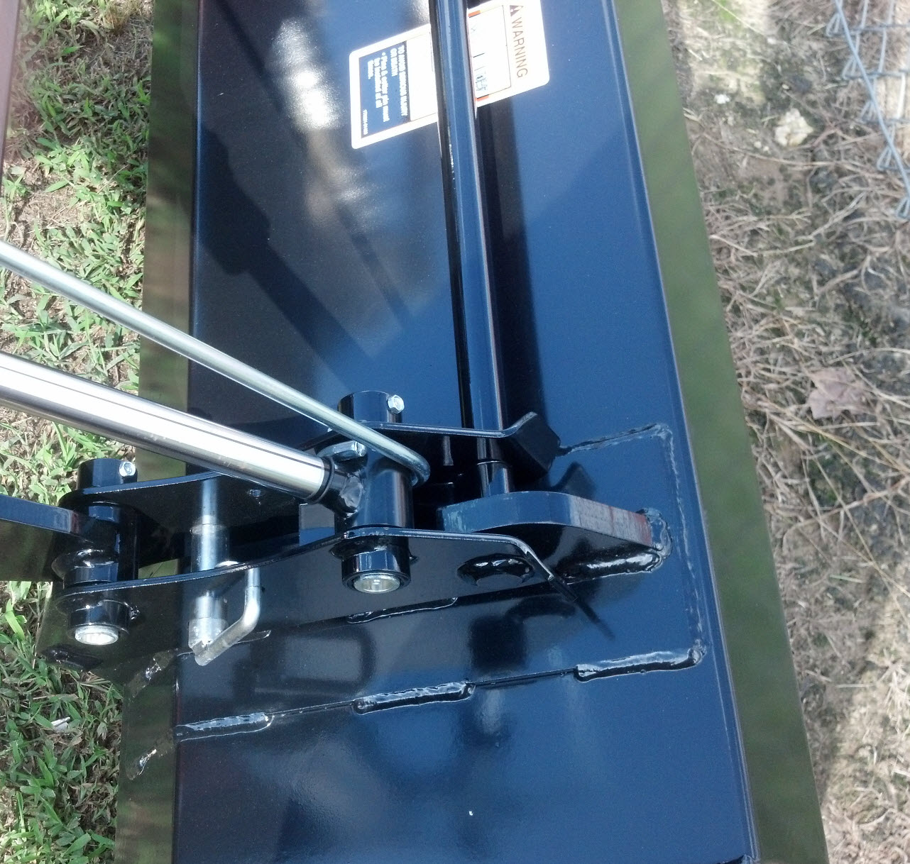

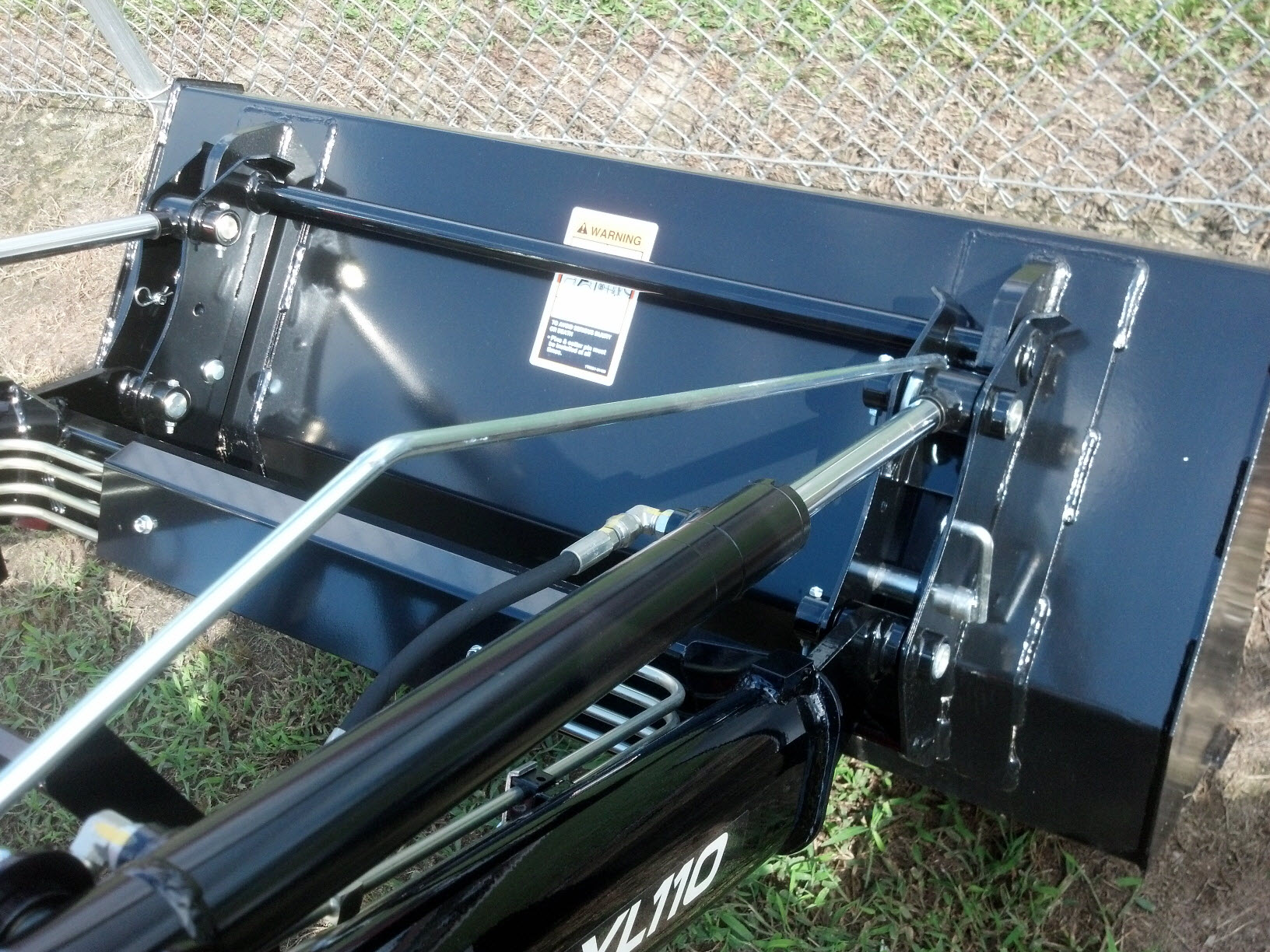

Is the quick tach loader hook ups on the new 424 the same system as skid steers use or is it proprietary?
Thanks
Chris
   / Quick tach loader system #2
I would guess that they would not reinvent the wheel. That being said I would get out the tape measure and make sure. Skid steer measurements are on here if you search for them. You want the ssqa except no other.
   / Quick tach loader system #3
My Lx490 loader is skid steer quick attach. I drop bucket and attach grapple in minutes.
   / Quick tach loader system #4
Thanks
Chris
Looking at a 324 with the YL110 loader, the quick tach is proprietary. I can only assume it's the same on the 424 with YL210 loader but they didn't have one on the lot. I stopped by my Yanmar dealer, Knightdale Tractor, to order a tire for my Sc2400. While I was there I checked out the tractors they had. I should have gotten some more pictures and tried out the tractor but didn't have much time as I got there right before they closed. Here's a couple of pictures on how the bucket attaches. It has a hook on top like kind of like John Deere.
