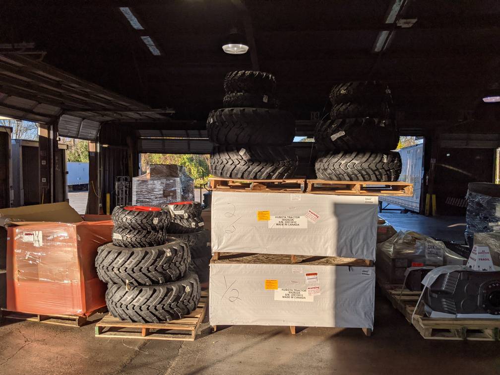

Just walking thru the dock this morning and saw 4 sets going out for delivery. They definitely seem to be very popular. This winter will be as good test to see how they do in the lake effect snow we get. PXL_20201105_124350153.jpg

Nice. Is that a Kubota facility, or just a general distribution center?
Do we know what ply these are? I personally gravitate towards R4s because of how thick and robust they are (avoiding punctures/flats). It would be awesome to have the increased style and traction of these R14s, but not if they are puncture prone.

It's a LTL trucking company. We move smaller accessories, attachments and tires.
