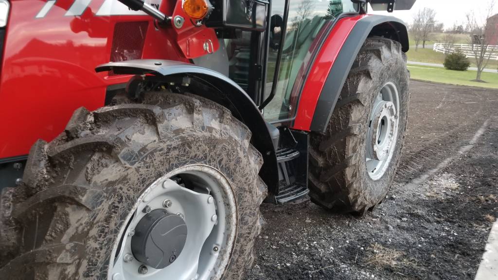

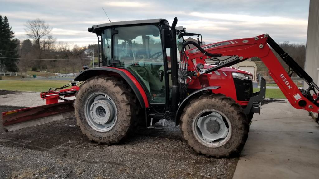

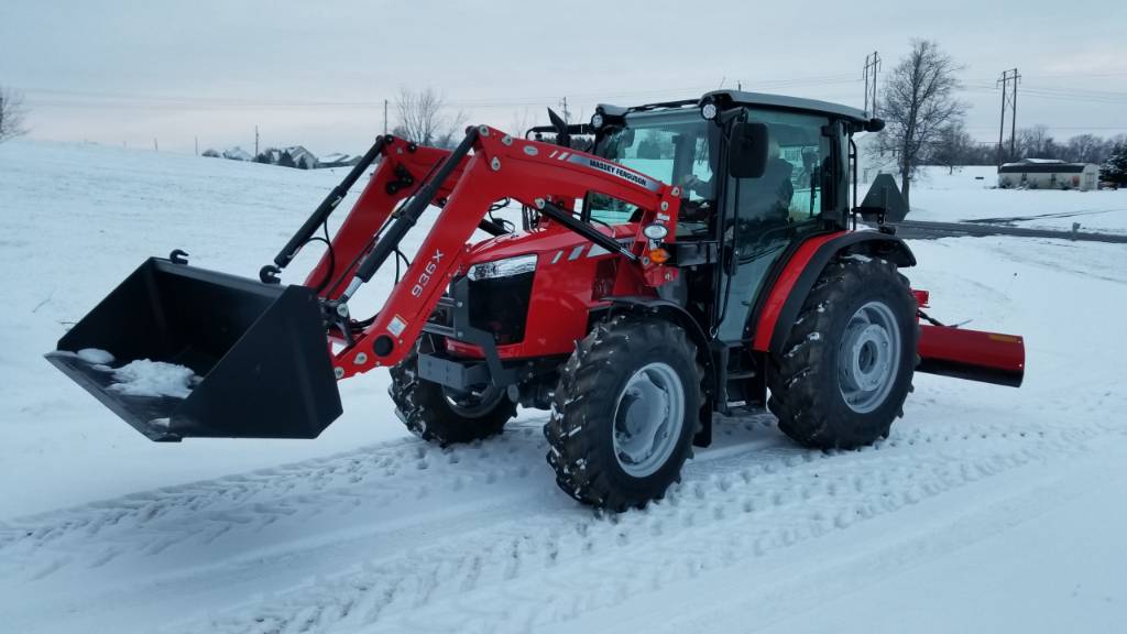

I have had R4 and R1 tires. R4 are best in a high scrub application running on concrete alot or where lots of sharp rocks may be present. You will sacrifice ride and traction with them. On R1 tires, you can get bias and radial tires. Radials run a lower pressure, ride and wear great, have excellent traction and great flotation. 20181224_113815.jpeg20181203_161455.jpeg20190113_164723.jpeg20181203_161430.jpeg

Forget the industrials. They are made for industrial applications where smooth ride on hard surfaces is desired and lots of traction is not the requirement. You want R1s and if you don't like the ride, lower the air pressure or buy one that has more of a continuous center line of rubber...it's all in the way the tread is designed.
Never had radials so I can't speak for them. However if you are worrying about getting too tall, since radial sidewalls "pooch out" at the lower air pressures and do a great job of gripping in soft terrain, might consider them.
I dug up a video of a gal plowing in Europe somewhere and she showed the benefit of radials in soft turf and how to inflate/deflate them depending upon if she was on the highway or in the field.....the term is like actual circumference vs rolling circumference...some tire sites list both dimensions for their tires at a given air pressure....course if you are in rocks and all, you don't want your sidewall pooching out to get damaged.
