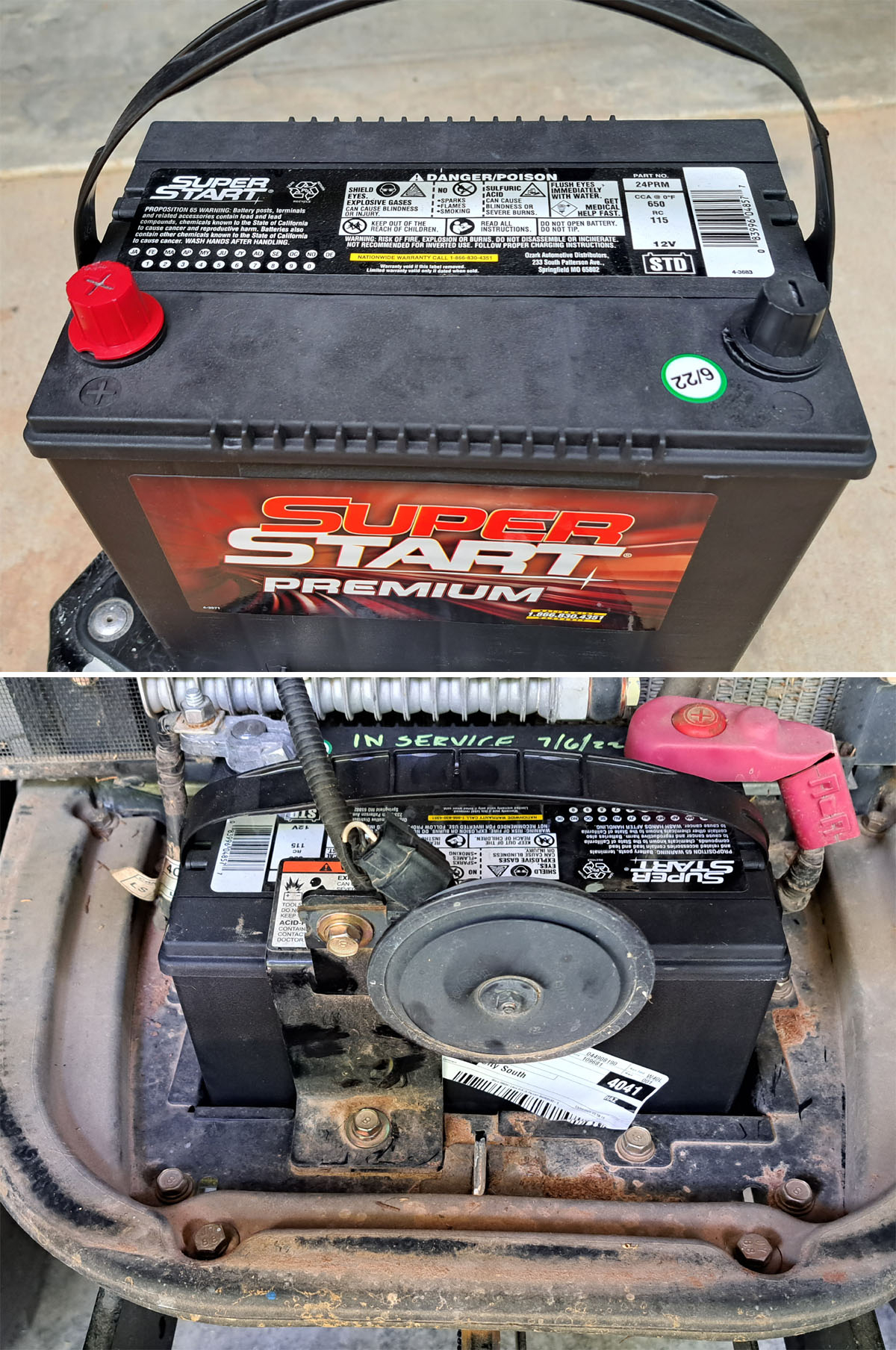

I'm trying to find a equivalent battery to replace my 8 year old battery in my R4041H.
The dimensions are approx. 10 5/8L x 6 1/2W x 7 1/2Tall.
12vdc, 80AH
Anyone else able to find a standard battery that will fit?

battery size chart in the link so that you can search by group size. i always look for the most powerful battery that will fit.

Recheck your measurements. I just measured the battery on my R3039H. It too measured 6.5" across the top. But, look below the top and I think you will find that at the seam between the top and the case is wider.
The measurements on my battery match a Group 24 battery.
Most any competent parts store will easily be able to match your battery I'm sure.

I'm going to have to pull the battery out and bring it to a local store.
   / R4041H Replacement Battery #6
Don't overthink it. It is a Group 24 battery.
Google isn't much use as group dimensions are "not greater than". Even the parts counter computers are not much help.
Arm yourself with a tape measure and go to a store with a good battery selection. Here is one from O'Reilly with the part number of 24PRM. The sad part is that is now a $180 battery with only a 2-year warranty
