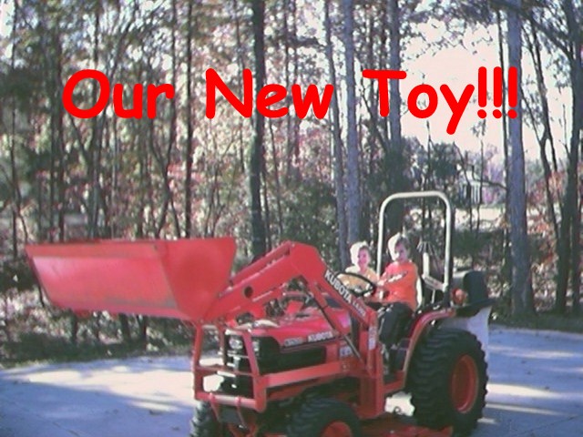

I have a B7500 with R4's and a new lawn. It hasn't been a problem yet. I did let the lawn go for quite a while before I mowed it for the first time though. I'm sure my neighbors were beginning to wonder about it. We don't have much black dirt here...(mostly red dirt) and I don't have any wet areas either and I think that makes a big difference. I also opted for the grass catcher. It's nice because I don't feel compelled to try and mow if the yard is too wet after a rainy period. It just gets a bit longer and I bag it. I decided on the R4's because I was getting the loader and had heard that they give better support for that type of work. If I was not planning on the loader I'm sure I would have gotten the turfs. Oh, and thankfully no snow issues here!/w3tcompact/icons/smile.gif

Yes, and it's a really nice piece of equipment. The only problem is the bag capacity is too small. When I finally mowed the lawn the first time, I was spending a lot of time going to and from where I was dumping the clippings. Since then it has been better but I would still like to expand the size of the bags somehow. It also works great for vacuuming all of leaves that have fallen. However, if my yard had been flatter with less obsticles I think I would have seriously looked into the Trak Vac tow behind trailer with the blower that works off the PTO.
