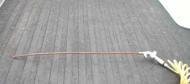

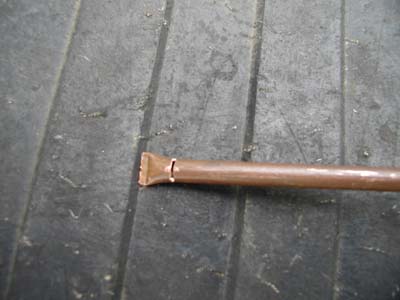

The radiator on my B7500 had a fair amount of dirt/fuzz/etc. on it that made its way through the screen. With some stuff I had lying around (and a $1.79 1/4" compression fitting from True Value) I made a wand to reach in behind the radiator and blow the junk out. The wand is 1/4" OD copper with one end crimped shut. Just behind the crimp is a slot cut via hacksaw for the air to discharge out the side. With the compression fitting, it would be easy to make another wand of some odd shape or length for the next tight spot...................chim

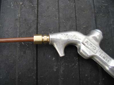

Gun end
   / Radiator fin blower
Whole thing

Worked like a champ. (Wouldn't have posted it if it hadn't /forums/images/graemlins/smile.gif)...........chim

Now that makes a big difference; I didn't use the rigid stuff. /forums/images/graemlins/grin.gif I just thought your picture looked like the tubing was bent a little and assumed (yep, erred again) that you used the same thing I did. /forums/images/graemlins/crazy.gif
Bird, you're right - it was bent a little. That allowed me to reach in between the fan and fins without poking the fins. The hard tube can be bent slightly by hand. For tight bends or 90's it requires the use of a tubing bender. I never worked with hard brake lines, but think they'd be comparable in the way the materials are to work with........................chim
