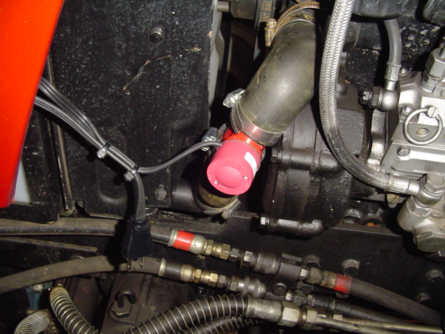

with good ole winter coming on, I want to make sure my F/P 2425 will start so I can show the Deeres, Fords, and Massys that I can clear their driveways while they try to get out of their barns---so--- can someone possible tell me the diameter of the heater fitting that will fit into the radiator hose. Farm and Fleet has them---but they have several diff diameters. Also--I want to change the injector oil. Am I correct that I take out the two bottom nuts on the injector pump, drain the oil, and refill till oil comes out the fitting with the rubber cap . Does the drain {with the banjo fitting and rubber cap} have to be loosened like a petcock valve or does the oil drain out just the way it is. I have Farm/Pro 2425 (rebadged Jimmna 254). Thank for any info. This is the best tractor help site that I,ve ever been on.

I assume that you are asking about the 120 Volt induction heater that splices into the lower radiator hose. If your Chinese beauty still has the original engine coolant, drain the coolant, discard it, then remove the lower radiator hose at the radiator. Measure the radiator fitting at it's narrowest point. This will determine the outside diameter of the heater you want to install. You will need to cut out a section of the lower radiator hose in order to install the heater. Use Prestone or the equivalent to refill the cooling system because Chinese coolants and lubricants are a piece of crap.

At least in my "neck of the woods" NAPA had the heaters for about $30. I just cut the hose where I wanted to install the heater and went and bought the size I needed. Plug it in for 30 minutes before you try to start it on a cold morning and it makes a huge difference, it will fire right up-saving the battery and the starter.

I bought my Katz heater at the local Autozone for around 20 bucks last year. I can't remember the diameter, but you can just cut the lower radiator hose in the spot you are going to install the heater, measure the inside diameter and match it with the heater in the store. You can always bring a small piece of the hose to the store, and try it on the heater directly.

Here is the Katz part # for a 254 series Jinma with 3 cyl engine.
