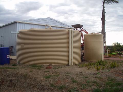

Please excuse my ignorance but in australia we use poly rain water tank.(This is mine). Do you not have them in the US
In the country almost every house has a tank Storage rangeing from 1000gal to 8000gal and in some cases several of these tanks.

I haven't seen anything quite like that myself. One issue that we have to contend with in my area is freezing. Maybe one like that could be heated. Most tanks would be underground, and anyone having a rain collection tank or cistern is the exception here...
   / rain barrels for water off roof? #10
I don't see why you could not bury the whole tank particularly with some minnor changes eg poly side struts placed inside.
By the way that tank of mine is 7000 gal and is buried about 3'6" in the ground. all the stormwater pipes (thats what it is called here) 90mm (4"?) pvc is glued and sealed. by doing this the pipe comes from the gutter down the wall of the house then underground and back up into the tank. /forums/images/graemlins/confused.gifhope this made sence. /forums/images/graemlins/smirk.gif
