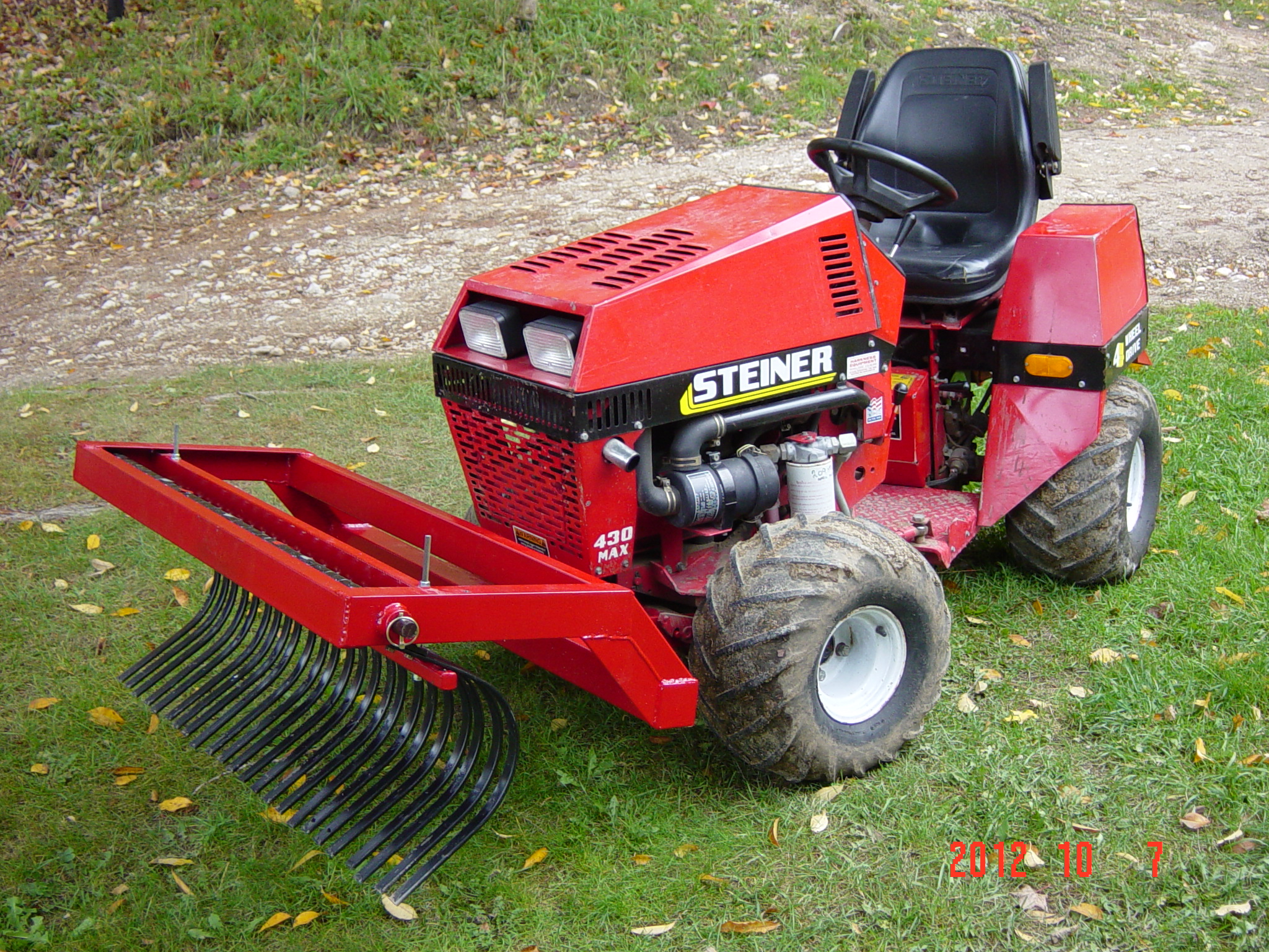

I built this for my Steiner for exactly this purpose. The tines are all mounted on a shaft and individually float to tickle the ground, or they can be arrested.
Looks great. Fun to see what people are able to create but so far I am not a fabricator/welder type guy. :)
