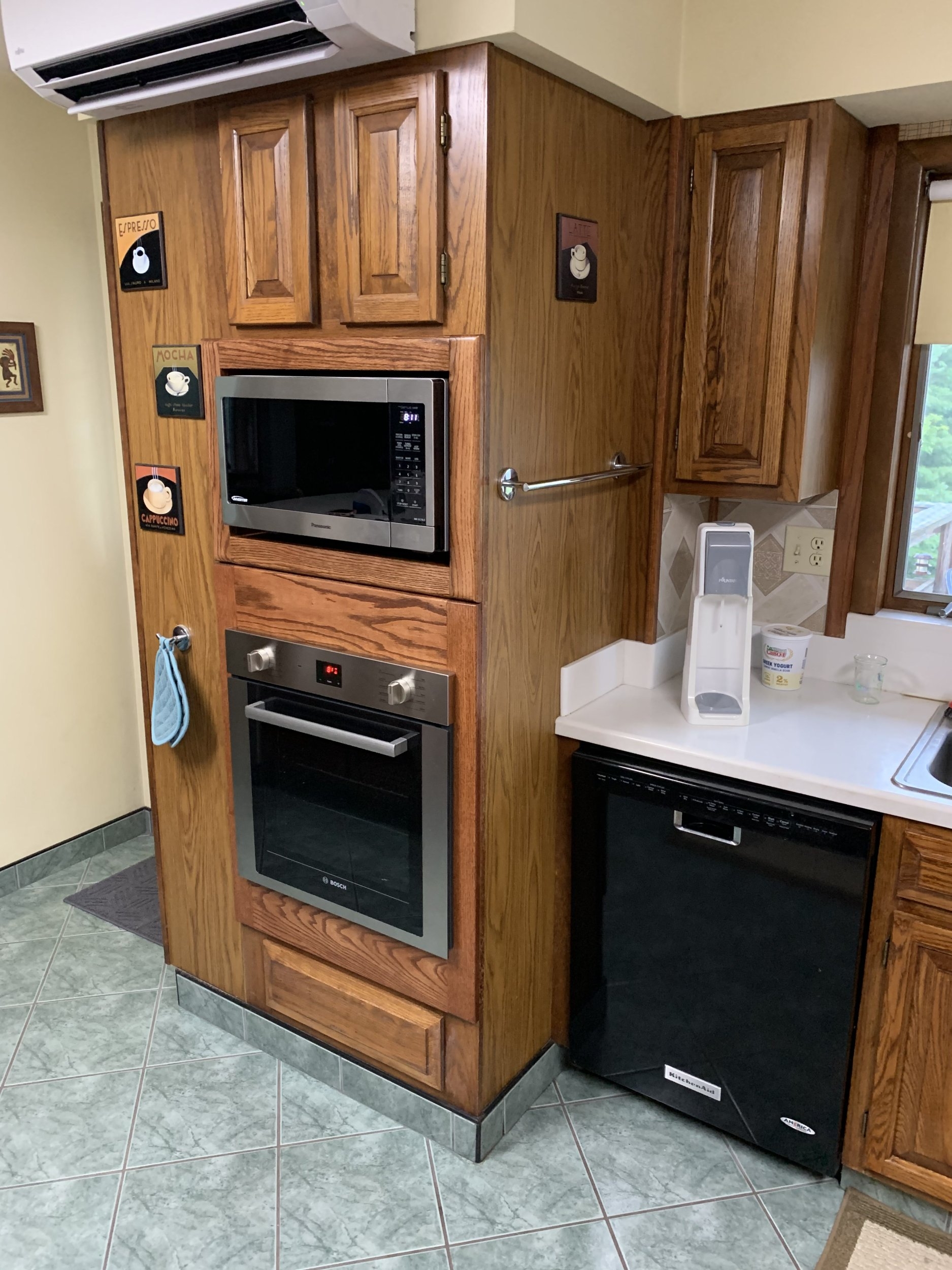

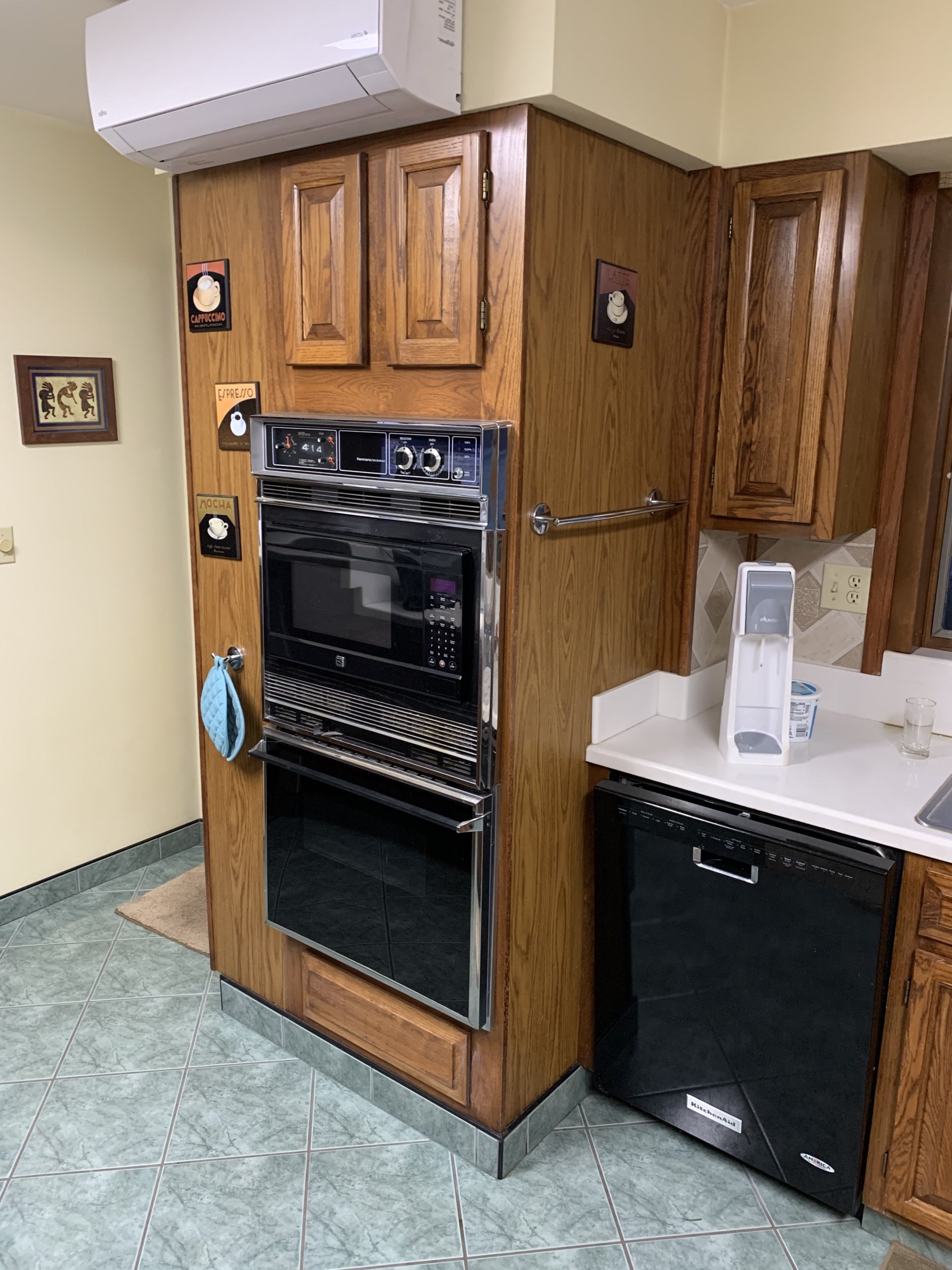

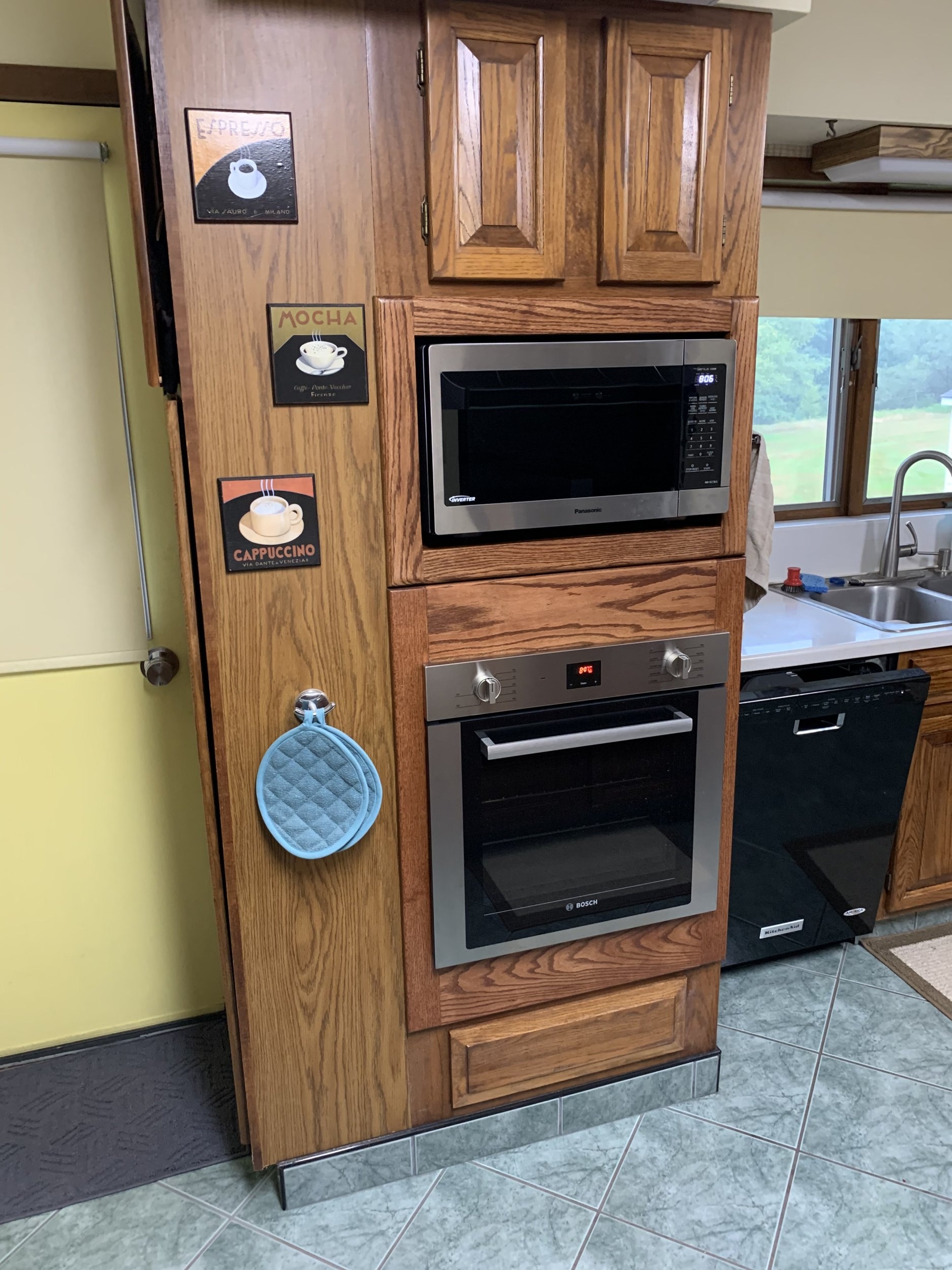

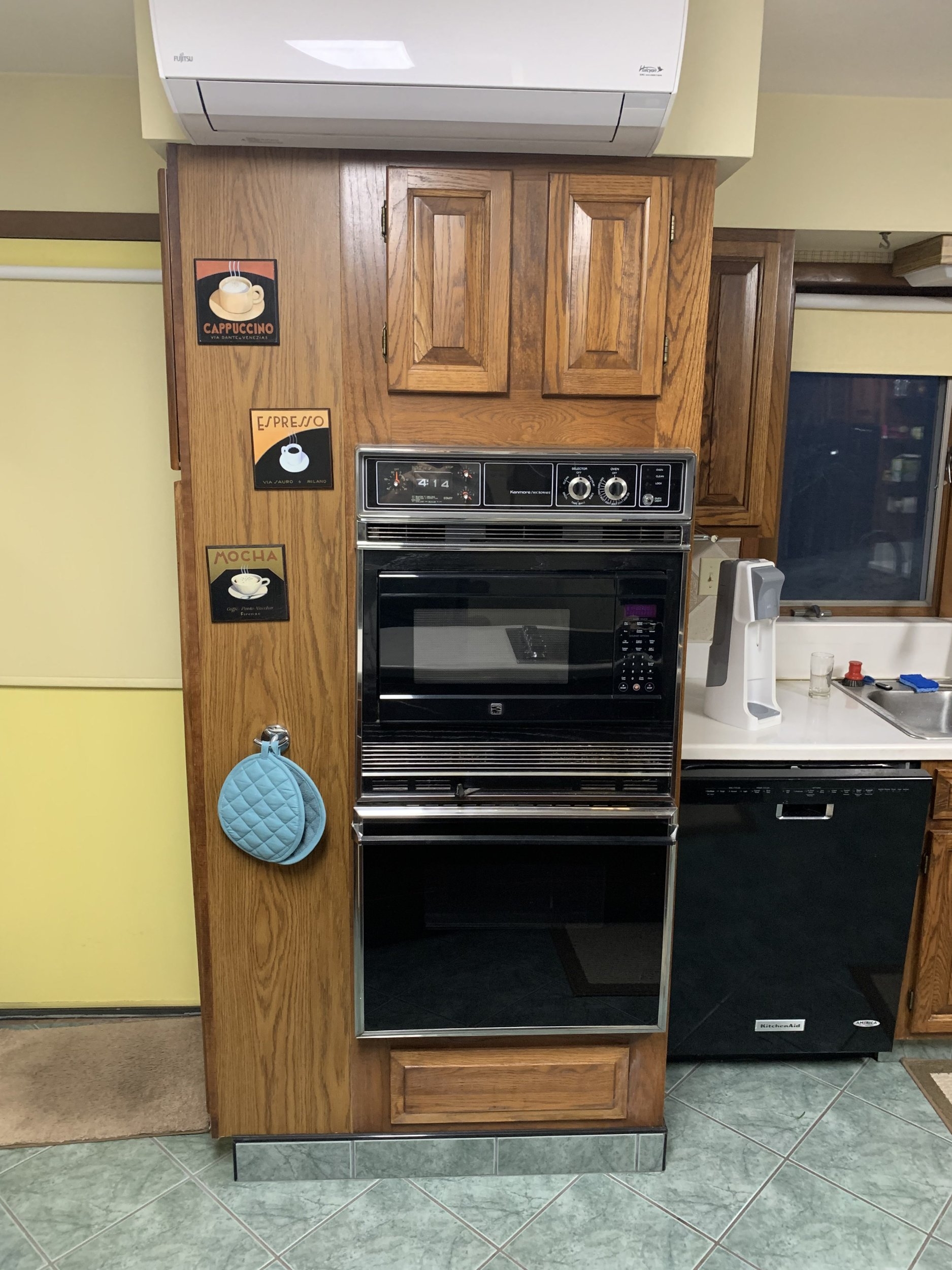

I'm 77 and just replaced a built in 35 year-old combination conventional / microwave oven.
The cabinet is an old style 24" wide unit and there are no direct replacement combo ovens on the market that will fit the old opening.
We talked to several contractors, but none would modify the old cabinet. All wanted to redo the entire kitchen at a cost that was out of our reach. All the other appliances have been recently replaced and the kitchen itself is in great shape, so I did the mod myself.
My wife and I tore out the old oven and I made a new oak cabinet front & stained it to match.
We've had trouble servicing built in microwaves before, so I made an alcove with cooling fan to house a standard sized countertop model, which is easily replaceable.
Old:
New:
Took about 2 weeks to construct in the shop. (working part time) My wife and I did the swap in less than a day so she wasn't without either oven. The hardest part was removing the old 400# combo unit. We couldn't lift it so I made a dolly and we rolled it out on the deck and onto a pallet. I used the forks to put it in the pickup and haul it to the recycle center.
The two ovens cost around $3200 and the wood & hardware another $150. For $3350, we have a fully functional kitchen again without any down time. Contractor quotes ranged from $40K to $70K and the work would take a month or more.
It's amazing what us old folks can do!

Old:
View attachment 883151 View attachment 883153
New:
View attachment 883154 View attachment 883155
