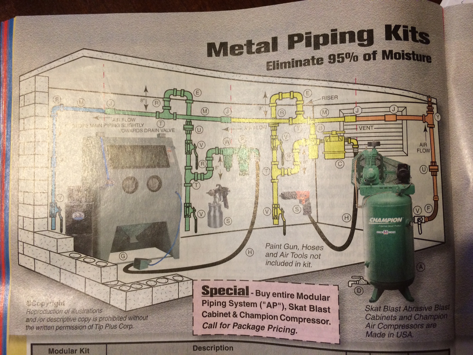

Now, I see in the TPtools (tptools.com) catalog that they are selling the RapidAir kit on page 46, but on p.49 there are two pages devoted to metal piping kits with the heading 'METAL PIPING - minimize moisture in your air lines and add years to the life of your air tools".
So...which is better? I took a snapshot of the TPtools catalog pages so that those interested can read the blurb.
Thoughts?

A filter and regulator at every tap will keep crud out of your air tools. For grinders, sanders and such I also use an in-line automatic oiler on a 3' pigtail off of the tool. Of course, a line dryer, filter and regulator are absolutely mandatory for any spray gun. I don't think plastic lines are going to get you away from that.
   / RapidAir Maxline 3/4" or Black Iron Pipe for shop air plumbing? #3
... copper ...
   / RapidAir Maxline 3/4" or Black Iron Pipe for shop air plumbing? #5
I would go with the black pipe.
As for the water problem. Draining tank daily should be first on your list.
Then instead of the separator try a dryer. Seen a commercial shop salvage two dryers off a couple tractor trailers and hook them to batteries and an auto charger. They said they no longer had water in their air lines.
Last add a filter at each drop.
