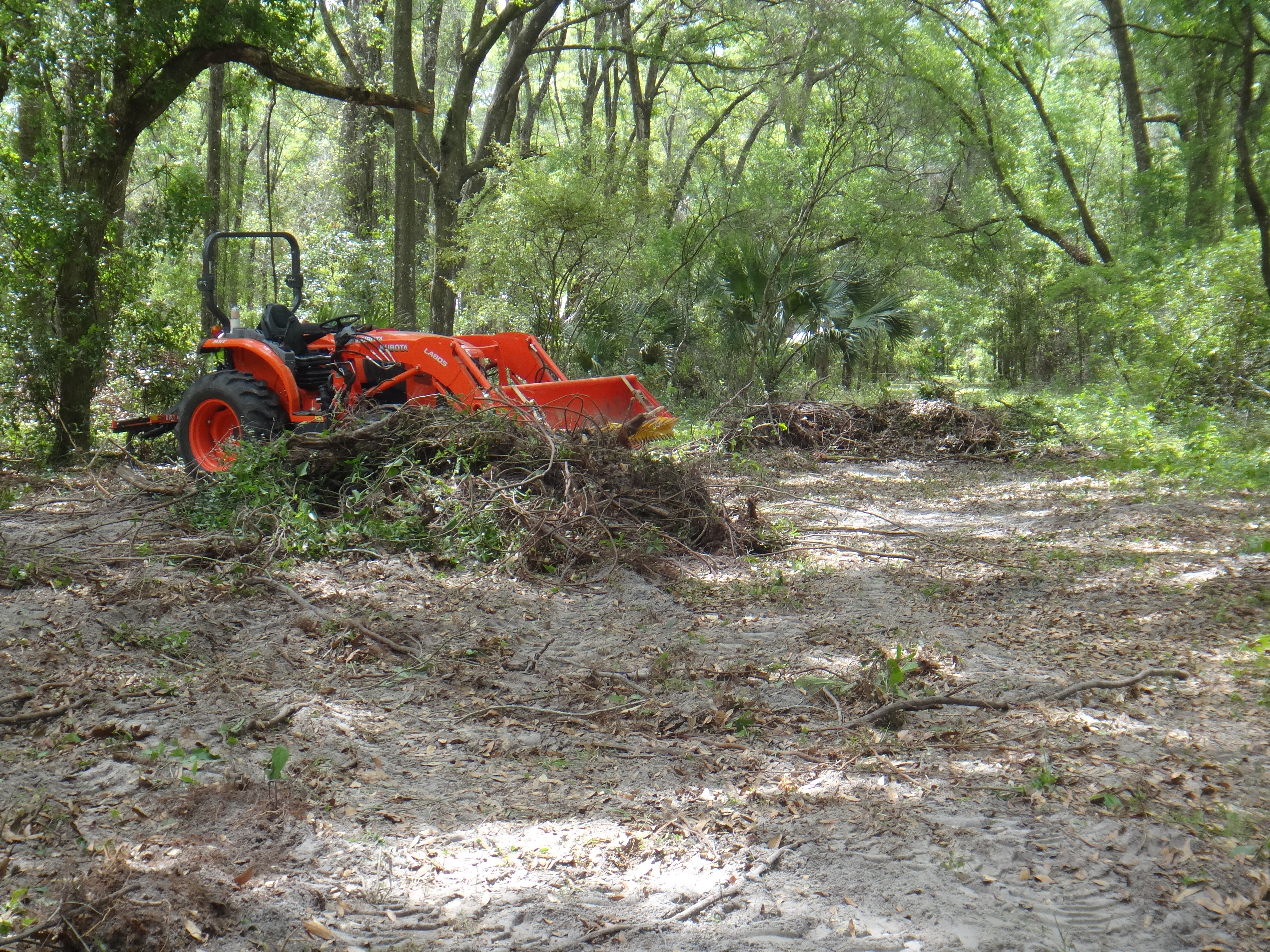

   / Ratchet rake for small privet removal? #2

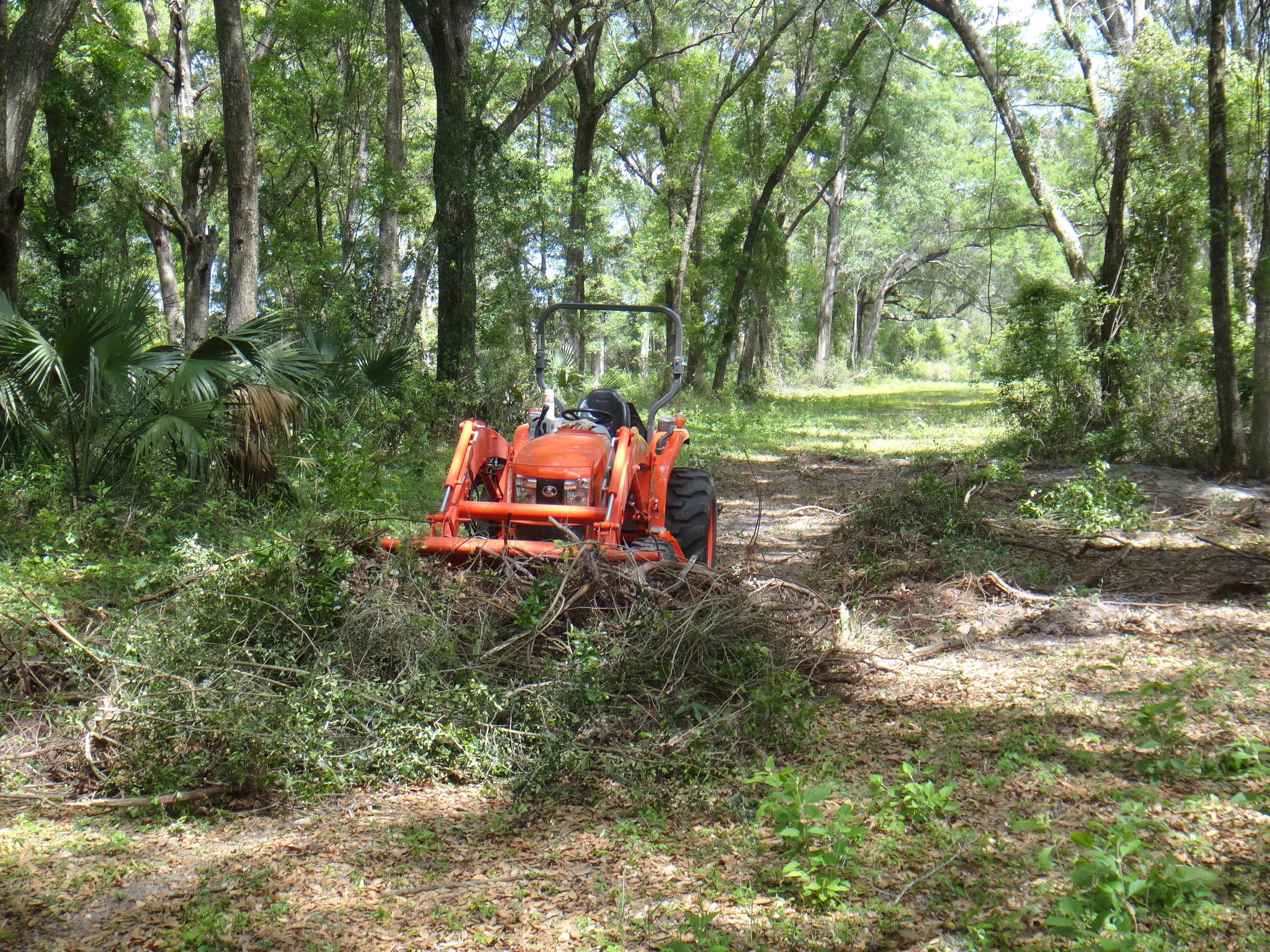

I do not have Privet in Florida.
I have Yaupon Holly, about the same size when immature, between Oaks.
Ratchet Rake will tear similar spreading stuff out by the roots, but if Privet spreads via roots, some residual bits will sprout in the soil needing later minor spot herbicide application to kill 100%.
So, if the RR will pull out 95% of the plant, that still not is enough to eradicate root spreading plants without some herbicide spot application.
Readily available 2, 4-D based herbicide is probably what you need to complete Privet kill, rather than Roundup/Glycophosphate.
I have had good success with Gordon's BRUSH KILLER from Tractor Supply Company, which only requires 2-1/2 tablespoons of concentrate in a gallon sprayer, so a half gallon of concentrate lasts a long time.
Ratchet Rake is also excellent at collecting and piling brush, much superior to a Landscape Rake for this task.
