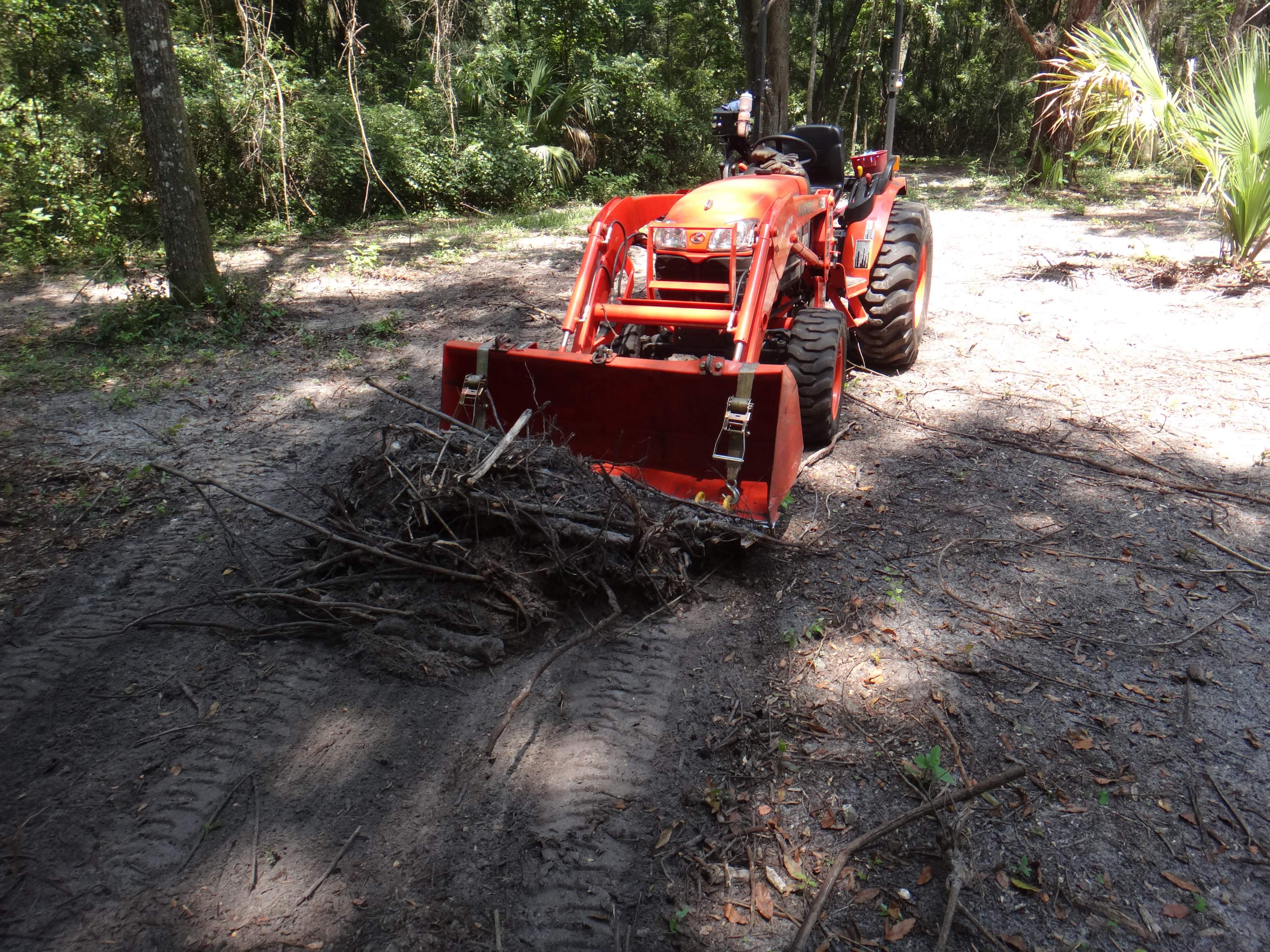

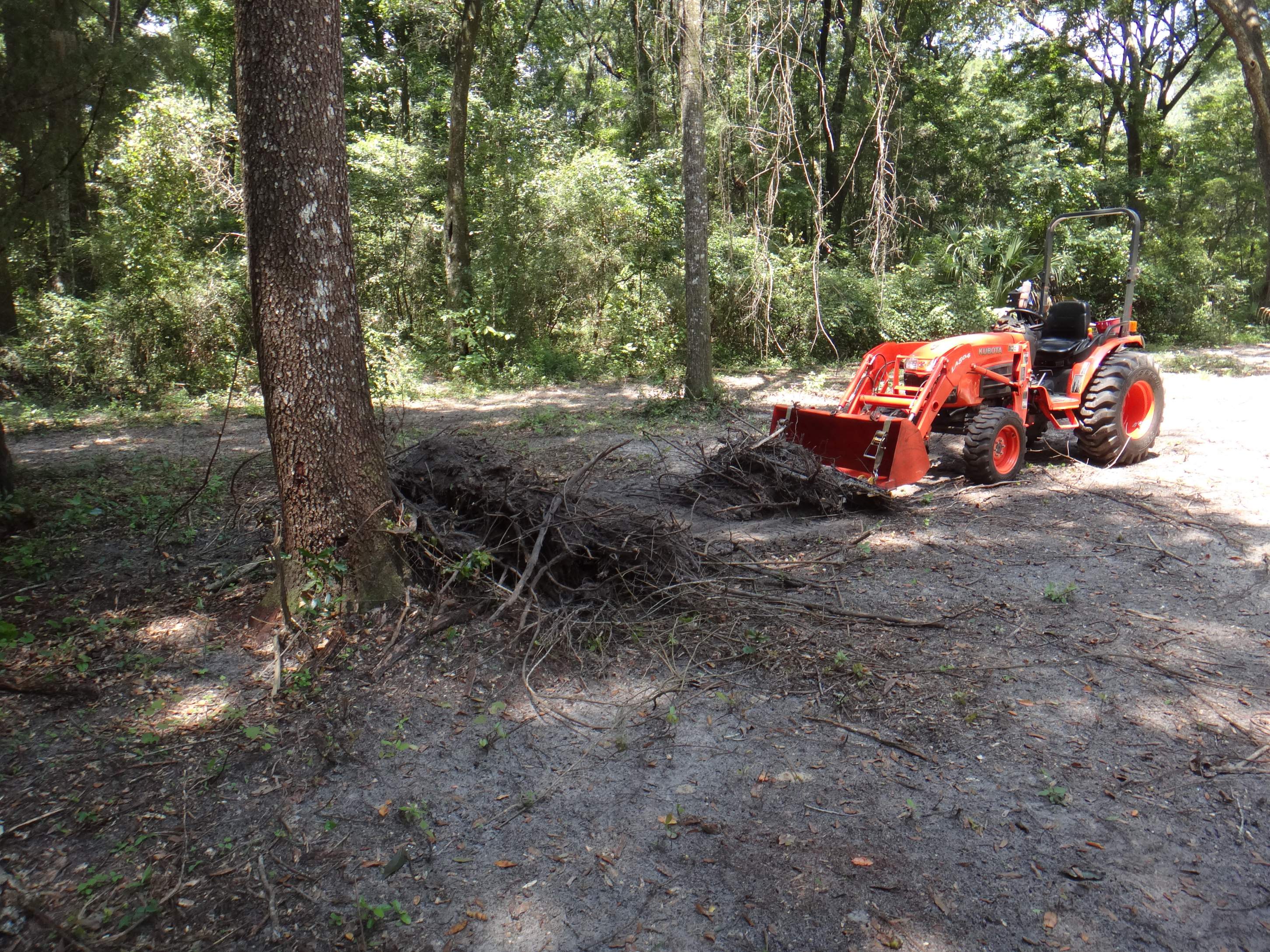

Ratchet Rake is very useful bucket enhancement for $299/52".
Pulled Vitus rotundfolia grape vines out of the ground and out of Oak trees with Ratchet Rake on the bucket and tractor in reverse.
Then piled roots against tree trunks, sometimes pulling with Ratchet Rake, sometimes pushing with Ratchet Rake.
To decrease dirt component I "nose" the roots over several times with the Ratchet Rake.
Piles will be transported to burn pile when half dry using Payne's Clamp-On Aluminum Debris Forks/Photo #8.

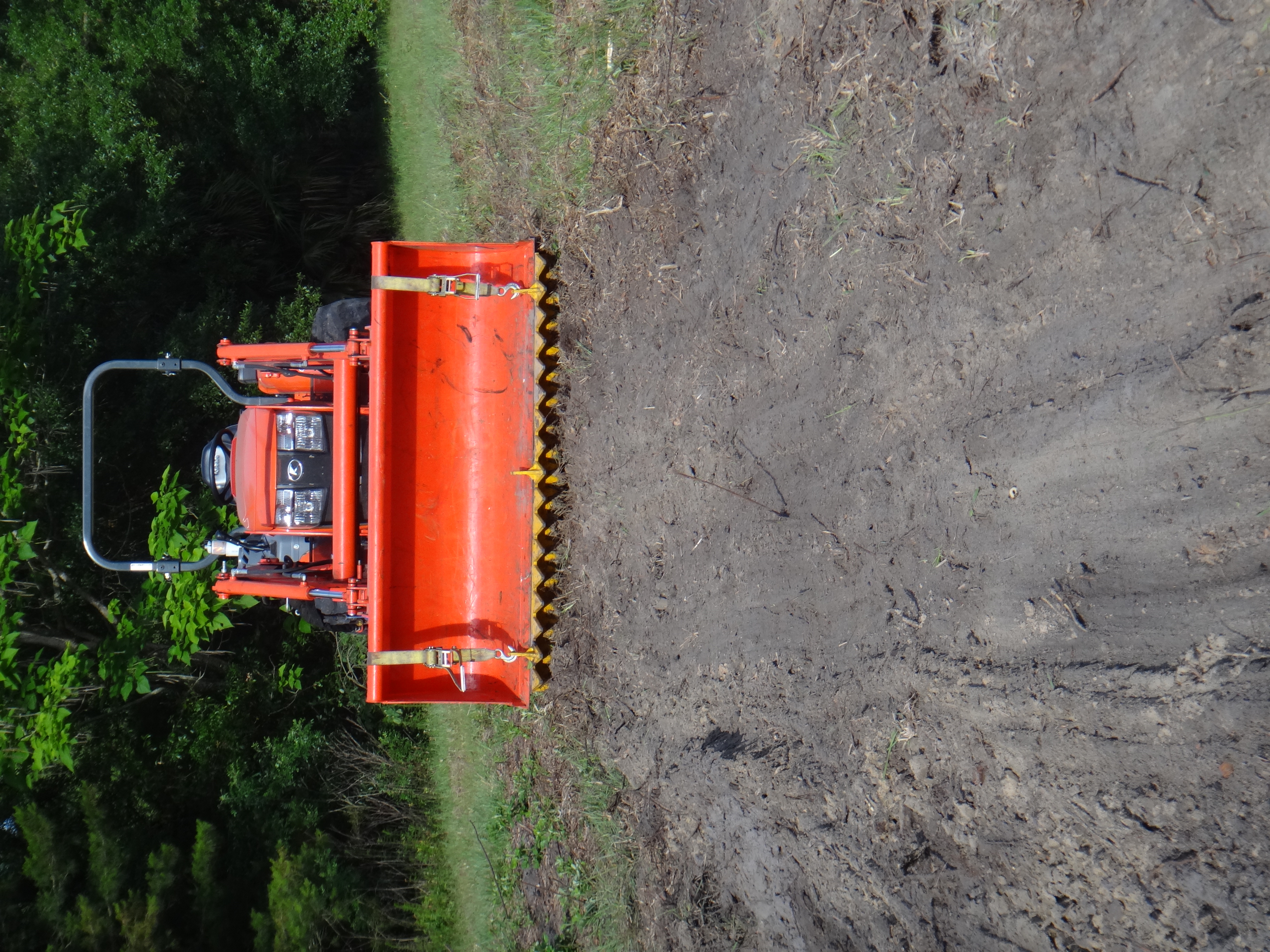

I smoothed a field for a friend today. Ratchet Rake on the bucket, Bush Hog (brand) Rollover Box Blade on the Three Point Hitch.
For swells 18" to 24" high, I used the Box Blade rippers to cut through the Bahia grass and initiate grass + dirt move. Followed by the Box Blade cutting edge to collect and transport larger volume ( 5 X ) of exposed dirt to depressions.
For minor swells around 6" high, I back-dragged with the Ratchet Rake. The lower, vertical teeth cut through the Bahia and pulled 2-1/2" of soil to low spots with each chomp, with the tractor moving in reverse. Worked very well.
Soil moisture was optimum.
After a couple good rains to settle the dirt, I will go over the entire field with my ETA Landscape Rake with gauge wheels, to make the field perfect.
Here are three photos I took today. Sorry for #3. It opens 'portrait' oriented.
