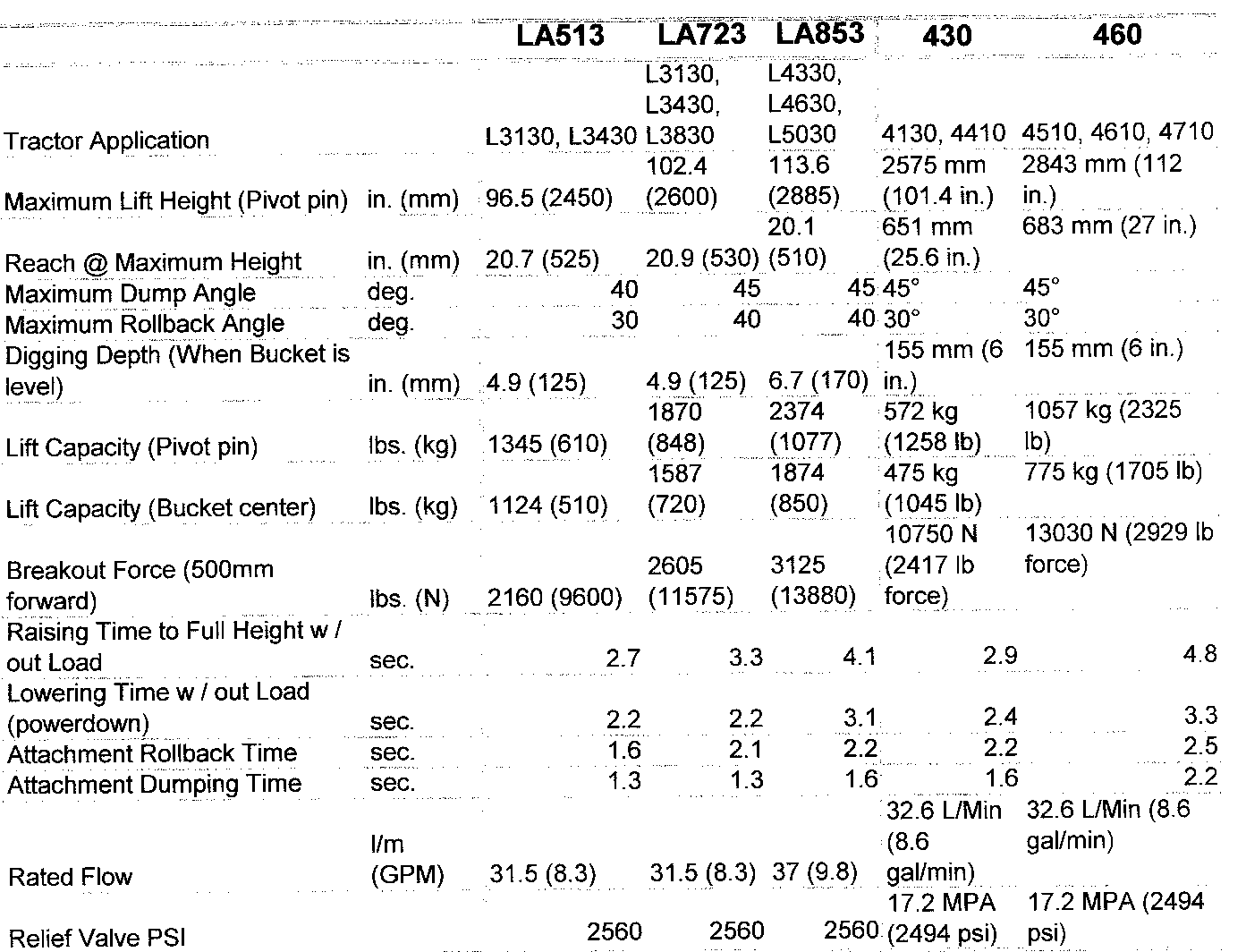

OK, I was reading through my manuals, and I began to wonder just how much differance IS ther between some of our favorite brands.
I bult a table, using data from Kubota's web site, and the John Deere 430/460 owner's manual. I copied and pasted data, so the Kubota figures are English/metric; while the Deere is metric/English.
What about New Holland, Kioti or (insert your brand here)? Well, maybe I'll do them, but this was enough work, for now...

Hey Rockyridge, thats a lot of work. I have some figures from the JD "Governmental Bid Specification Booklet" as well as the JD "The Tractor Redefined" brochure. Both concour that the bucket rollback is only 23 degrees. That figure is important to me because with the bucket on the ground, fully rolled back, you can fill the bucket by hand almost completely when rolled back to 40 or more degrees. Typical when loading rocks, debris etc. I do not have breakout force at the pivot for Kubota. The lift is perhaps the greatest difference when comparing the LA 723 to the 430. At the pivot, the LA723 is 1870lb vs 1261lbs for the 430. Loader times were similar as were lift heights and bucket dump with the LA 723 having a slight advantage each time. I use to have the loader weights somewhere and that had pronounced differences. Memory recalls it being about 850lbs for the 430 and 1200lbs for the LA 723 all things being equal such as bucket and attachment points. Anyway, it's a great way to get the info out. The 430 is a fine, well built loader, I think it just needs a little facelift to go with the great tractors it sits on. My local JD/Kubota dealer has the 2 loaders, its a great way to look at the build differences. Rat...

I ended up finding the 430 met my needs very well, course I started with a 7308... /forums/images/graemlins/shocked.gif The blue dealers didn't think that even a 16LA would work, and wanted me to look at the 32LA. It seems that the axles were the limiting factor. Now, I like the TN75, especially the cool front fenders, but my piggy bank gave out /forums/images/graemlins/frown.gif
I want to be able to handle small round bales, something that the 430 manual covers in depth. My current round bale handler is pretty tired of hauling those around, and it wears out gloves... /forums/images/graemlins/wink.gif
