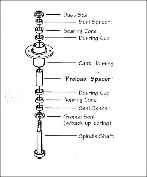

I have not worked on RCK54-22BX and do not have one of those, however I have Kubota F3060 with a RC72R-F30 deck.
It has spindle housings where the lower seal is spring loaded and the lip is pointing up in order to keep grease from escaping out the bottom. The upper seal has no spring (they call it a dust seal, but it looks just like a regular shaft seal without a spring) and the lip is also pointing up in order to allow old used grease to exit.
Not sure if the design relies on gravity in taking new lubrication to the lower bearing but in any case it is working great.
The Kubota spindle rebuild kit instructions are very specific on which way to install these seals.

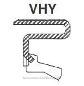

Upper VHY seal lets the grease out: VHY Seal - Lets the Grease Out!.jpg

My whole point above was to explain how these spindles were designed so that the grease escapes from the top and that way both bearings get lubrication.
It will not work as designed if the spindle rebuilder installs the shaft seals with the lips pointing in the wrong direction.
Bearing lifetime will suffer and a seal will be pushed out when you pump in more grease.

The upper seal has a limiting depth flange - one way, one depth only.
The bottom seal is unflanged, and will set either way at various depths, at least until shaft tightened.
I put it in rubber in, metal out.
