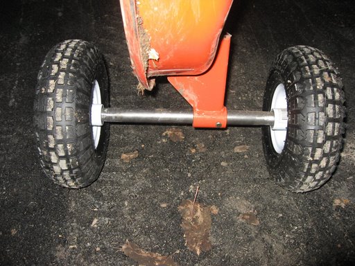

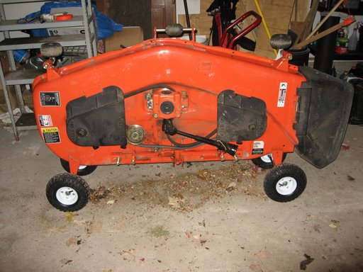

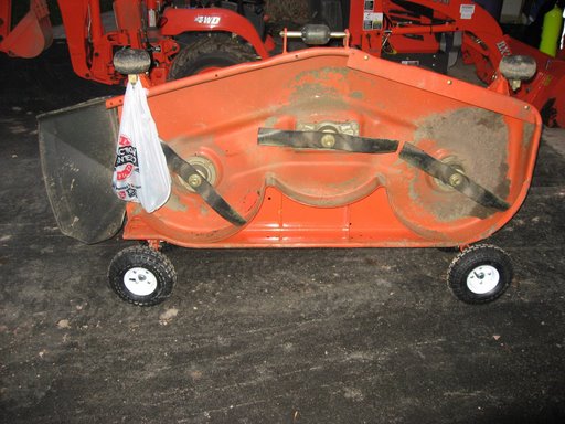

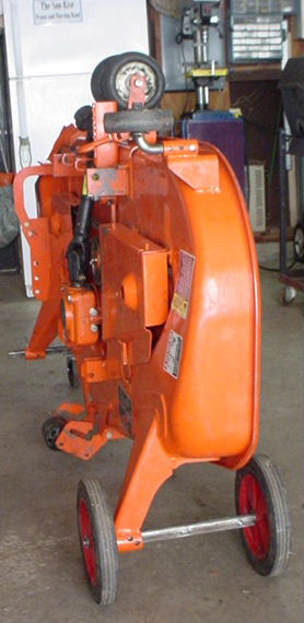

Hello all,
I was wondering if anyone out there in Tractor Land has built, bought, seen or has a picture of a stand for the RCK60-24B mower? I am trying to get it off of my garage floor for the winter and have a perfect spot on the floor by a wall just waiting for it to be stood up on a stand and set in place.
So, does anyone have any words (or pictures) of wisdom to share regarding this?

I have thought of a design, similar to the ones presented here at TBN, which uses the front gauge wheels on one end for easier turning with my RCK60-30B.

Richard,
The last one was exactly what I was looking for. Thank you. I ran a search and found that the user 'bigdad' was who those pictures came from. I have already sent him a PM inquiring for some more details.

ovrszd said:
Here's a link to a discussion about the same thing. http://www.tractorbynet.com/forums/kubota-owning-operating/90190-bx24-mmm-stand-home-made.html
Also am attaching some pictures I have gathered from this website. All depends on your skills. Can also buy a kit but I think it's around $80. Good Luck.
