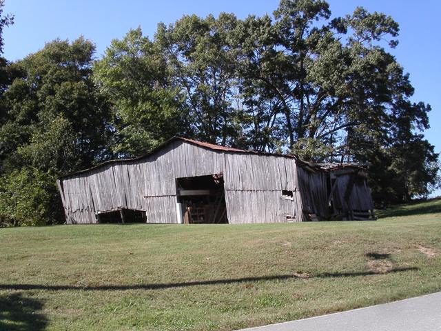

My neighbor has offerred to "give" me this pole barn, made with "real" poles throughout, mostly cedar and locust. It contains very little milled lumber. This was hand built in about the 1940s as a tobacco drying barn. All I have to do is to get it down and move it!
   / Real "pole" barn #8
Re: Real \"pole\" barn
Even if you figured your time at $minimum wage you'd be better off to buy new materials than to try and salvage that. /forums/images/graemlins/tongue.gif
