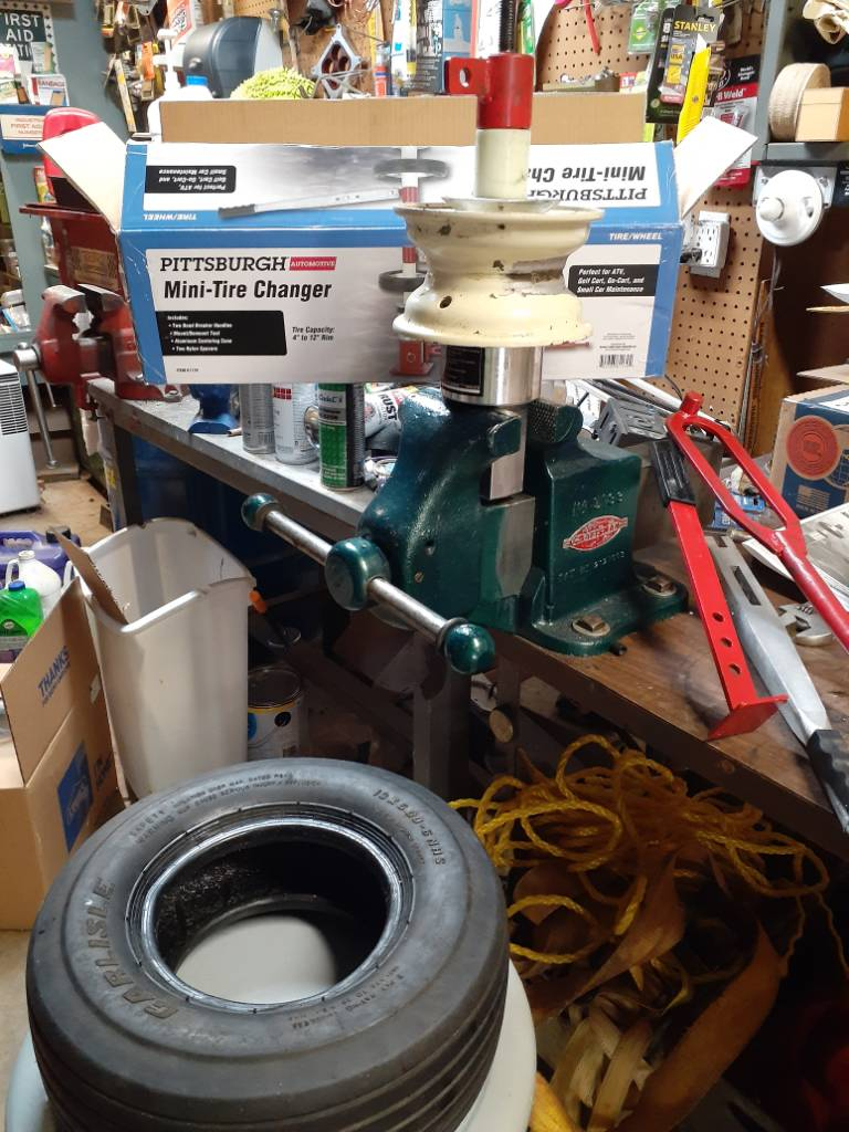

I had a flat on my Cub RZT50 on the front and thought here I go again, fighting with it for hours. The last small tire I took to a shop and they had a tool similar to this one from Harbor Freight. Instead of using the base you mount to the workbench I clamped it in a vice. I used a little dish detergent on tire rim.
It worked so easy I took tire on & off a few times. For $46 to me it's well worth the no hassle.

Last small lawn tractor tire I changed I just clamped the hub of the wheel in the vise, soaped both beads, started the bead, placed vise grips on the bead of the wheel, and spun the tire on. After doing the bottom I pushed the top bead on and repeated. Worked like a charm.

I tried changing one of the small tires without the specialty tools. Finally gave up and bought the Harbor Freight changer. Made it so much easier!!! I also clamped mine in a vise instead of using the bench top bracket. Worked fine until I got part way around and the torque on the bar caused the whole assembly to slip in the vise. I'm going to make a place for the bench mount 'cause it'll be even easier.
