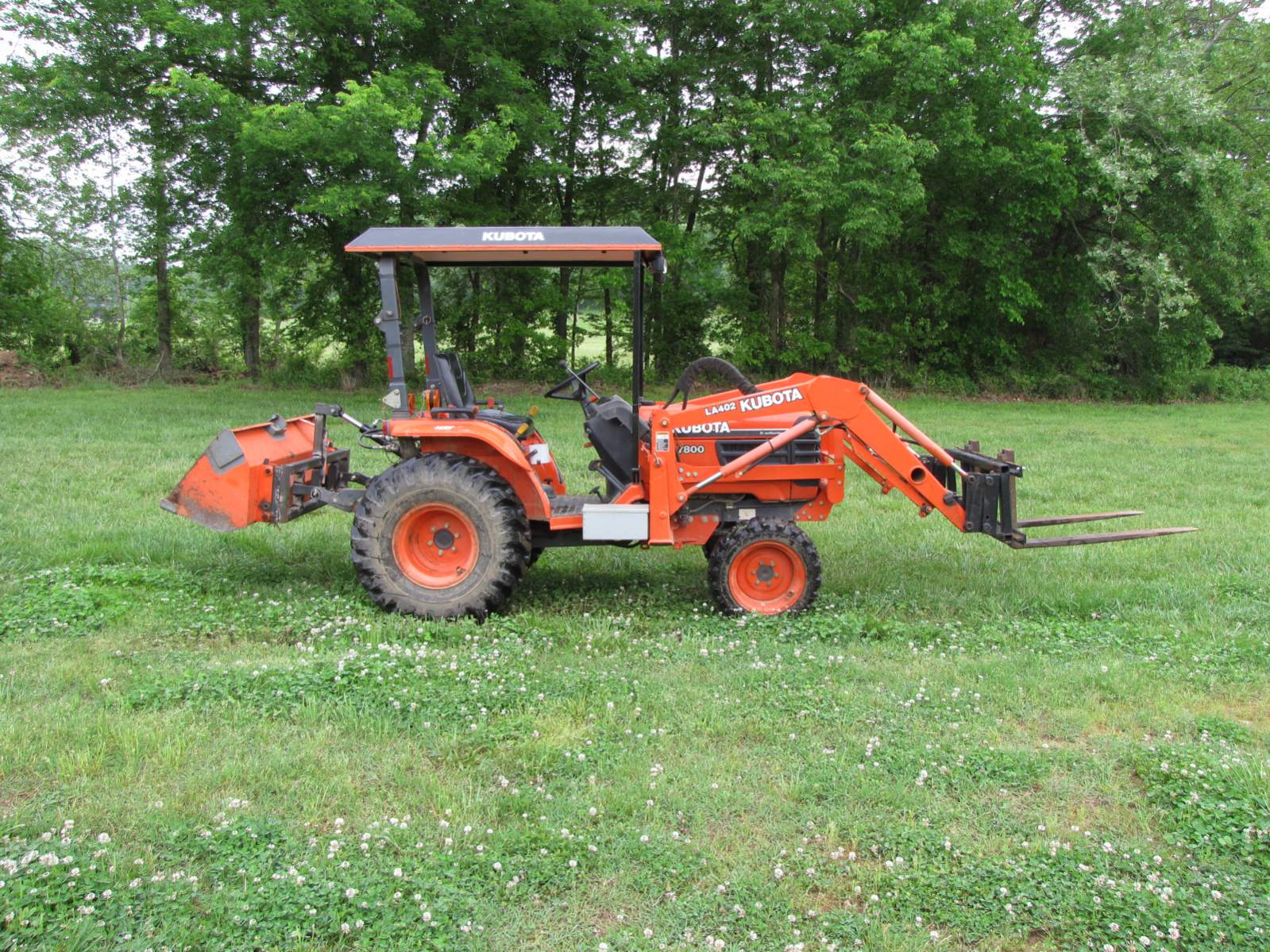

Found a Yanmar with this rear 3pt FEL. Maybe it's a REL. :confused2:
Looks neat to have when you really need it and disconnect when not needing it. ;) Anything like that over here in the USA?
?????????? JRB ????141cm | Antei
It would help with wood-chips, manure, gravel and such.
   / Rear 3pt FEL, where can I get one like this #2
Like this? I dump with the hyd top link.
   / Rear 3pt FEL, where can I get one like this #4
That looks like it works like my dirt scoop, except it is larger. My dirt scoop is about all my Iseki TU150 will handle. Also it doesn't lift very high but would certainly be better than nothing. Be very careful when using something while backing it puts a lot of strain on your lift arms.
   / Rear 3pt FEL, where can I get one like this #5
I used a dirt scoop for 5 years before building my FEL. Very handy for simply scooping and moving material. I still use it when I'm moving dirt or gravel any distance. It makes a good counter weight when full of heavy material and it allows me to move that much more every trip. I see them on Craigslist regularly for $100- $150. The main issue is lift height and controlled dump w/o Aux hydraulics. Not nearly as handy as a FEL but it is the next best thing if you want to be able to transport material with your tractor and not spend a lot of money. It's also a lot easier to remove and store than a FEL.
