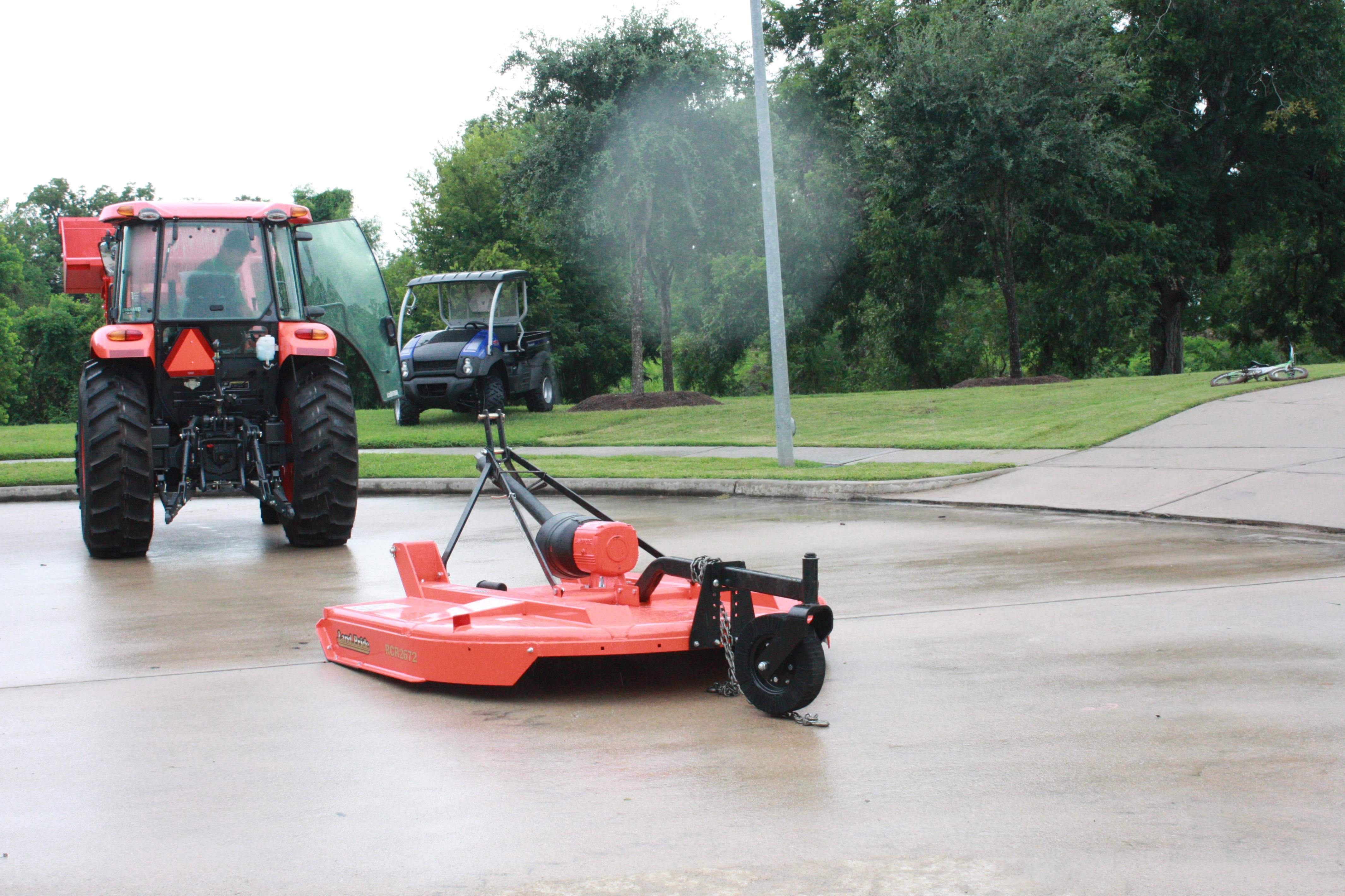

The M8540/9540 spec says 59.8" - 75.6". So 3.6" less on the widest setting. The other thing I figured out is the spec is center tread to center tread.

Pic of M7040 with rear space set one setting in from widest.
Looks like it would be a little tippy to me...
