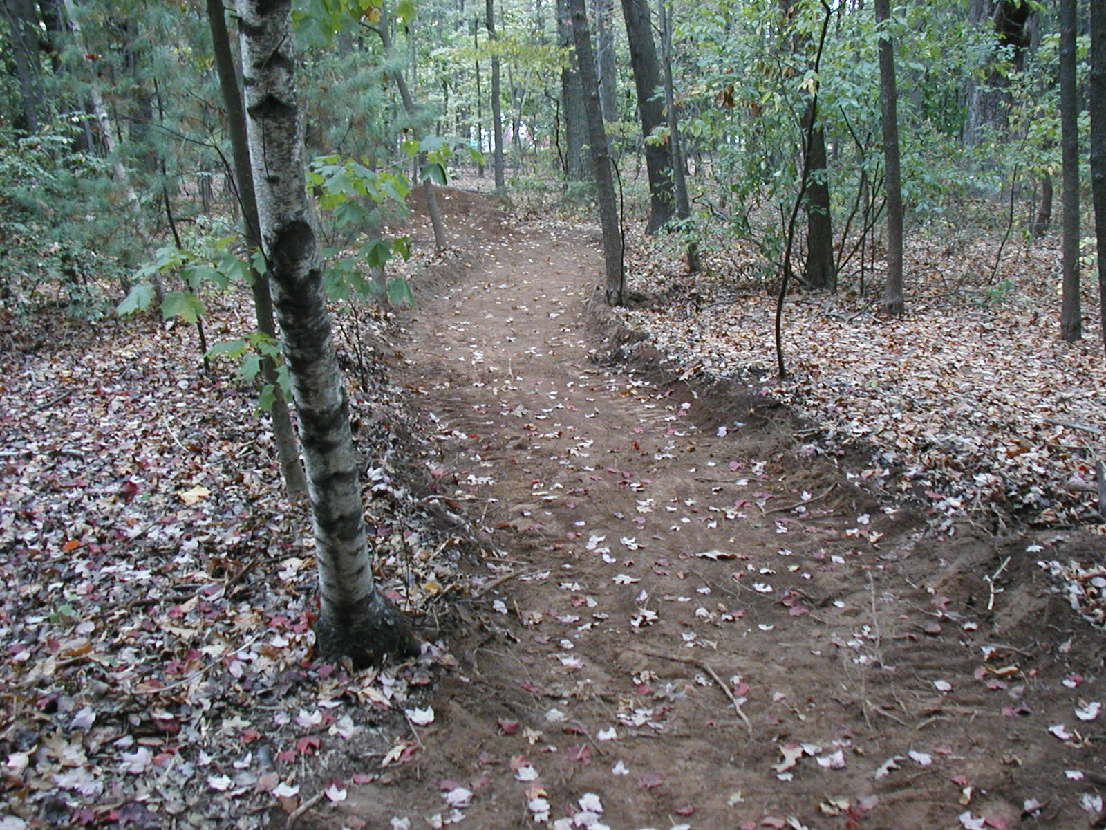

I find I use my box for more for dirt/gravel work and only use my rear blade for snow, so if your happy with the blower, I would say you would be ok without the rear blade. tried the RB in the dirt trying to make a drain swale and just made a big mess, then I put the box on and fixed everything.

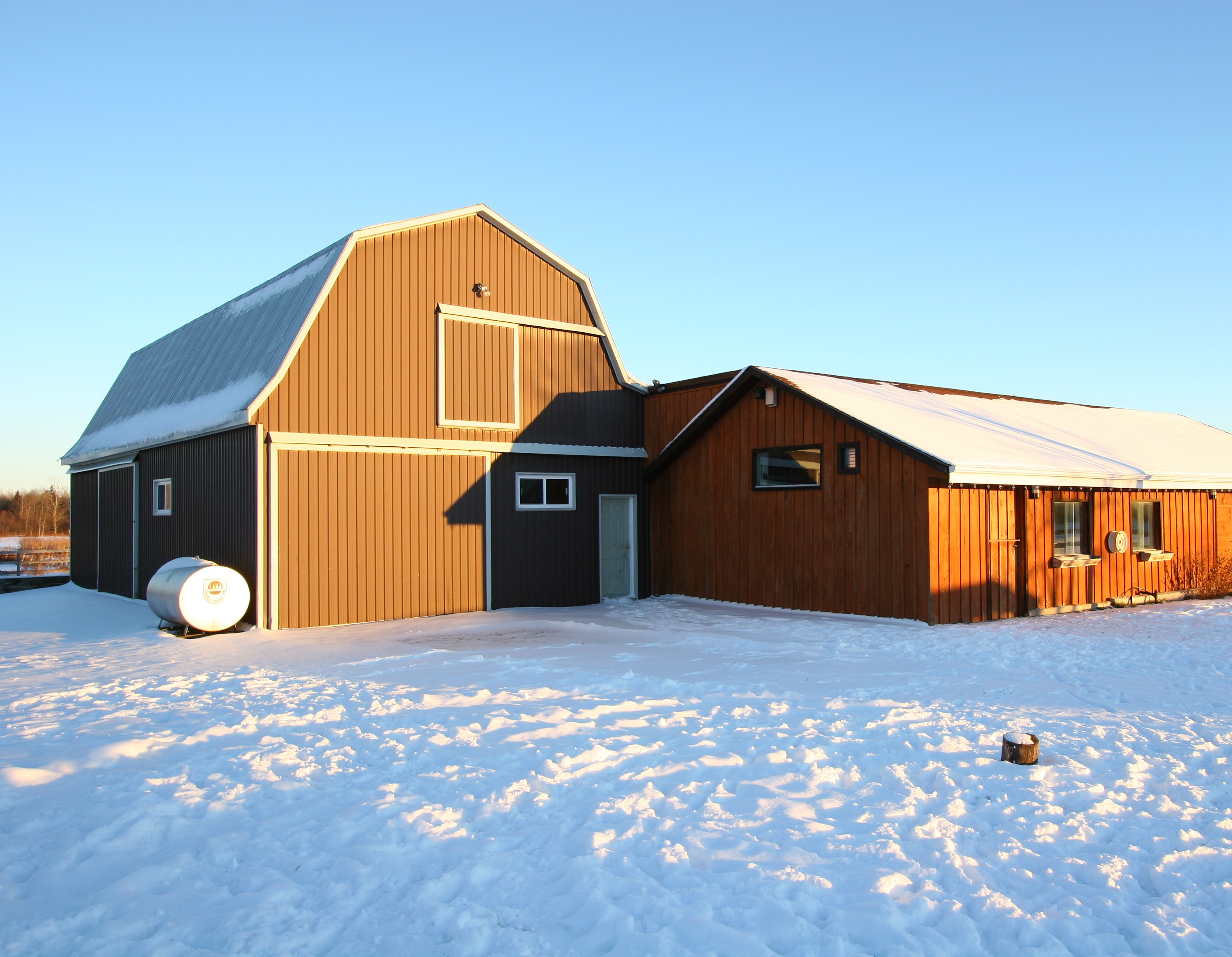

davitk said:
The real question is, canoetrpr, where the heck do you keep all your stuff??!!
David - the brown building on the left is my workshop. Not a bad size for a guy who is not even handy!. I store my tractor and all my implements there. The chain harrow is stored outside.
