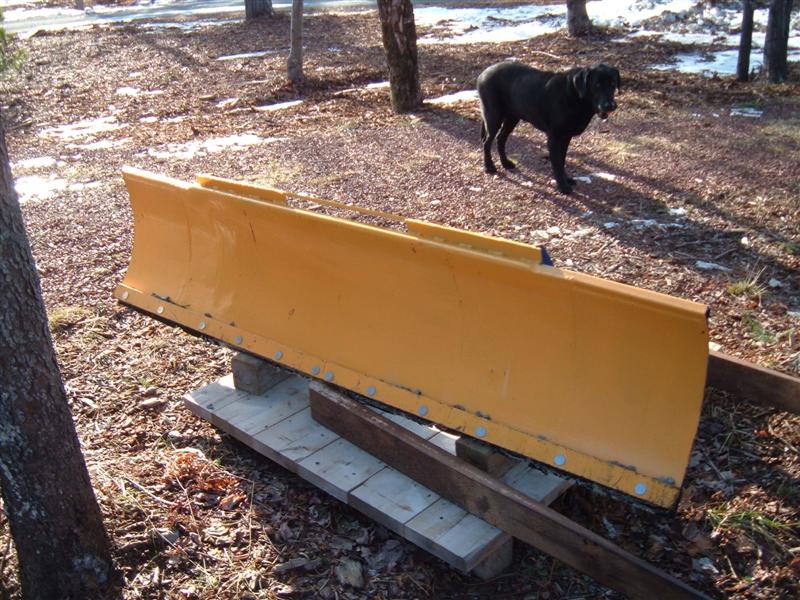

I used 3/8" and 1/2" conveyor belt for several years on my original blade. Depending on how abrasive the surface is dictates how long it will last. I never noticed any marks on my concrete pad in the spring. Can't see it very well but this was 3/8" at that time and it was getting pretty ragged. I tried leaving about an inch once and it folded over and wore off in no time. I tried a piece of straight one inch thick rubber once and it also wore off very fast. I found the conveyor belt to be about the toughest thing I could find, I had a source of old conveyor belts from my work place.

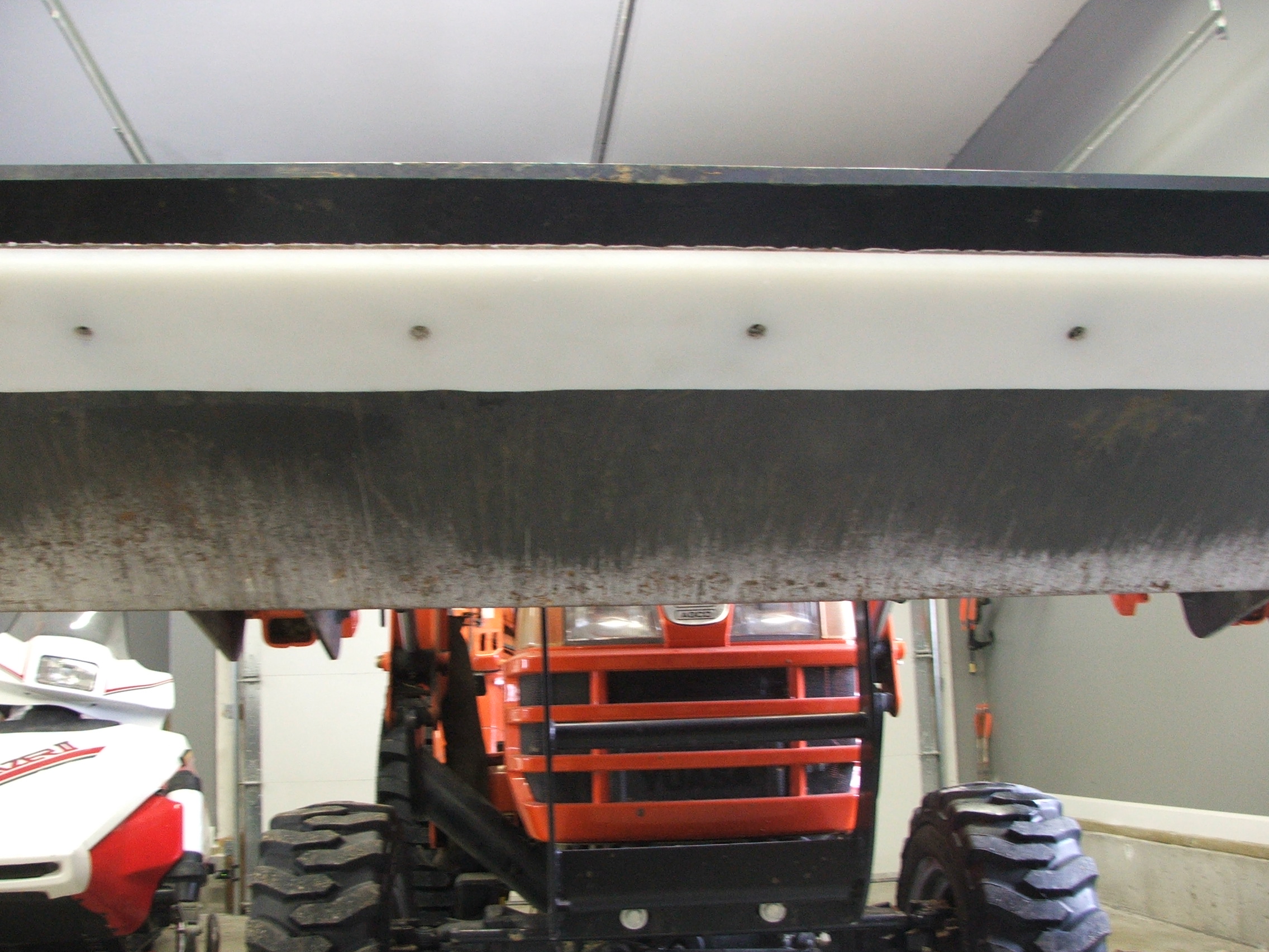

You need a piece of UHMW polyethlene
it will take a lot to wear it out, it is not the cheapest thing but should last a long time
you can get it from mcmaster-carr or any industrial supply
i tapped the bottom edge of my bucket and attached a piece and it glides over anything
that is exactly what i had in mind , this or a piece of teflon
