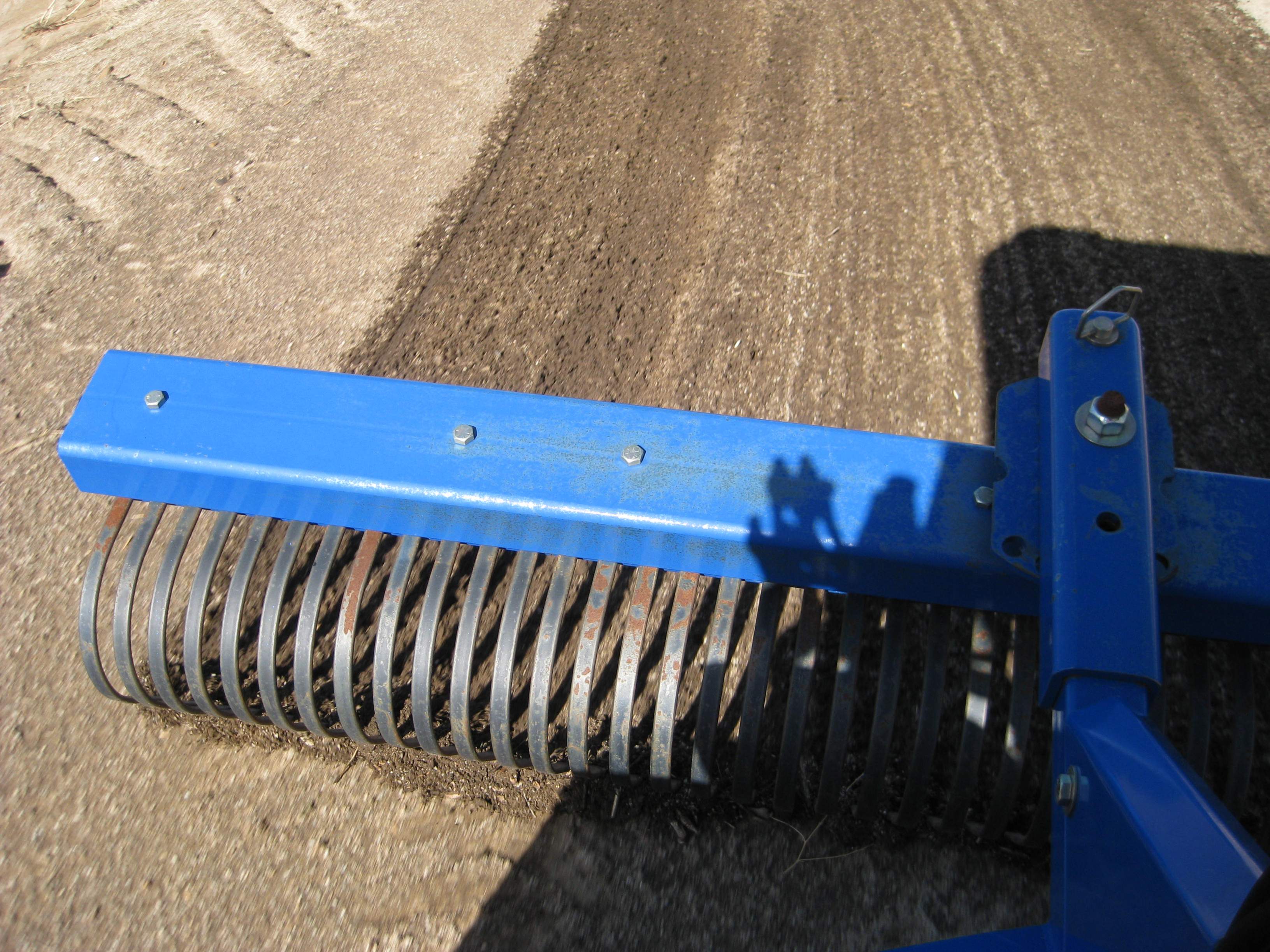

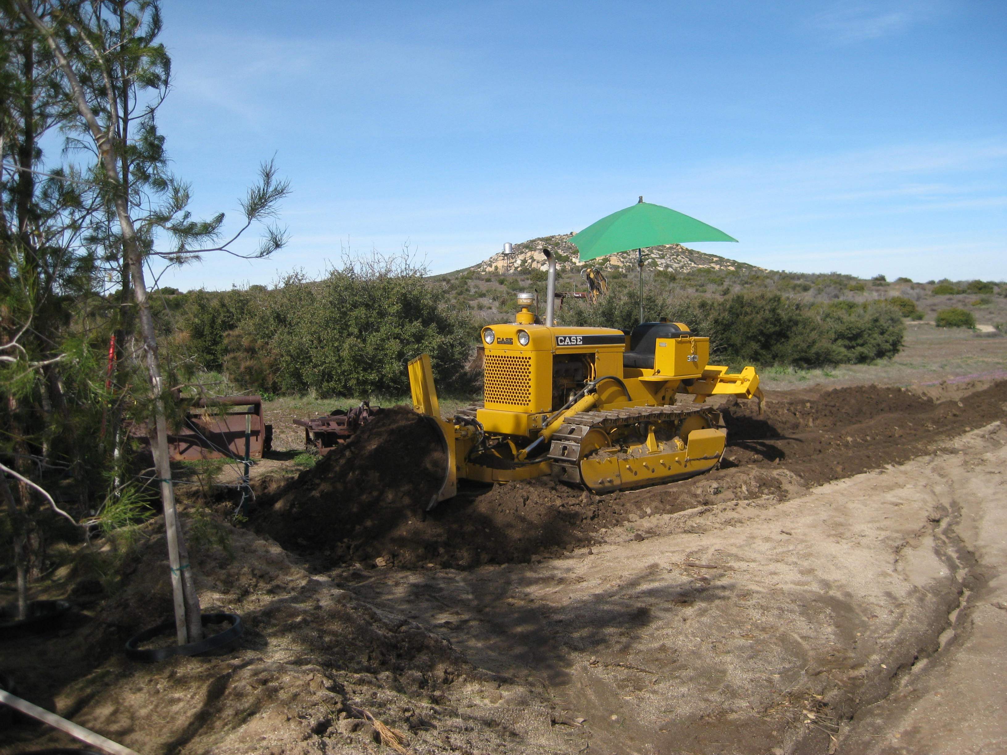

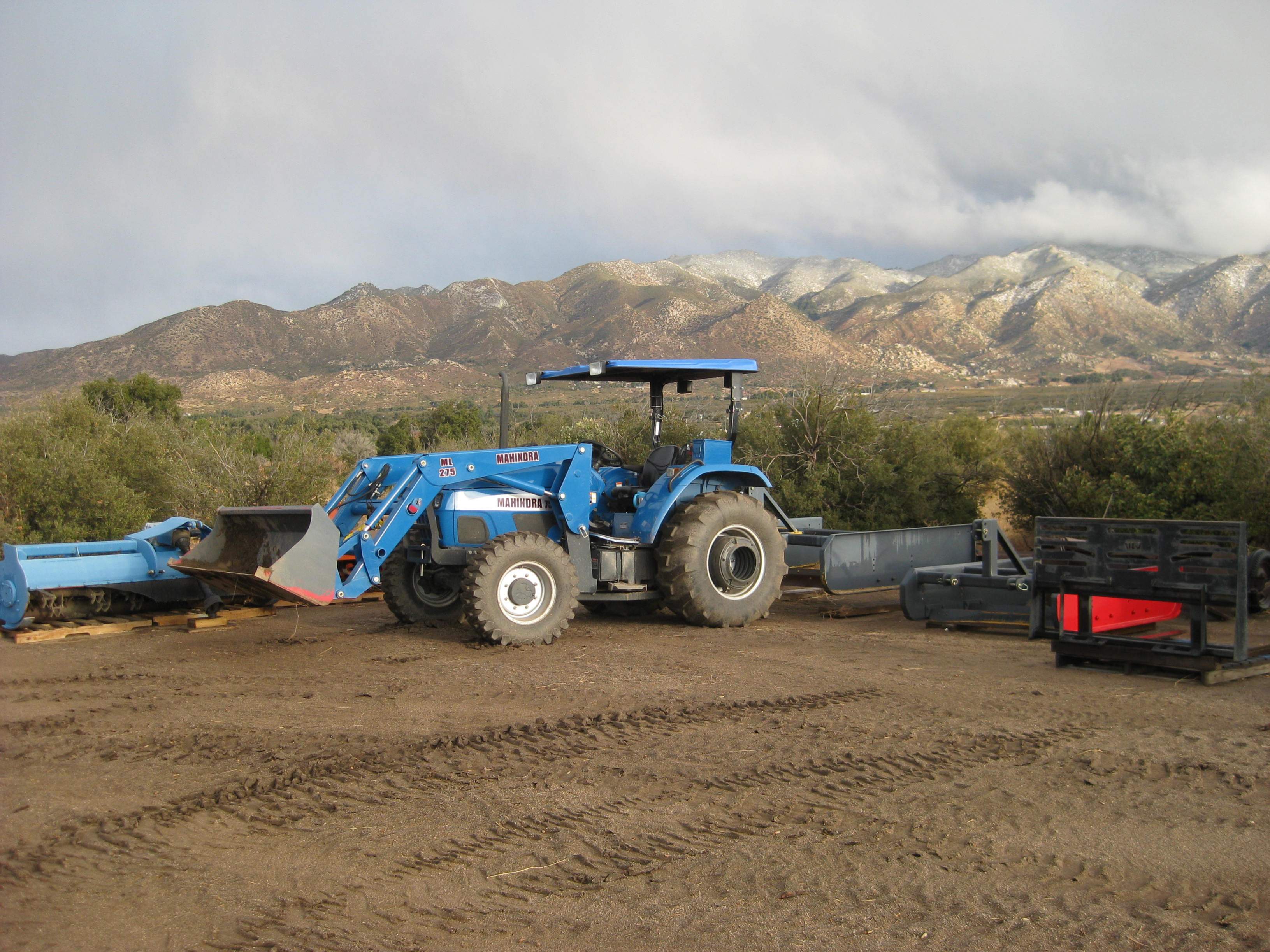

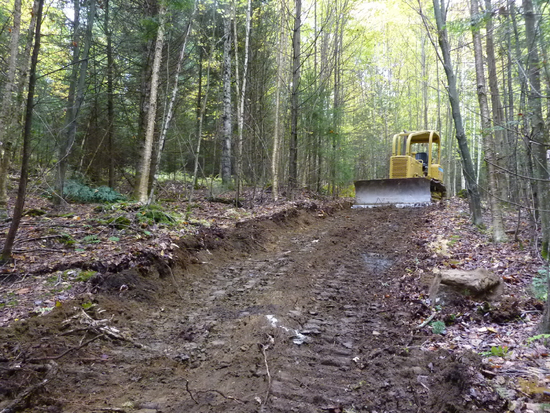

I have a 1000lb roll over box blade (ROBB), my rear blade weighs about 1200lbs. It is very common to have rear blades weigh less than box blades, but it does not have to be that way. The dirt just spills over with ALL of my implements. So in the end I suppose it really comes down to what the capabilities of the operator, the implements and the machine working those implements is.
All I can say to the OP is that I have a ROBB, a rear blade, a land plane grading scraper (LPGS) and a landscape rake. All true heavy duty implements. When I start a new road, I use my dozer. :laughing: But if I didn't have the dozer, I would use my rear blade for the initial grading and shaping of the road. I would then use my ROBB if material needed to be cut out (high spot) or filled in (low spot) Once that was done, I would use the LPGS to get the road dialed in to where it would be smooth and even. Depending on conditions if the landscape rake would be used at all in the initial build.
Now understand that this is me with the circumstances that I have. This may not apply in your situation. ;)
