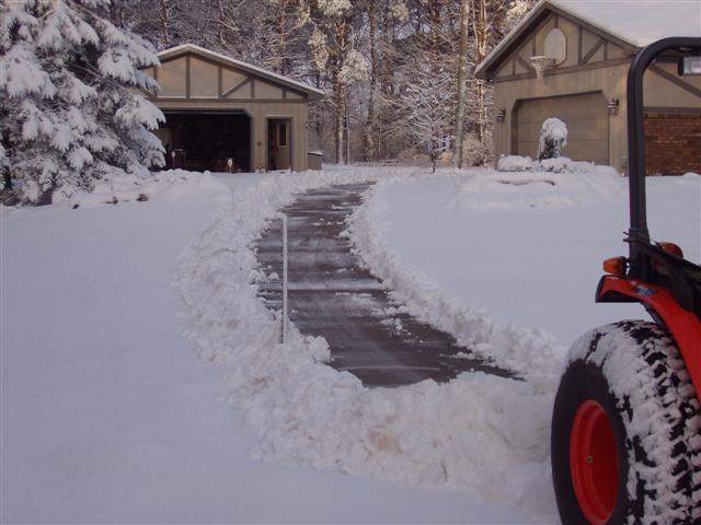

You will want a 72" blade. My B3030 is also 53" wide. I bought it with a 60" Landpride RB. When plowing snow with the blade angled the plowed snow falls back a bit and ends up inside the edge of the tires. That means that if you are plowing a driveway it will not completely move all of the snow off of the edge. Unless you drive with the wheels in the bank on the edge of the driveway the next time you plow the driveway will become narrower. A 72" solves this problem by pushing the snow out past the edge of the driveway. I traded the 60" RB back to the dealer for a 72" about halfway through the winter last year. Another thing you will want is skid shoes. I made my own but you can also get them with most any brand RB. They really help control the cut of the blade, especially on gravel. They even help save the edge of the blade when plowing on cement.
