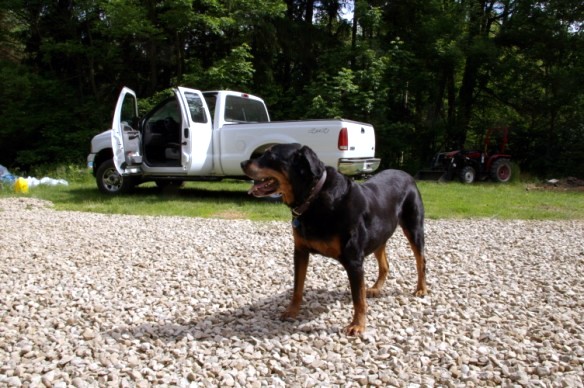

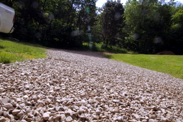

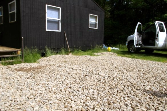

I did mine with just back dragging the FEL. Actually came out level..Keep some gravel in the bucket put it in float and let her rip..I was happy with the job but the dog wasn't.. It hurt his little feet....

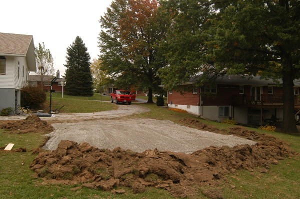

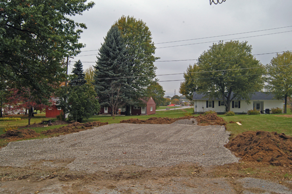

Thanks folks for all the info. I moved about 15 tons of gravel in about 1 hour using the bucket and full of rock and back dragging it. They brought the gravel in a placed it in the middle of the work area. So I just pushed it forward and out to the sides the best I could then we shot the area for level or just off level. We were only off by 1 inch from grade from one side to the other but ran out of rock. It worked out pretty good I think, I am not sure if he is going to get more rock or just poor a deeper slab where it is low. Its his garage and his choice.
Thanks again

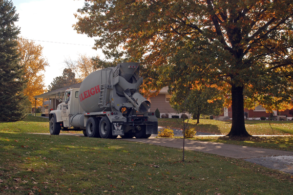

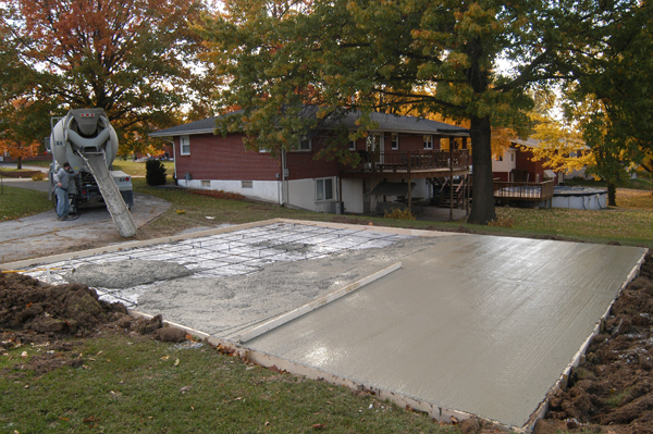

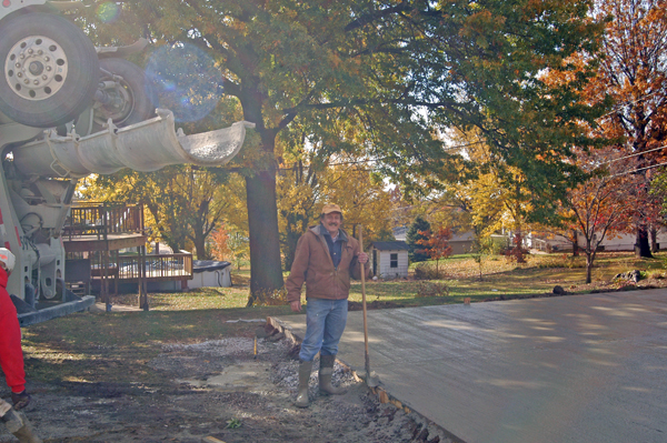

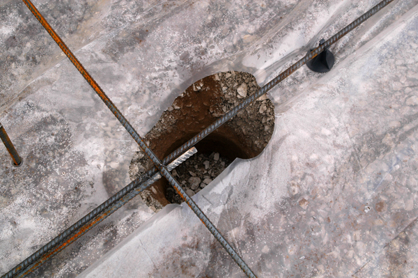

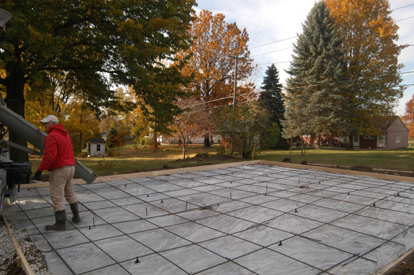

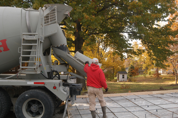

well the pad is down, it took 2 loads 1st 7 2nd the owner thought he better go for 8 yards. It turned out he was ordering way too much. At the end the truck driver asked what ya want done with the rest. We asked how much is left, he said about 5 yards was his guess. Well we had him take the rest to his brother house where we poured it out on his gravel drive.
The owner did not pour a footing, he just dug round holes 3 ft deep 18 inch wide for piers, about 4 on each of the 4 sides and two rows down the middle of a 24x30 grage. Will this work. He aslo had rebar on 2 foot sq.
What do you all think. I am along for the ride and when it comes to my garge next week he will be there.
I want to d a footing not the pier what do you thik.
thanks Roger
