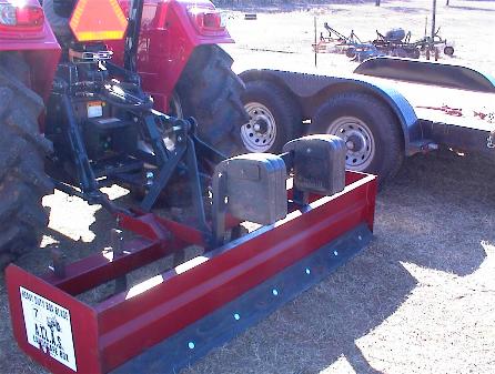

how can I add some weight to my rear blade. I am going to grade a drive around my house but I can't get a bite it just runs over the top. all help is welcomed

Do you have your toplink extended out all the way? This will make your blade more aggressive.
   / REAR BLADE WEIGHTS? #3
I use old slabs of concrete strapped to the top of it when needed.
   / REAR BLADE WEIGHTS? #4
see spencers post! and if u have it out all the way and still need weight, see if u can come up with a peice of steel, i got some tool steel from work and it is amazing how heavy a small peice of it is.
I will check on that first thing in the morning. does it give it a different pitch or is it leverage
   / REAR BLADE WEIGHTS? #6
Ezzy
It gives the cutting blade a different pitch . It's kind of like holding a razor blade 90 deg. to a surface . It'll scrape ,but wont dig in . If you angle it towards the cut (lengthen the top link ) it'll dig in . Make sense ?? John
I have it all the way out now and it is more aggressive on take off but then it lets up. Do I need to put some kind of weight on there so it digs constantly or is it just trial and error. thanx
   / REAR BLADE WEIGHTS? #8
Here's what I did, check the pic........
Chuck
   / REAR BLADE WEIGHTS? #9
Here's another pic.....
Chuck
that is a good idea I am not sure I would be able to do it like that mine is just a blade by itself but it does give me some idea as to what I might be able to do
