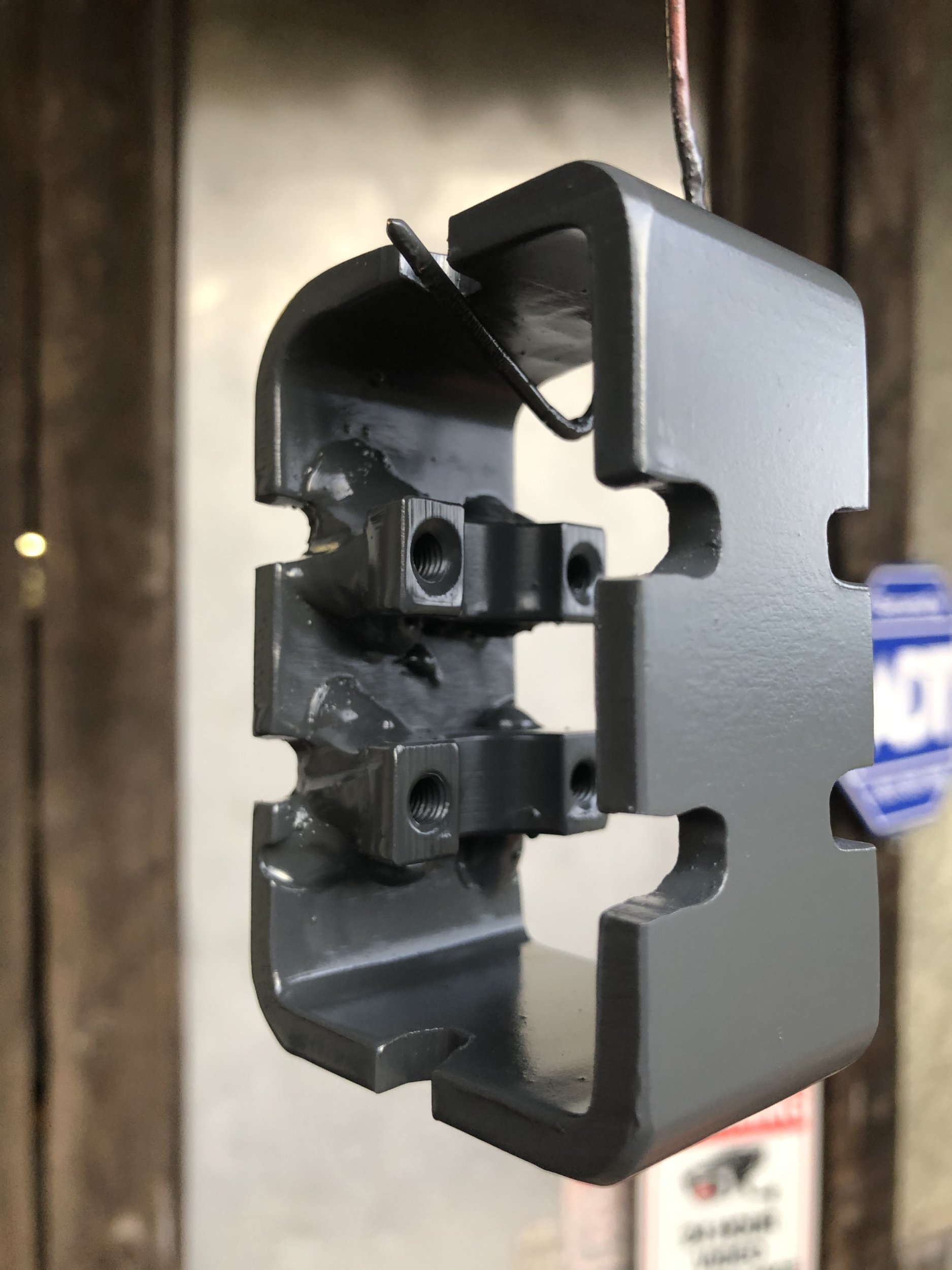

I have a new holland tc45da. I find the “left heel” pedal for locking the differential to be very inconvenient to use.
Has anyone tried to improve it? I’d really like to install a solenoid that I could control with a console button.

Many of the tractor accessories fabricators sell a square plate that fastens to the pedal to make it easier to step on. See the link. Kinda expensive, but someone handy with steel could make something similar.
/ Rear differential lock #3
Diff lock pedals are meant to be somewhat out of the way I think, as it's meant to be used fairly infrequently, not all the time. If you find that you're using it all the time, you probably need to do some terrain smoothing so you're not operating the tractor at or beyond the front axle articulation as much. The only time I need to stomp on mine is when I've crossed it up completely and it's just spinning opposites, like when crossing a ditch at an angle. Otherwise, 4wd is pretty much the answer, as ground contact pressure stays pretty constant until the front axle is maxed out one way or the other...
Mine already has a plate like shown above welded to it, so that might be a good plan if it's just too small to get a good boot on...

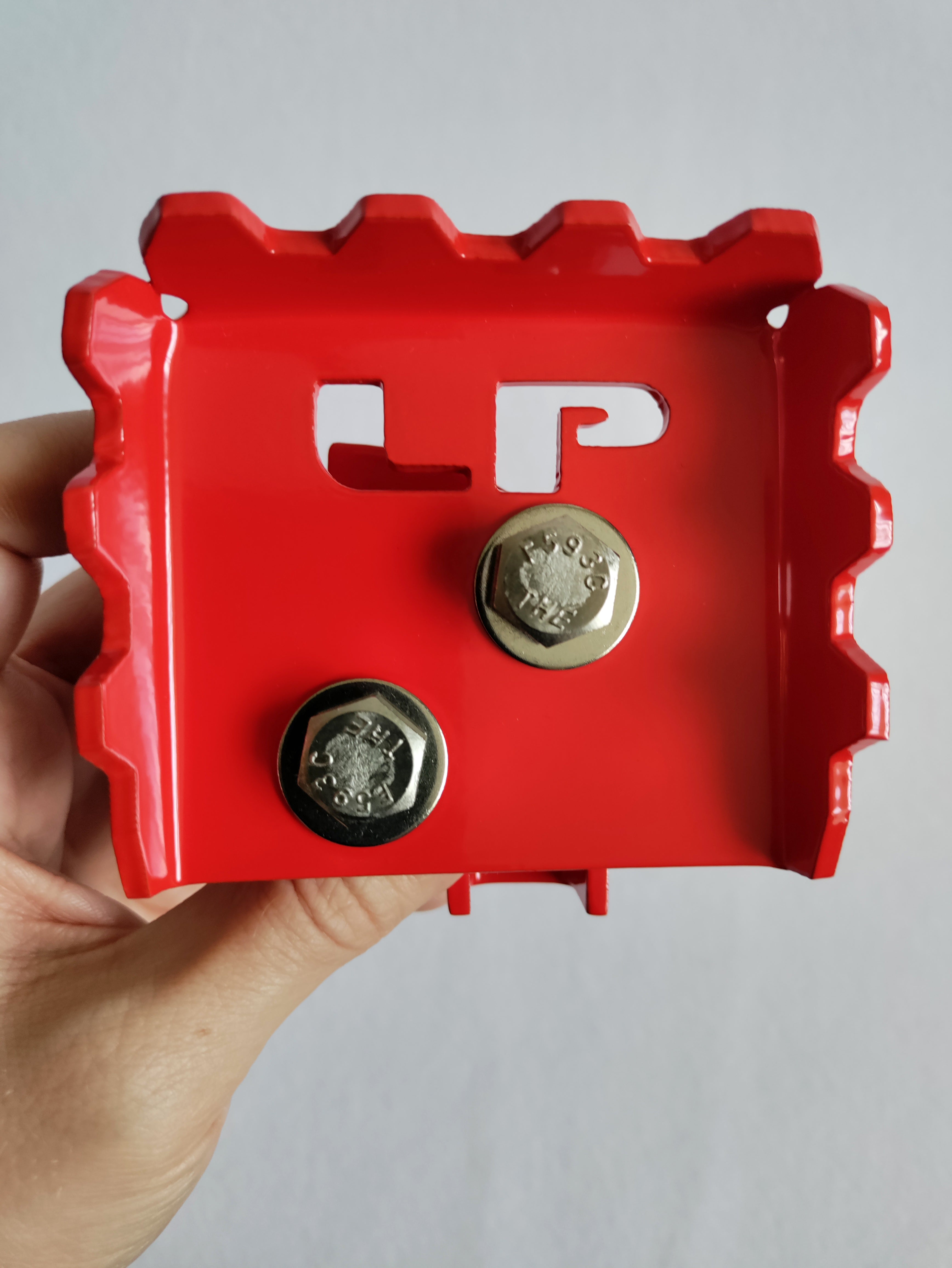

I put a pedal extension from BoltOnHooks on my old Deere, and one from Specialty Repairs and Custom Mods on my Kioti. I've got giant feet and this gives me more to work with; my boots don't slip off them when it's wet or icy.
I was sold the minute I put the BOH model on my 1025R, it made such an instant difference.

Mowing our hillside farm yard needs 4wd and occasional diff lock. Wife mows and difficult to fully engage so the step helps. The smaller step on the bigger tractor helps me. Often digging has muddy boots involed and the cleated steps grip better.
/ Rear differential lock #13
This was a "$%#@^%#!" for me yesterday in fact. I pretty much only use the diff lock when things get muddy... and then my boots are muddy. By the time the diff lock engages I hear "twang" as my boot slips off of the kindergartner's pedal.

Proper use is important. Mechanical engagement. All the way engaged or off. Hard to fully engage a small round rod, high spring tension return with muddy boots. Not the most ergonomic design. Often competing with other operating functions like steering, loader control, slope, trees, rear implement control or towing. Use on our farm is often. With R4 tires more often. With many different tractors over the years have never had a problem with wear or failure on the differential lock.
Scrap tubing drop and split shaft collar(s) is all that’s needed. The B26 was 5/8” and M59 was
9/16”. The rods are probably metric but those sizes fit and what I could easily source. Some have sourced a lower tension spring. The return springs are pretty stout. The cleat pedal solved issues with multiple operators.
