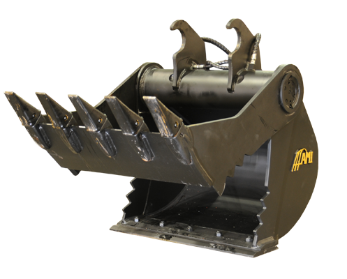

I've seen serrations on the edges:
and teeth on the corners, like this excavator bucket:

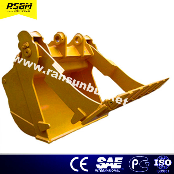

I don't see why you couldn't put on some interlocking teeth like a clamshell bucket. They could be inside or outside. Bolt on so they could be removed if they are in the way for some jobs.
clamshell bucket

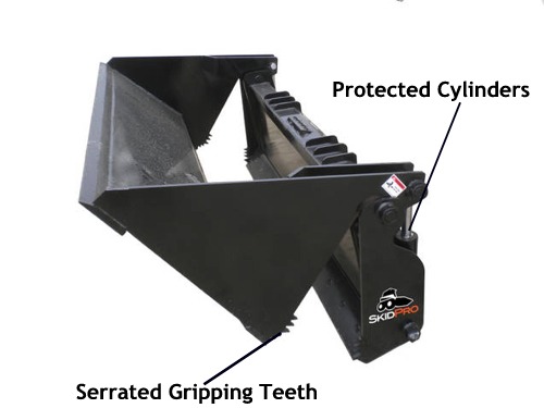

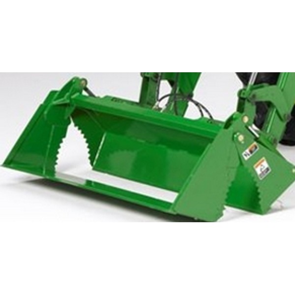

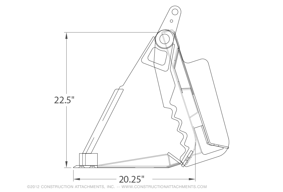

A google image search shows some with teeth on the side:
