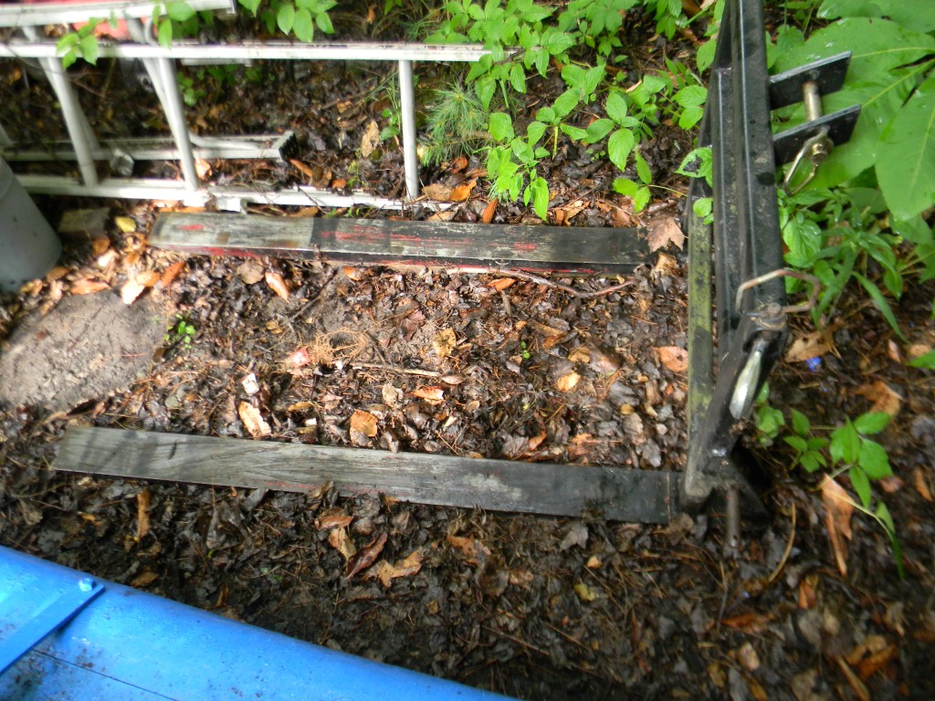

My old post here has photos using a forks adapter I made to fit on a Qhitch. if you are going to build something similar, this might give you some ideas.
Here's a photo of it:
70566d1171849399-pallet-forks-rear-3-pt-p1050892r-jpg
   / Rear Forks #6
I don't have a YM but I did build a set of rear forks that work on any 3pt. hitch. Mine also work using the quick hitch like California's forks. I also used them in the loader bucket of another tractor. I had a 2" trailer hitch welded to the top of the bucket so I could set the forks in the bucket and pin the top of the forks through the hitch. My latest tractor has QA loader bucket so I bought regular QA skid steer forks and haven't used the 3 pt. forks since.
