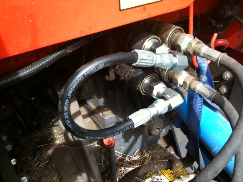

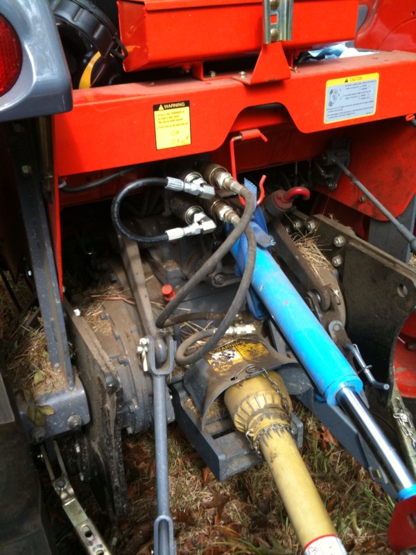

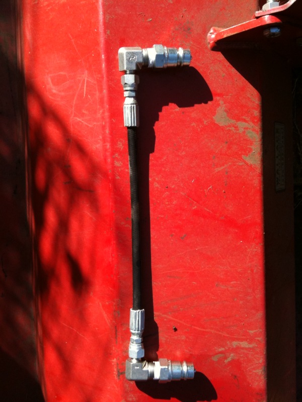

I decided one morning to get a small loop of hydraulic hose to keep permanently in the rear remote I use for my backhoe when it is not mounted. Although I don't think it is that common, the consequences of inadvertently leaving the remote engaged in a "dead head" configuration and the hassle and expense of repairs finally induced action. I went to the local hydraulic shop with a diagram for a neat little loop that stayed out of harms way but allowed hydraulic flow. I used 3/8 hose to 90 degree adapters (to keep the hose from sticking out the back too far) and then just about 8 or 10 inches of hose all connected to Pioneer male fittings. The good news is that it works perfectly and is very neat. The bad news is that I got reamed by the hydraulic shop ($70) and I even supplied the hose. I failed to ask if they had a minimum labor charge. I just love living in a big city.:eek:

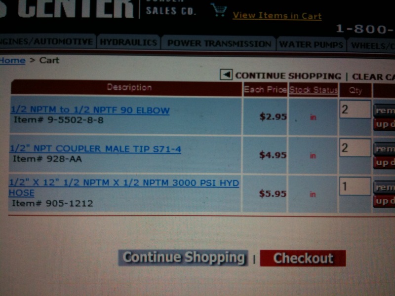

The good news for you guys who might be considering this is that the parts necessary to put this together yourself can be had for about $25 from Surplus Supply. I have included a photo/screen shot of what I should have ordered from them earlier. It would take about ten minutes to assemble with a little teflon tape/paste. Just make sure that when you tighten the last 90 degree coupler that it is facing the same way as the other one to minimize twist on the hose when connected.

I did not explain. The second remote on my machine is not spring loaded. It is possible to activate it accidentally or more likely to forget to put it into the off position after disconnecting the backhoe. If the valve is active/on and there is no flow through the remote, the pump can overheat and be damaged. Adding a loop allows flow which dissipates the heat.

I hate to repeat this, but always get an estimate, so at least you have a chance to check out another shop. I think that was a total rip off. It probably took him 20 min to crimp and put the QD's on. Sad indeed. You should let them know they wont get any more business from you, and that you will let all your friends know about their habits.

Well at least they used nice strain reliefs. Nice job. Now you need to a paint that ugly blue cylinder! It's blemish on your pretty orange tractor:D,

Are those really crimped fittings?
The ones on the long hoses in the first picture are definitely crimp on, the ones on the loop with the very thick, grooved body do not look crimped on to me, look more like the thread on kind.
It's bent too. A little too aggressive with the boxblade one day.:eek:
