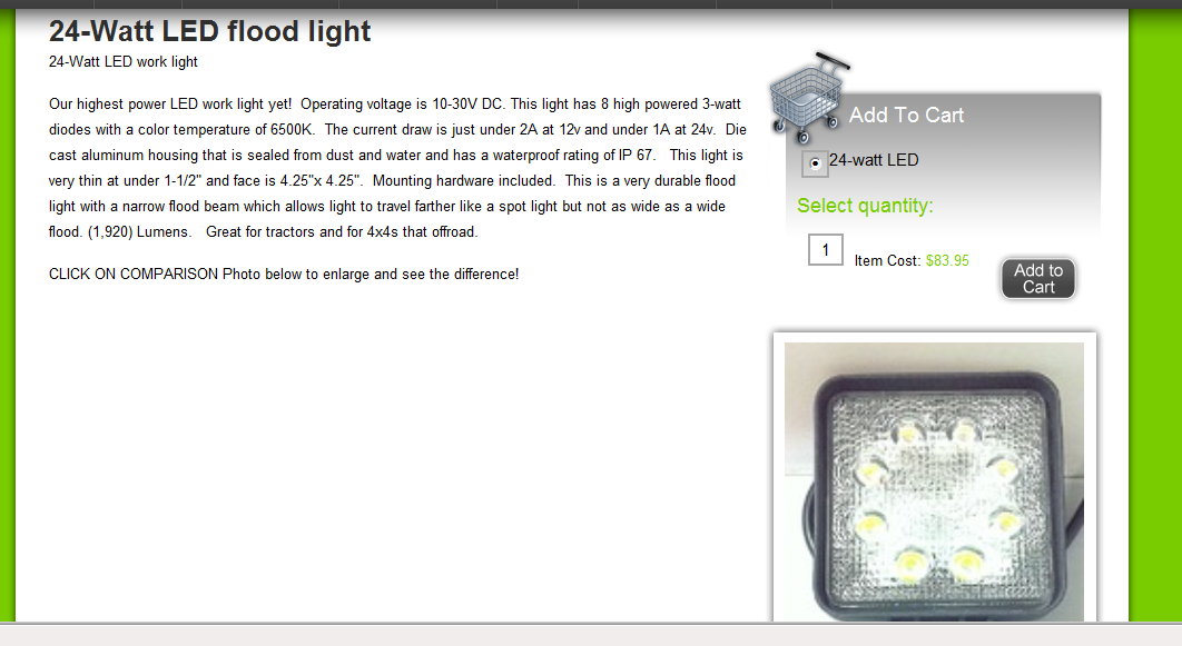

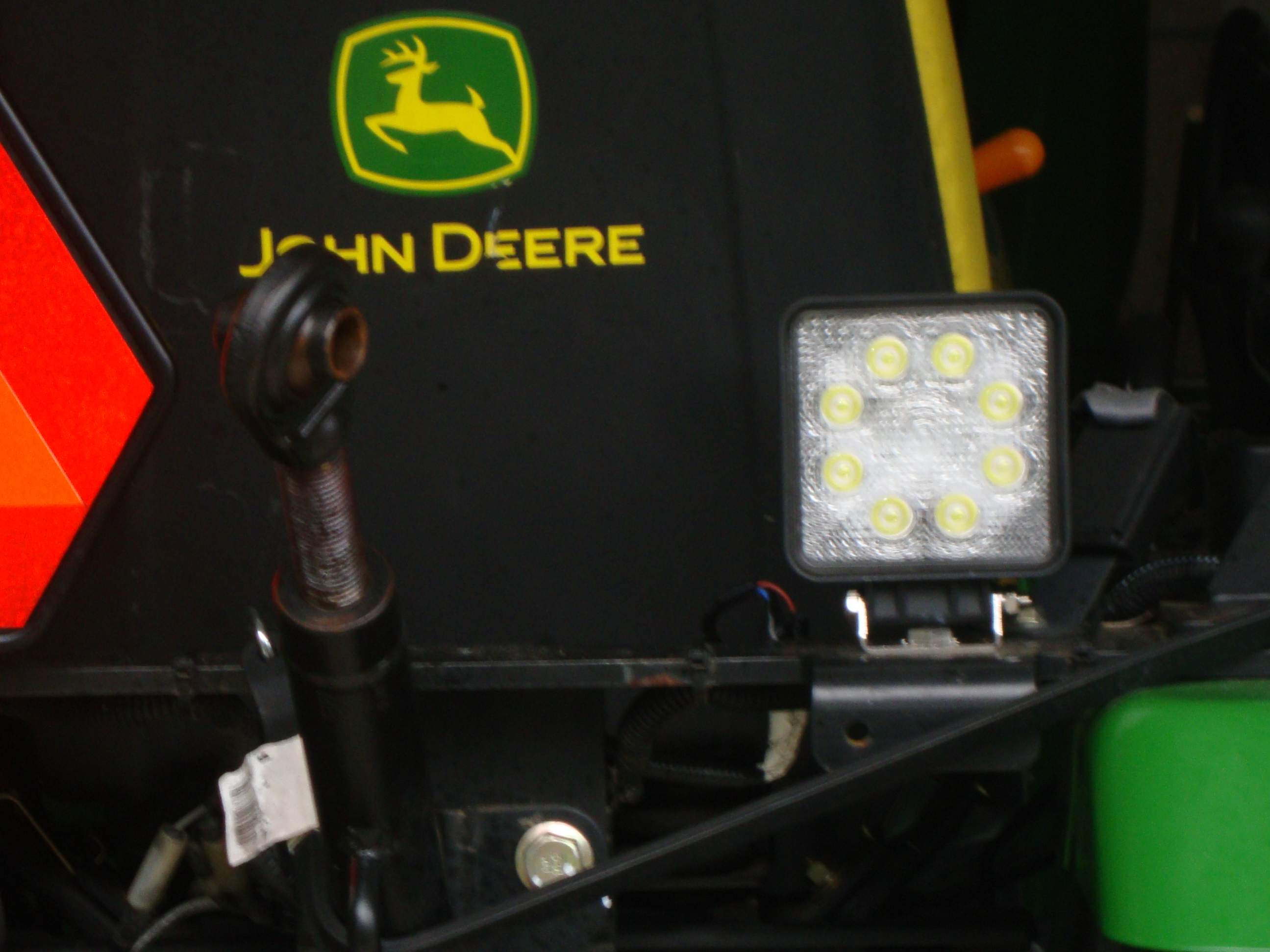

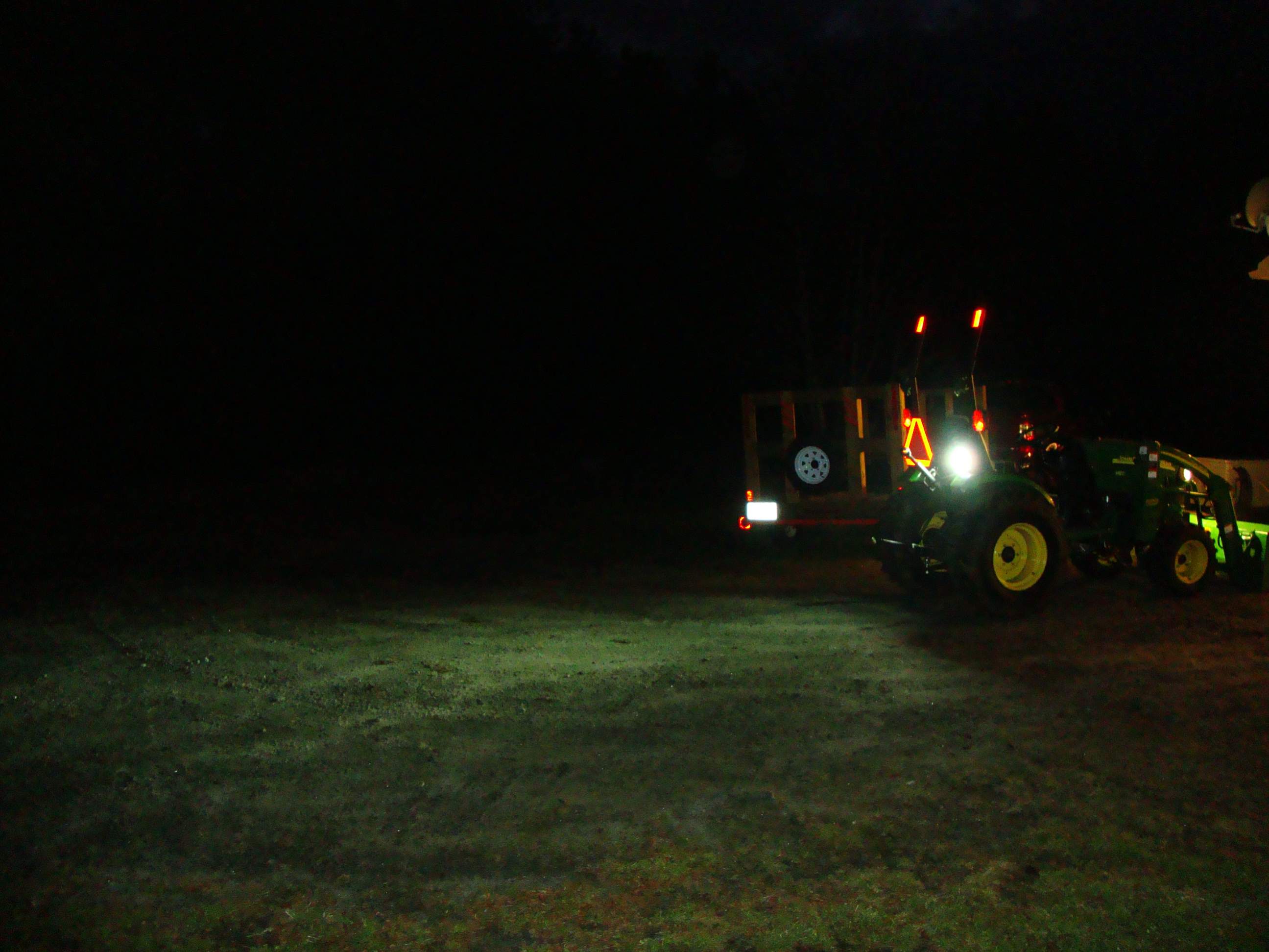

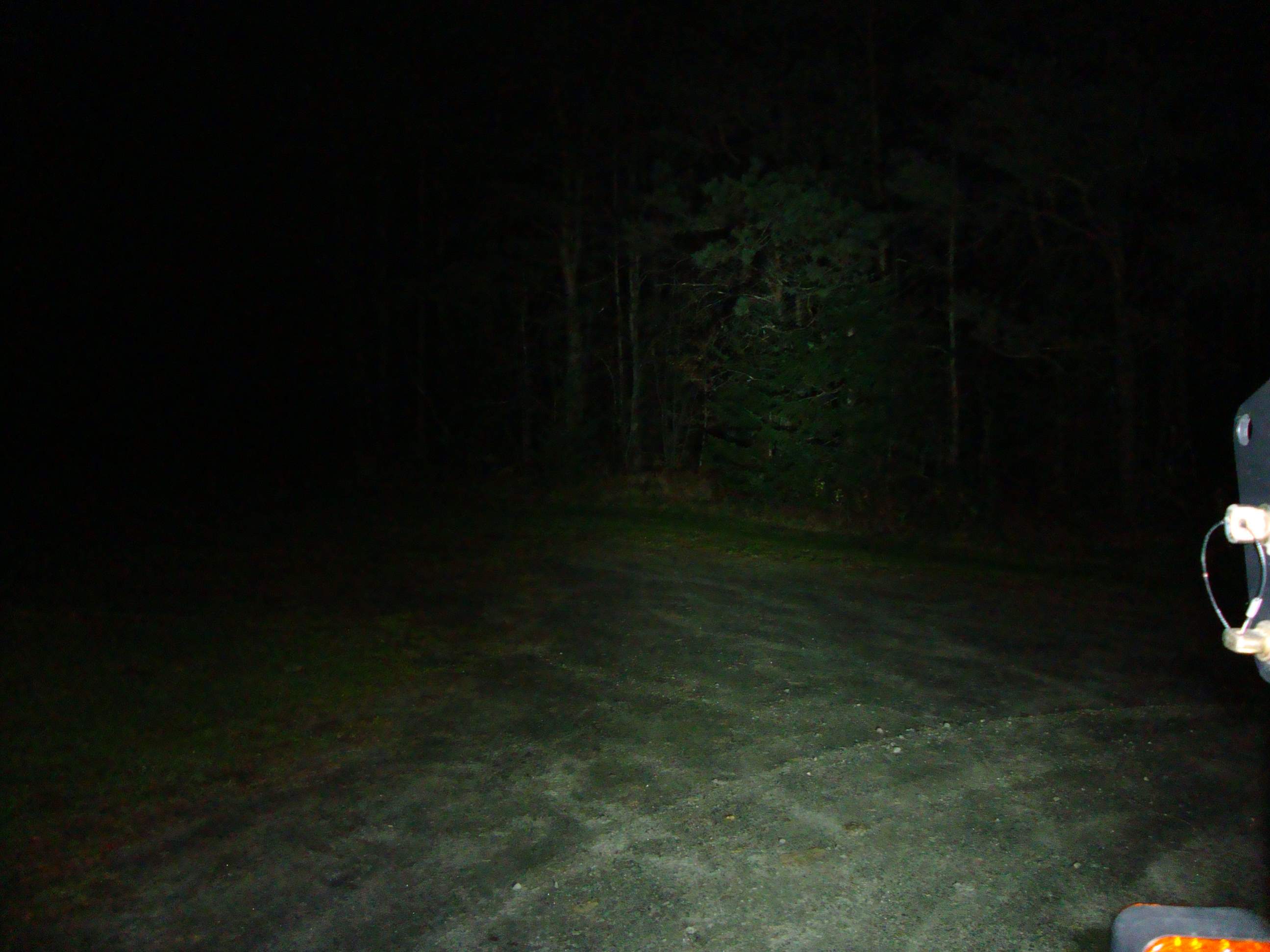

Just installed a rear led work light ( 24 watt ) on my 2520, works quite well.

Do you have any idea as to how the light output compares to a standard 55 watt tractor light?

Company is So Brite Lighting in Milton, ON. They come in round or square 18, 24 and 27 watts. Mine is the 24 watt, draws 2 amps and cost $70.00 cdn. My 2520 has 2 wires behind the rear seat that are for a rear light and go directly to the light switch so it was a case of putting two bullet connectors on the light and connecting it up. In the spring I might figure out to put one that would shine forward as I find the fel blocks the headlights when it is up.
