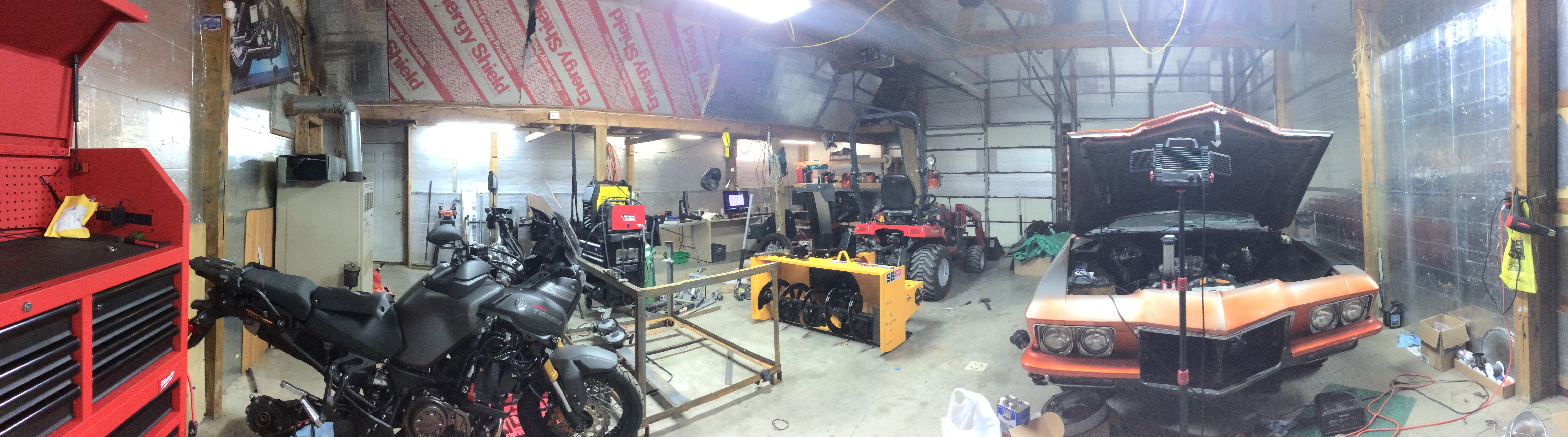

Well well well...just in time for winter...
