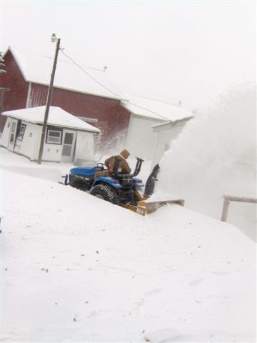

Here is a tc33d tractor creeping through dense drifted snow going as slow as it can go and using every HP it could muster. It too would not want to steer when the 60" Lorenz blower was lifted.
