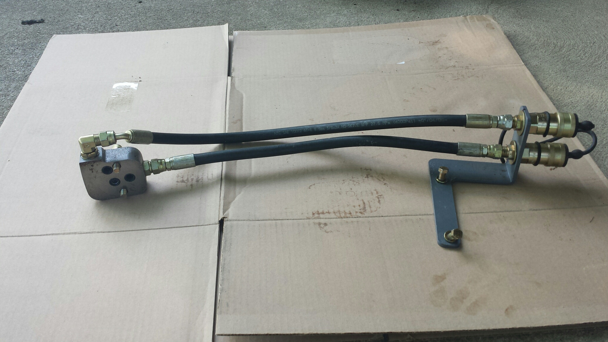

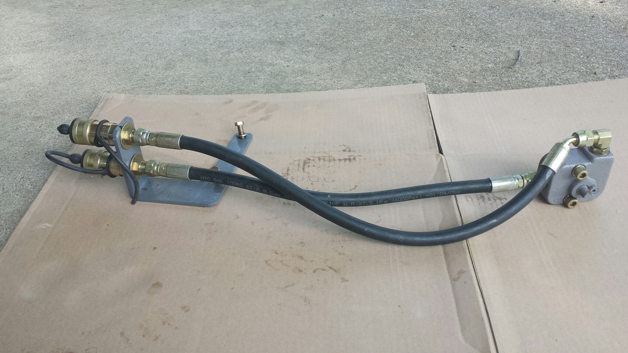

i posted this in another sub forum but someone suggested i try here.... hope you can help!
Hey guys, ive been lurking around for a while and need some help here. I am working on my brothers kioti ck27 which he has a rhino 75 backhoe on. He would like to get rid of the pto pump and run the backhoe off of a set of remote hyrdos in the rear. I am looking into getting the kit and am having a problem finding a full "kit"--- if there is even a one-click setup available, im not sure.
anyways ive looked through a couple of the threads here and i feel confident i cant tackle this job myself. I do plan on calling up a rhino dealer and seeing what he can do but from my previous dealings with them they really like to give it to me rough on pricing---and even harder when i refuse the service of letting them install it! haha
can anyone throw some part-kit numbers at me and also a good place to purchase from?
i had seen some of the threads mention "wallace" but im not sure if hes around anymore--- or is even still a kioti dealer
thanks in advance!

FYI - the Kioti kit (first two valves) will have the control handles that fit the machine - no 'making do'.
   / Rear remote kit
#9
Okay i just talked to someone and they said i might just need a hose kit? apparently its cheaper?? does anyone have any info on this??

If your FEL valve has PB adapter, and there is a PB hose going to the 3pt, then you can interrupt the hose at the 3pt input and put a QD on it and use that as the supply for the BH.
When not using the BH, plug the QD into the 3pt input. BH OUT hose will go to tank.
