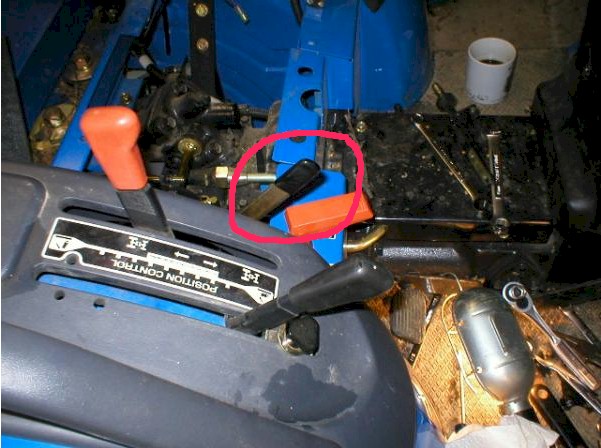

   / Rear Remote question #10
<font color="blue"> HELP!?! </font>
Here's a link to the thread where Jerry (Inspector507) installed a rear remote on his TC18. I imagine the TC24 is the same.
I've attached one of the pictures that Jerry posted and circled the lever that controls the single rear remote.
