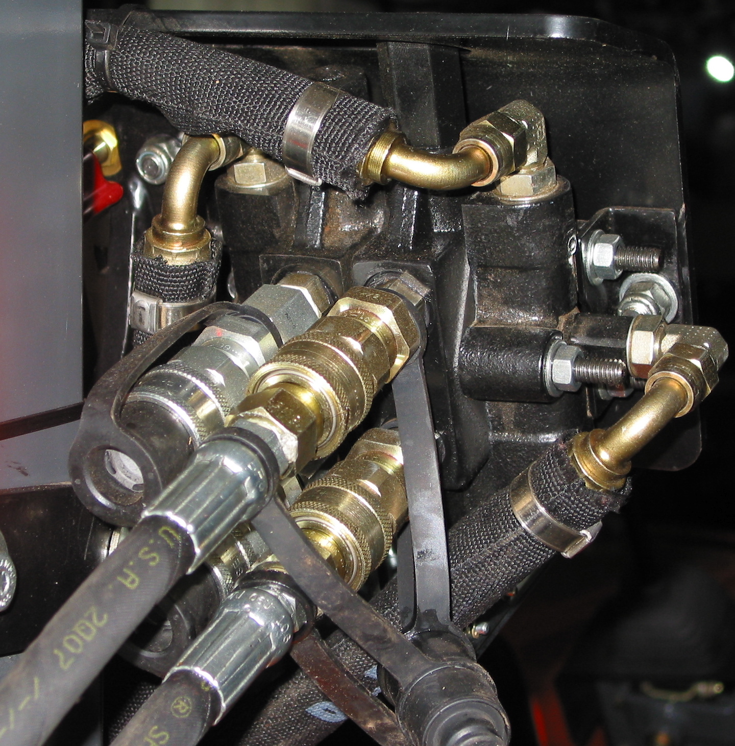

I just had Kubota rear remotes installed on my B7800 prior to delivery. The factory set up has 3 hydraulic lines going to the remote valve body--it's a TNT set up. Hope this helps.

I've been doing alot of research, and i see that Kubota does use three hoses..
Can you post pictures of the Kubota setup?
Thanks again!

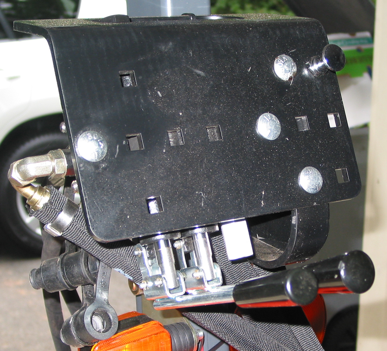

Okay, attached is the Kubota Rear Remote set up for my B7800. It has 3 hoses that go the valve block. The other 2 hoses are attached to my tilt cylinder :rolleyes:
The push pull switch on the right upper corner of the mounting plate is the switch for the extra lights I attached to the ROPS. It's a waterproof and sealed switch rated for 15A that I found at a marine supply store, it's all metal--no plastic.
Hope this helps.

sorry to drag this post back up but this looks very similar to the setup I have pictures of.
blackntan if you want more pics of the actual plumbing I can post more
captpat do you have any idea who makes your bracket, I really like that setup and would like to get one for my B7800
