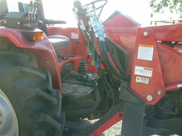

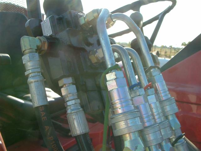

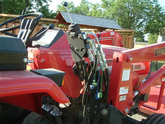

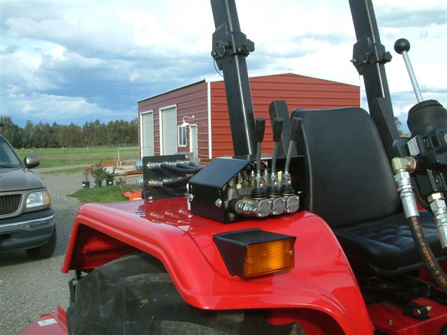

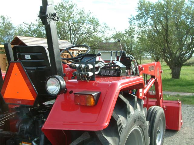

I think Mahindra has a rear remote kit for the 5525. I had my dealer (Dave's Tractor) install a set of triple remotes on my 2008 Mahindra 5525 when I bought it. Cost: $750 (IIRC).

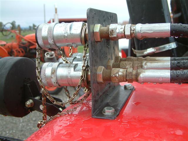

It's Dave's own design that works off the power beyond port on the FEL control valve. The flat top rear fender design on the 5525 makes it easy to install rear remotes. Here are a few closeups.
Good luck.
