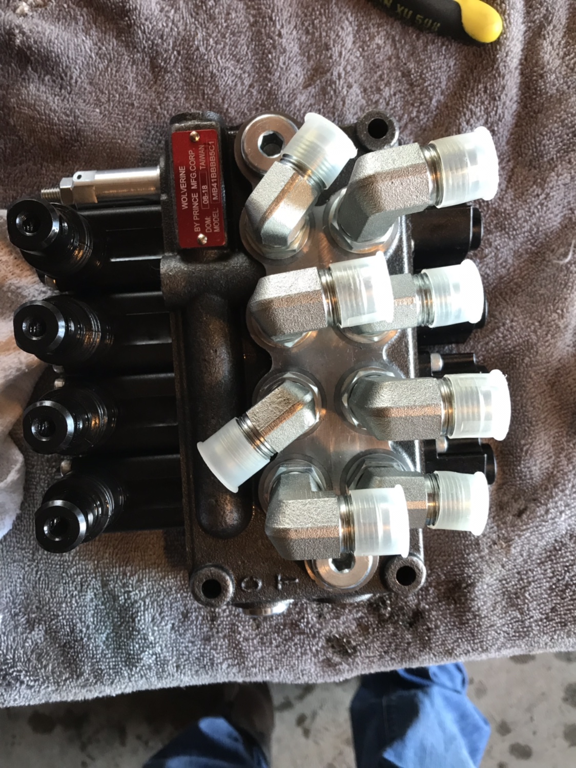

I plan on using the follow tall and short elbow fittings for the work ports on this valve for a compact setup at the valve.
681LL-8-8 | 1/2" JIC Male x #8 SAE/ORB Male 9deg: DiscountHydraulicHose.com
681-8-8 | 1/2" JIC Male x #8 SAE/ORB Male 9deg: DiscountHydraulicHose.com

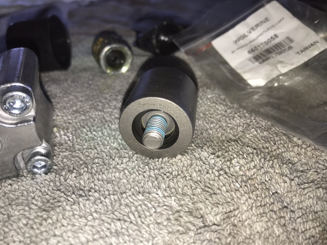

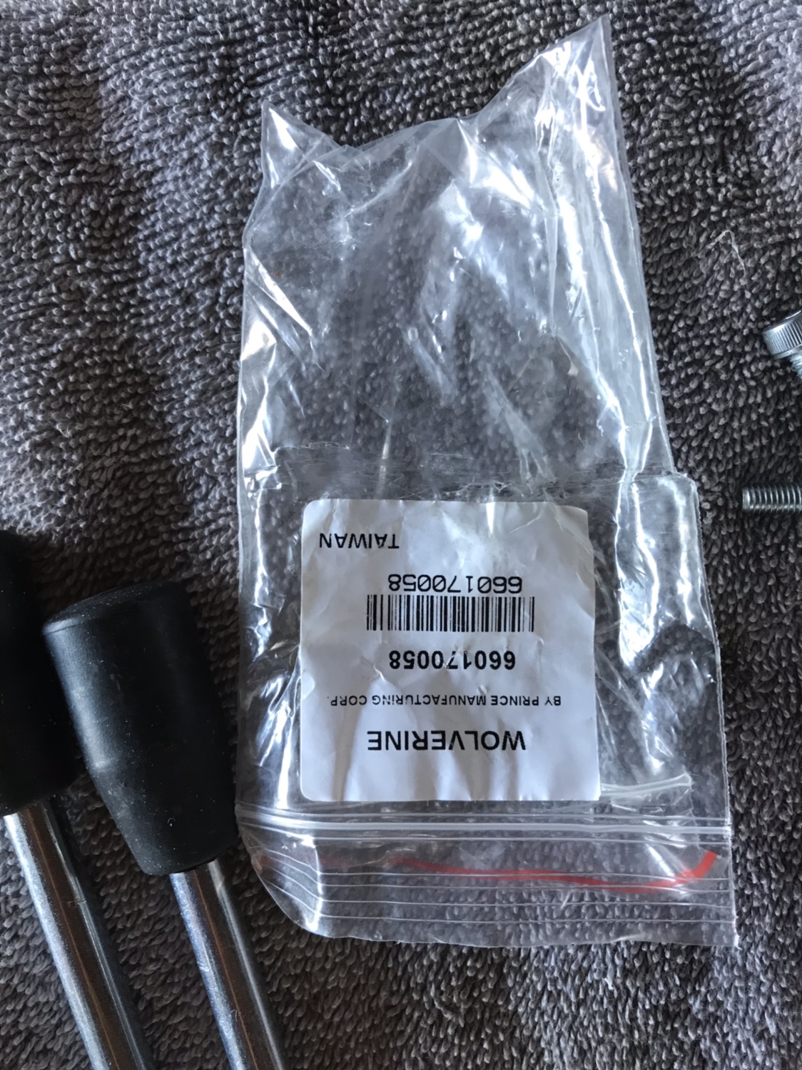

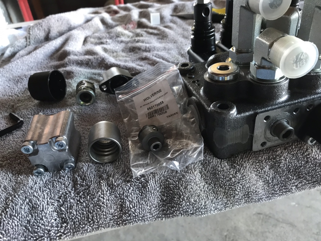

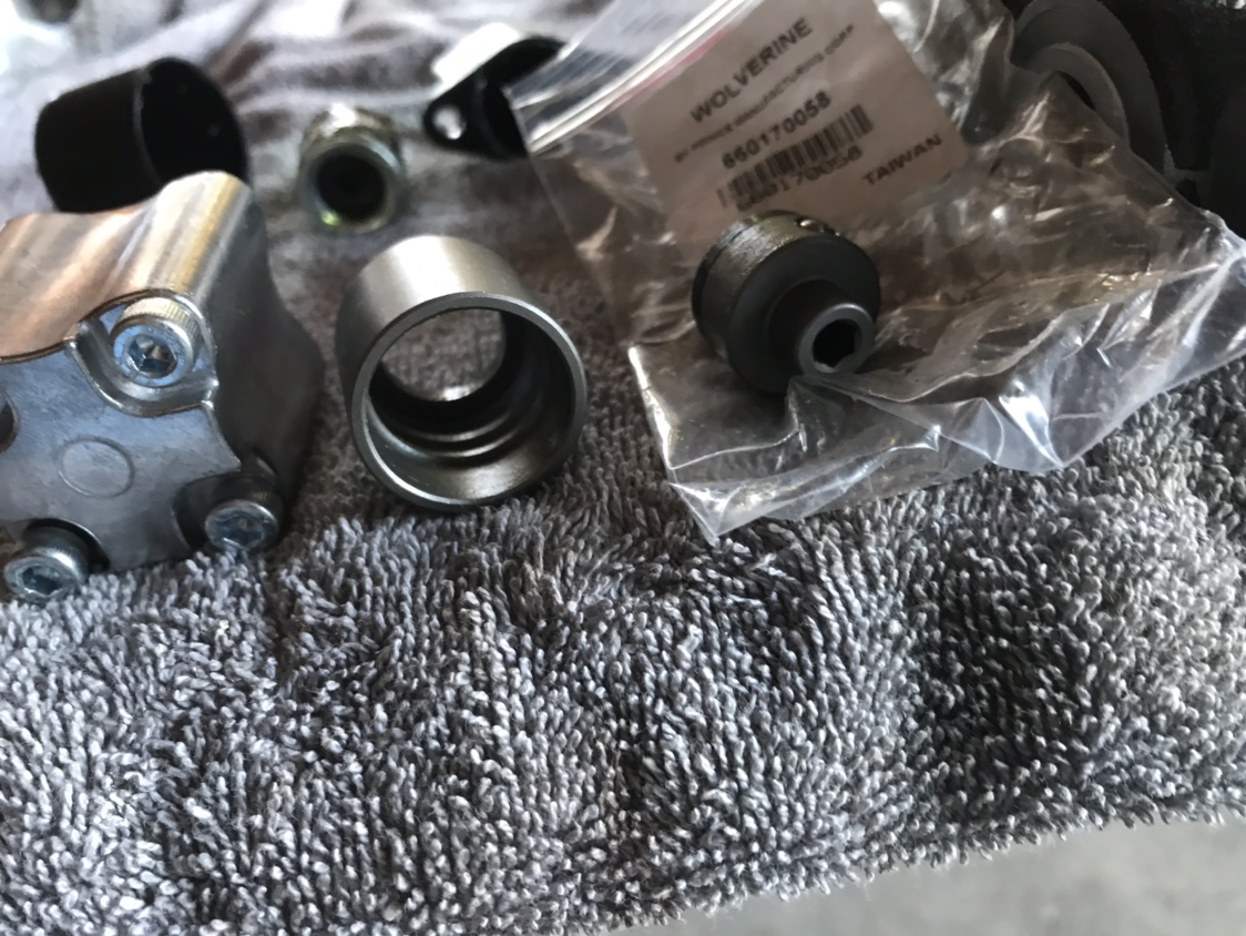

But as I was installing the detent kit on one spool and as I moved the handle to test it, the outer spool fell off. I’m trying to figure out which way it’s supposed to go back on. IMG_0120.jpgIMG_0121.jpgIMG_0122.jpg
I think the outer piece should go on with the lip inside first then the inner piece with the screw installed. But that would keep the outer piece from falling off as it did when I moved the handle originally.
It fits both ways but I can’t feel any detent by moving the handle either way on the bench. Maybe pressure is needed?
I want one spool to have a manual detent to feed the backhoe that I’m also working on installing.
Any body know for sure how that outer cylinder goes ? Lip in or out?
It came without paperwork from Surplus Center. I’ll call them this week if the brain trust doesn’t know.IMG_0118.jpg
Edit post...

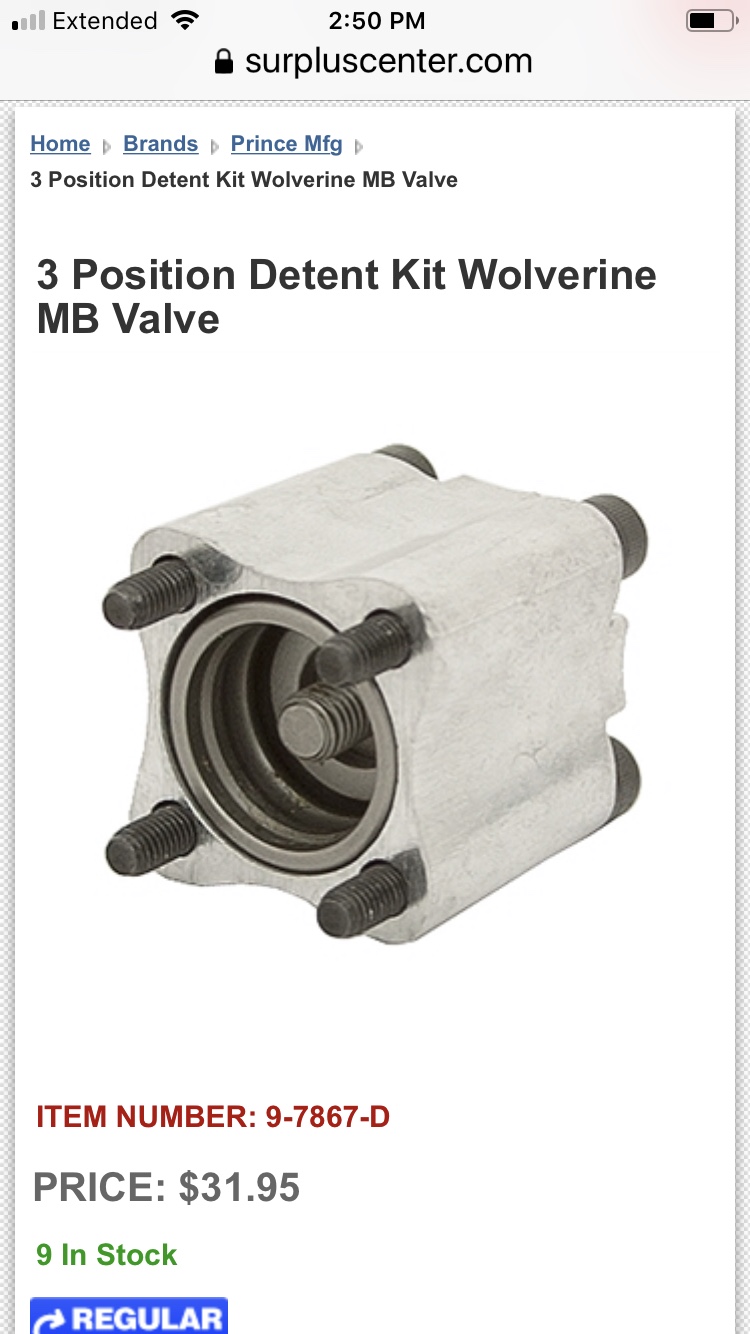

Looks like I’m wrong and the lip should be installed out.
Thanks
Lenny
