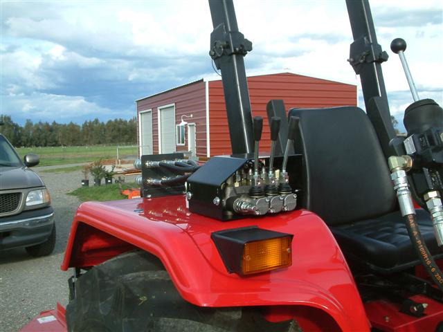

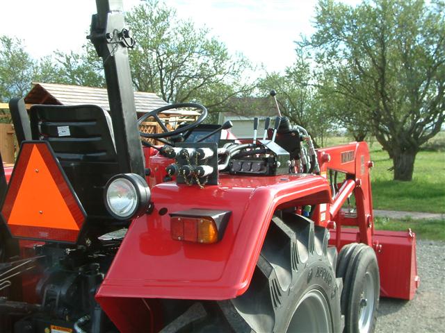

That's a pretty steep markup. When I bought my new 2008 Mahindra 5525, the dealer installed triple remotes for $700. Flat top fenders are an advantage when doing an installation like this.
There are plenty of threads on TBN that show you how others have installed hydraulic remotes. Check these if you want to DIY.
You can get most of what you need at Surplus Center (see the ad on TBN). Cost for a double remote hardware should be $400-500.

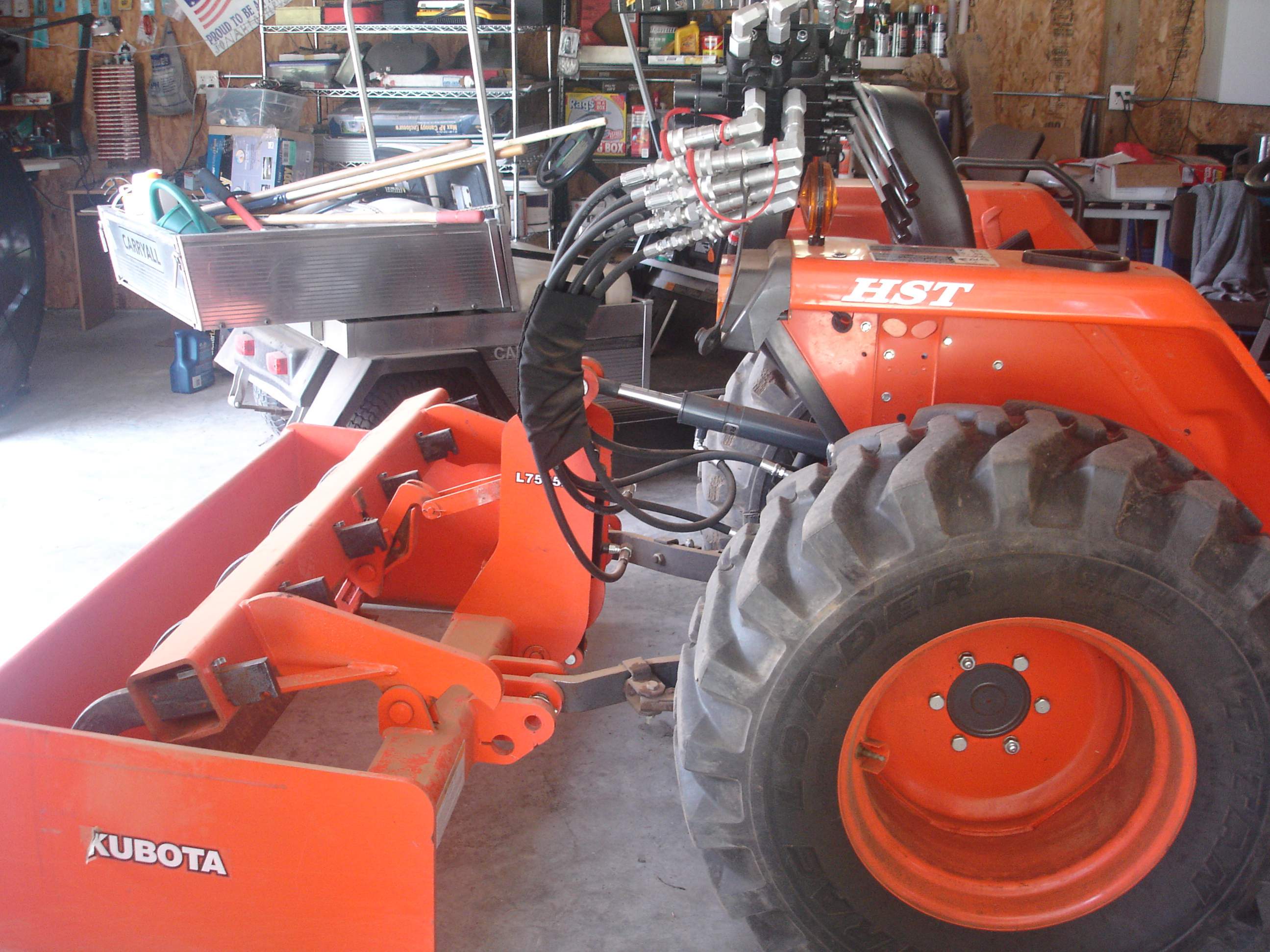

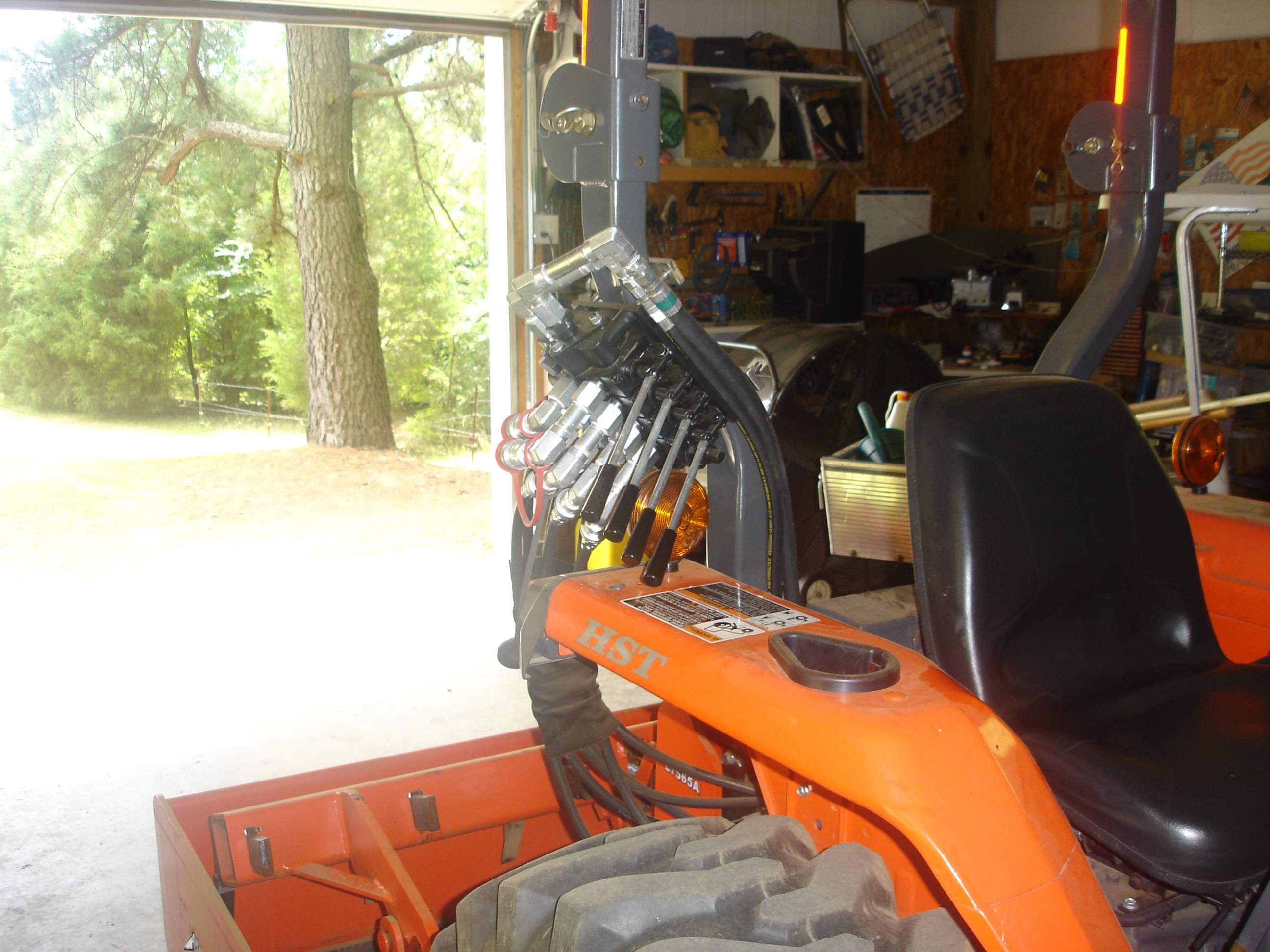

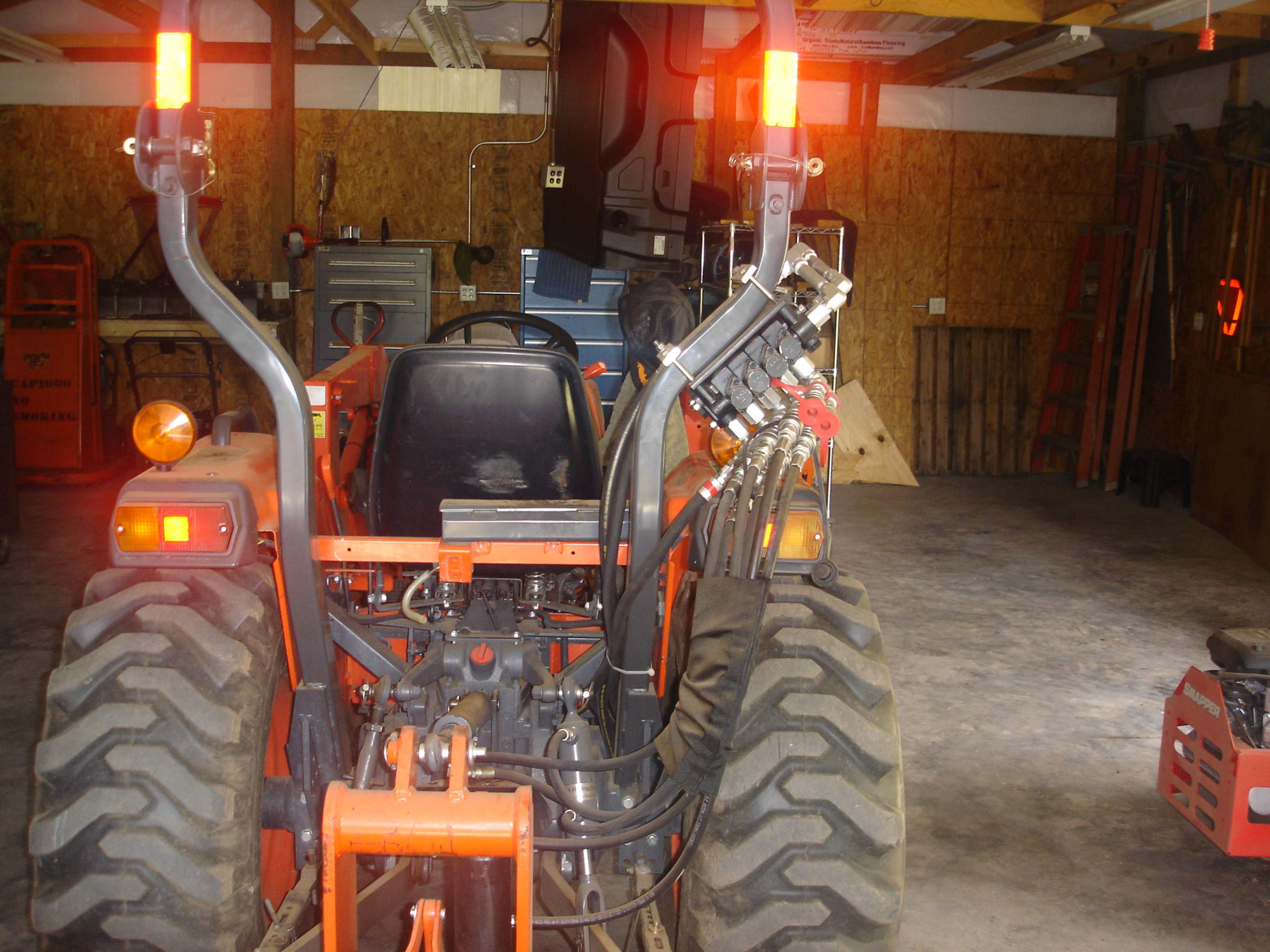

If you have the time, do it yourself. I have a few tools, enjoy learning new skills, and wasn't in any hurry. When I bought my tractor back in March, I couldn't hardly spell hydraulic, much less understand it. Now I have a 4 spool remote valve stack, 3 with float and one full detent. 2 of the 3 with float are connected to the top and tilt, and the third controls the scarifiers on my box blade. The 4th is full detent and is for future use... log splitter maybe? My valve stack and hoses came from Surplus Center and the fittings are from Discount Hydraulic Hose. I haven't added it up, but it was in the $800-$900 range, the valve being about 500, the rest being fittings and hoses.
You won't find a more knowledgeable (myself excluded) and helpful bunch than you have here. I wouldn't take a gold monkey for the learning experience, but if you are in a hurry, you may want to farm it out.
