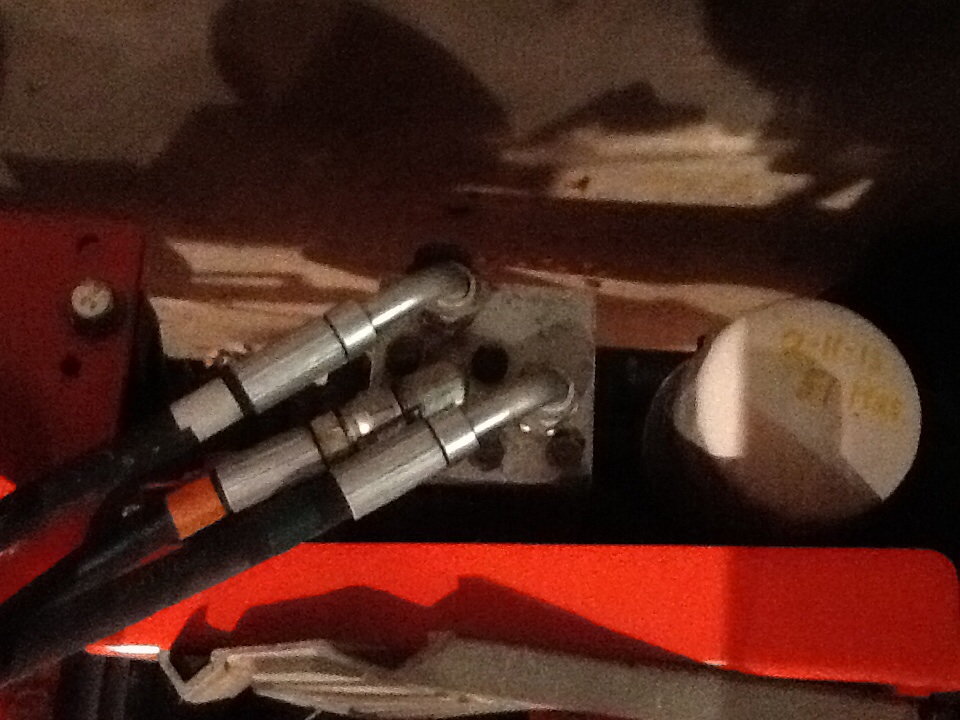

Does anyone know if the inlet on the 3rd valve gets plumbed in to the pb port on my loader valve? or out of the top of my 3pt hydraulic inlet port
   / rear remotes #2
You should have a hyd block, add the 3rd function valve in series with the PB line after the hyd block.
   / rear remotes #4
Did they leave you with a hyd outlet somewhere around the 3pt?
Look around under your right foot, and see if you see anything like this.
There is a PB hard line from your loader valve 080 in the schematic that goes back to the 3pt.
You can cut that line and use compression fittings and add whatever valve you want.
The PB line would go to the IN port of the 3rd valve, and the OUT would go to the 3pt.
How do you plan to use the 3rd function valve.
