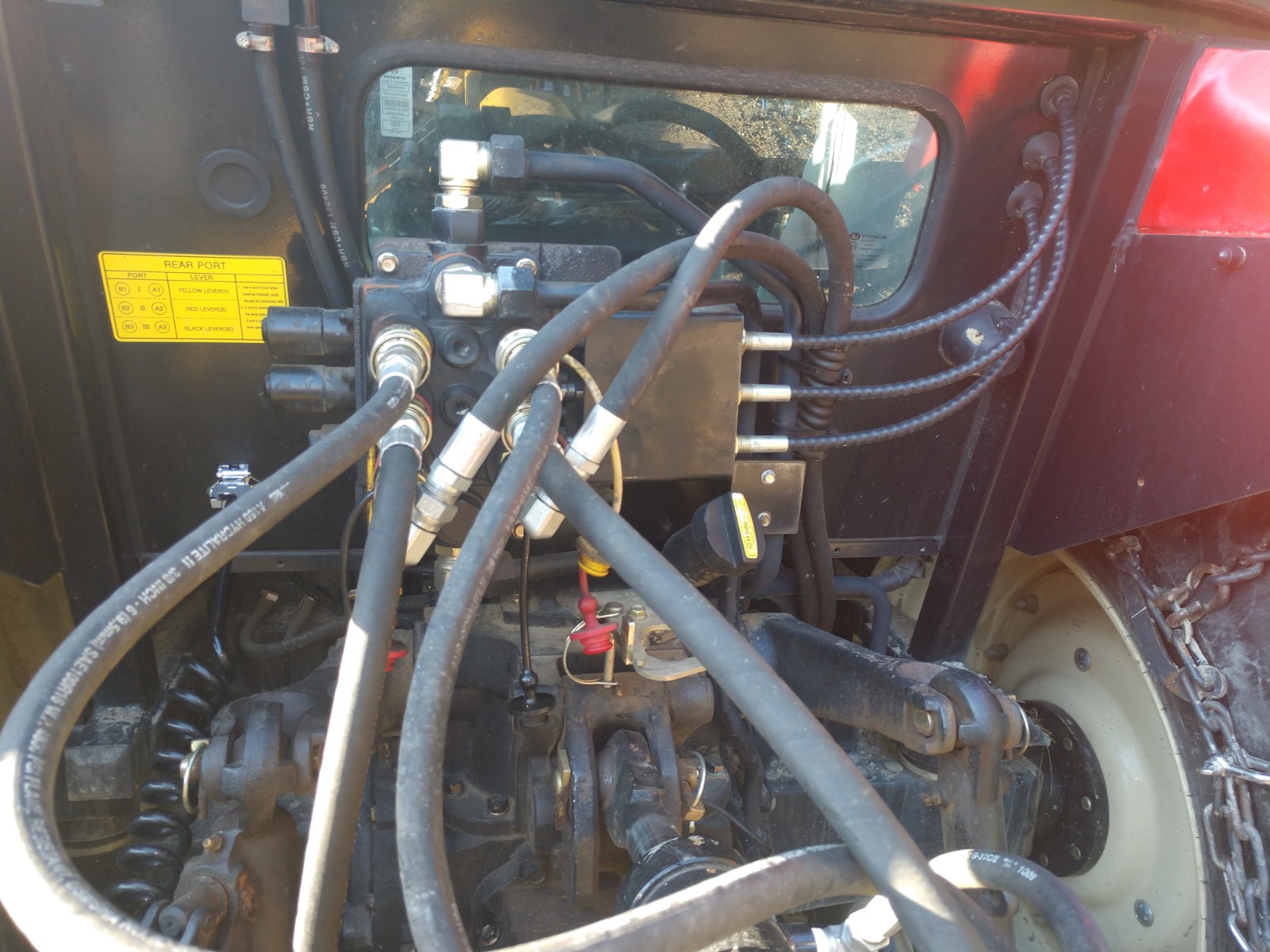

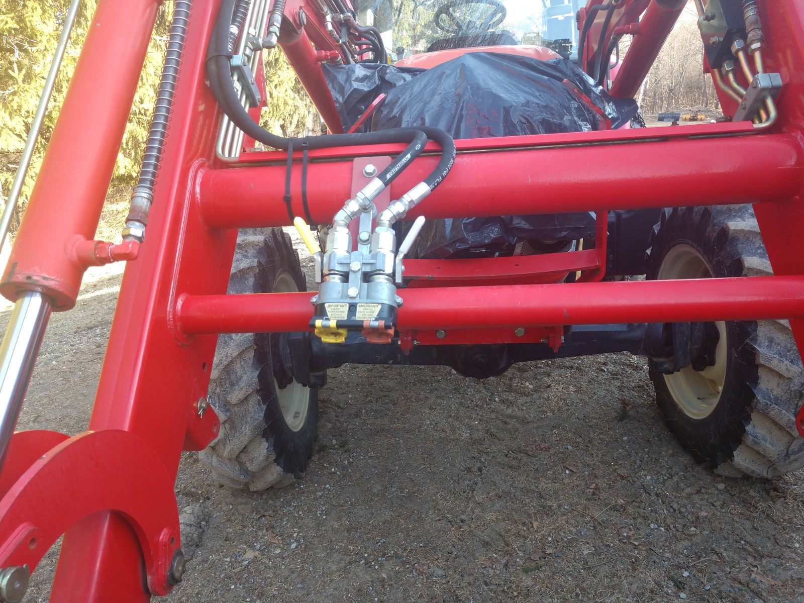

I ran the lines from my rear valve up under the cab to the loader frame, following the factory lines along the loader boom then to my quick connector mounted on the loader torque tube. The fancy 9500 series quick connector was my most expensive (about $120) piece and I had that from a previous purchase on sale. A 3/8" 120" jic ended hose will be $27 to $28 from Surplus Center.
A fairly easy way to figure out the length lines that you will need is to route a garden hose thru were you would run the hoses mark it then pull it out to measure.
As far as the quick connects they can run from $20 a set on up,
I have 3 remotes, the top one is going to my hydraulic top link, the middle one to the back blade and the lower one with the right angle fittings is going to the front. Depending on what's going on I can and do move them around.

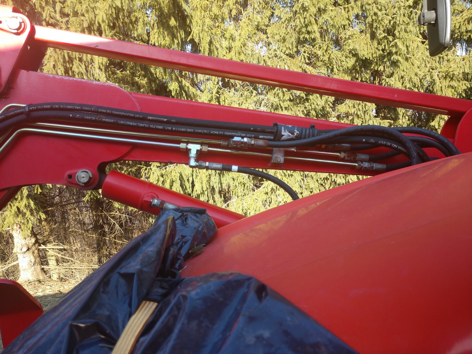

lines coming up along the loader frame,
along the boom arm,

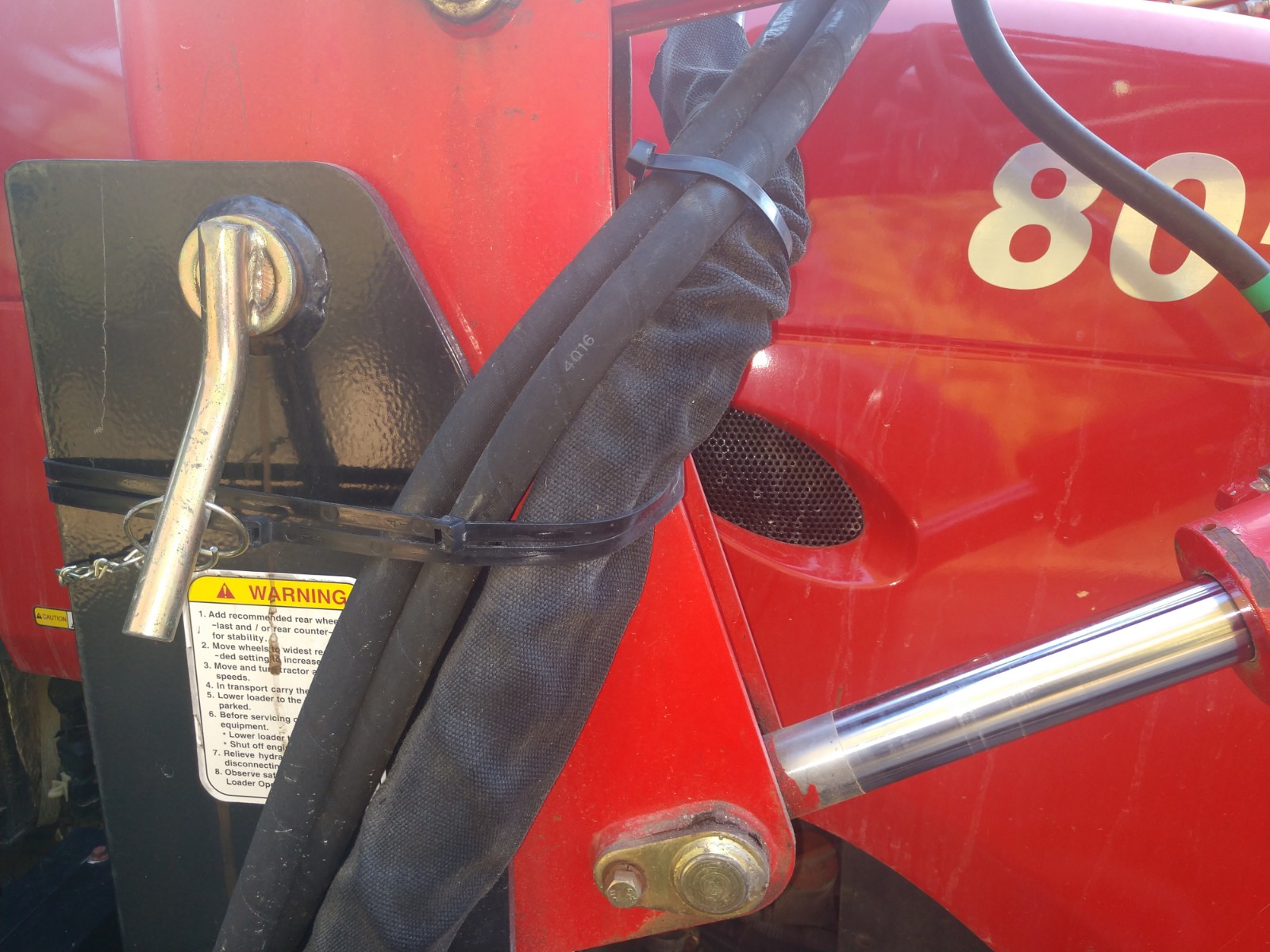

to the quick connectors, this fancy one is not needed but is nice, any of the bracketed ones would work.
