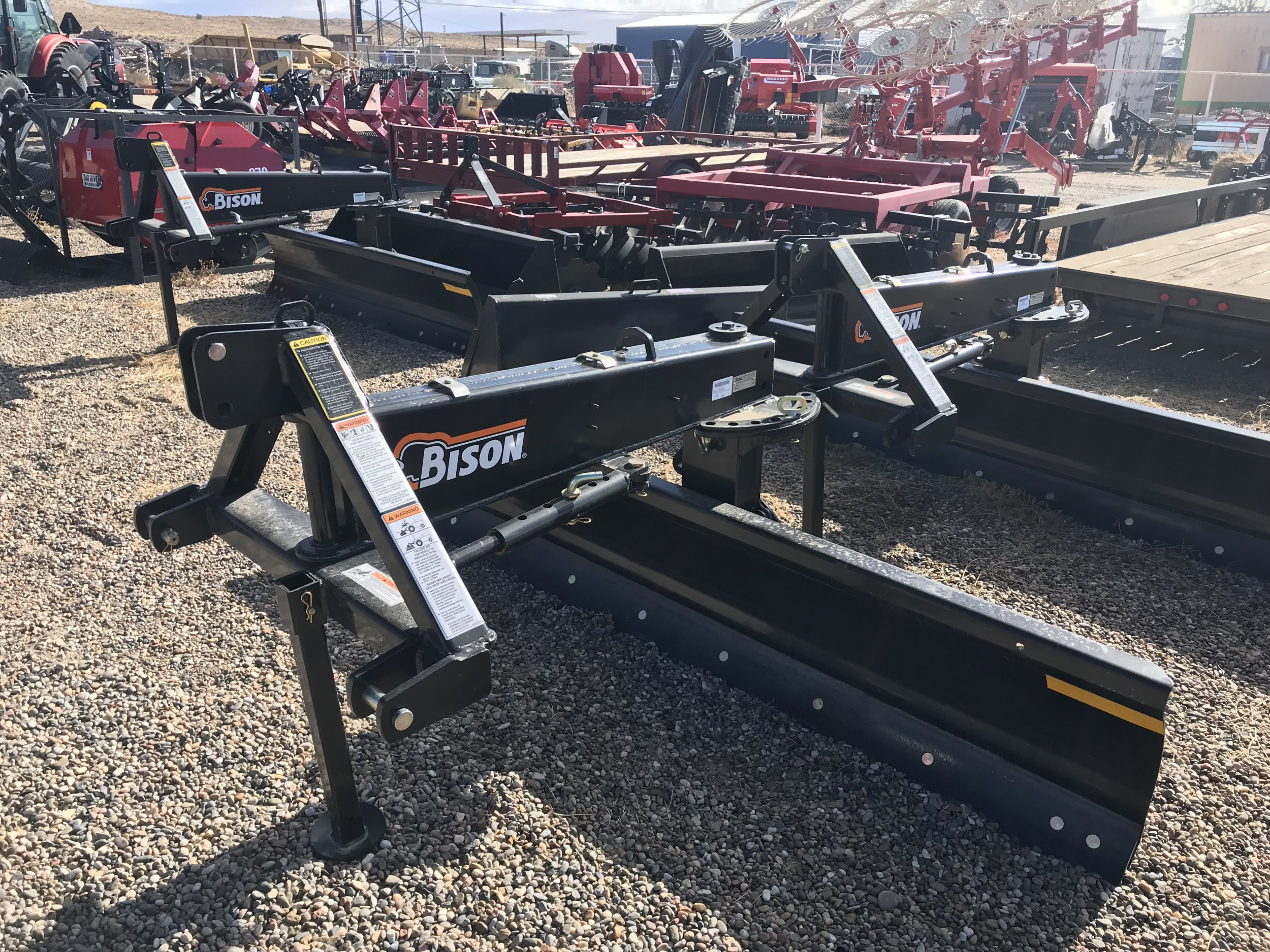

My tractor is a Yanmar YT359C and I am looking for a heavy duty rear blade 8’ long. Does anyone manufacture a rear blade that is set up for hydraulic but can be purchased without the cylinders. My plan is to use it manually at first and then I want to talk to Brian at Fit Rite about purchasing the cylinders for offset, tilt and angle. Also I would like a blade weight of approximately 800 pounds give or take! Thanks

Bison blades. I have one, 1000# but it’s category 2 pins. I really like my blade because it tilts and offsets but it’s a lot to muscle around by hand. I do it but am careful to be on level ground when adjusting because the weight will pull the blade when you remove the pins. It’s currently selling for $2700 in 8’ length.

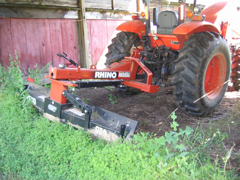

My Rhino 950 is eight foot and weighs 1050#. Purchased with manual controls but for around an added $1200 it can be made completely hydraulic.
