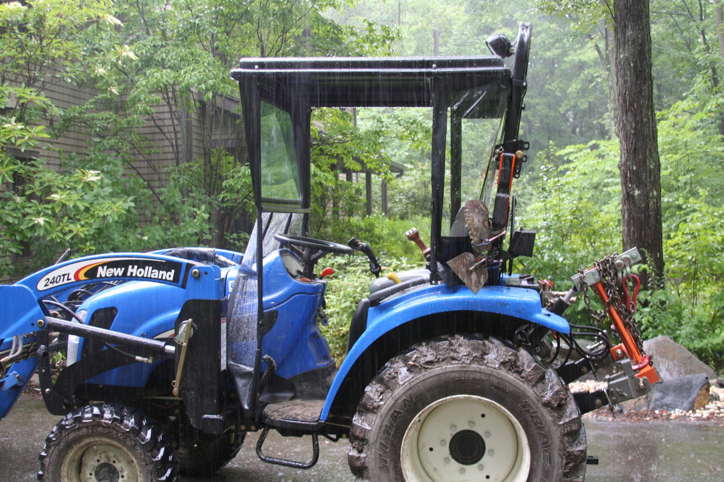

Wind and snow blower. You are going to to want to get a cab. NO matter how you point the chute it will go down your neck and blow in your face. I know. I got a soft cab and it works great.
So true! Most of the year, my tractor is an open station, but when the snow blower goes on, so does the winter cab. I've run enough walk-behind blowers to know what Frosty the Snowman feels like.:snowman: I don't like it.:yuck: Any kind of cab is a good one.
As far as rotators go, My blower still has the manual crank on it, but I've added an electric rotator (Too cheap to get hydraulic!:greedy:;)) to it so I don't have to stick my arm out the back window anymore. Love being able to control things from inside of the cab in relative warmth. If you have the means to get and use hydraulic, I'd go for it.
