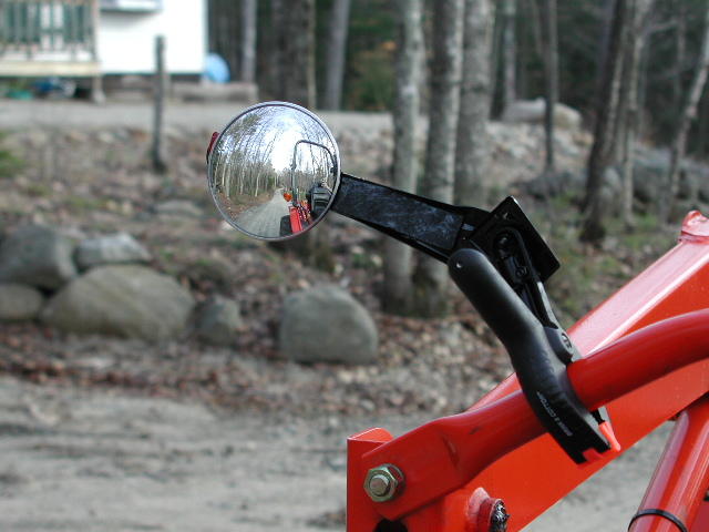

I have followed a number of threads concerning getting the best view behind us when the need arises to have seat time on the road. I needed to have a temporary solution for a rear-view mirror. I hate to add things that get ripped off by brush and bad bushes when I am trying to get a job done.
I came up with this idea after going into my "material storage" and discovering a number of items laying in wait for a job to do! The spring clamp was a cheap clamp that came with an inexpensive quartz area lamp. I used an aluminum bar 1" by 1/8" and added a few holes and bends where needed. An inexpensice mirror from Wal-Mart finished off my needs.
I now use it when I have to road the animal. An additional safety item I add to Big Blue when necessary, but hangs in the barn for most of its' new life.

Excellent idea boomerboy.
   / Rear-View Mirror #4
Very nice!
Chris
   / Rear-View Mirror #5
I have been trying to figure out how to attach a mirror for some time now.That set up is great!

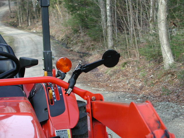

Another View . . . .

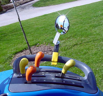

Boomerboy,I have been trying to figure out how to put a mirror on my rig for some time now. What a great way to do it! You inspired me. I took a spring clamp and bolted an old rural mail box flag to it and glued the mirror to it. I can clamp it anywhere and tilt it as well.David

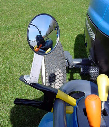

A second view

...and you'll never find it laying on the ground after doing battle in the brush! It will love the barn wall when not needed!
This is why I have such great hope for this discussion group. We all need ideas on building up our toy inventories for our favorite rides!
