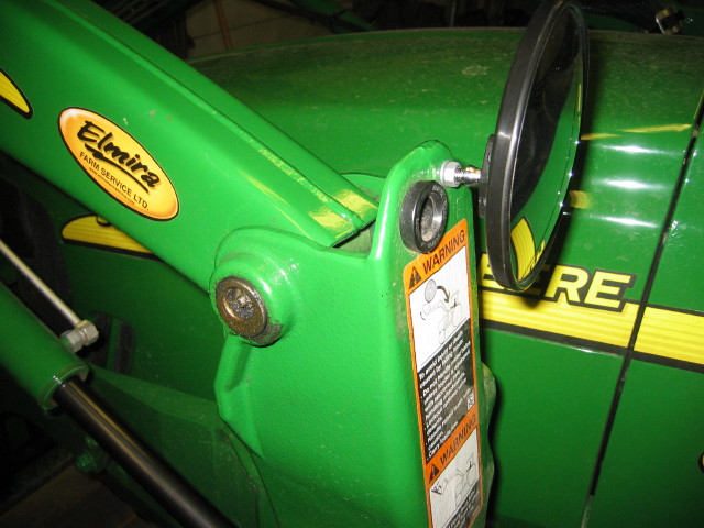

A few weeks ago I commented regarding some mirrors that I installed and someone suggested pics. The camera and tractor were not in the same place until today.
To recap the tractor is a JD 3320 / 300CX FEL Open Station. There was a hole at the top of the FEL mast with a diameter almost the same as 3/8" ID plastic tubing. I purchased a couple of convex mirrors with 3/8" mounting stud, cut a piece of plastic tubing for the hole and inserted the mirror stud in the plastic tubing. Used a couple of SS washers on each side. Presto - adjustable rear view mirrors - total cost about $15.00.

CinderSchnauzer - Thanks for posting the pictures! I have been wanting to add mirrors to my Kubota for snow plowing w/RB. I also have an existing hole in my FEL mast, but it is about 2" above the bottom of the mast. Do you find the 5" round convex mirrors provide enough field for your needs? What specifically do you use them to see? Are you looking at a rear implement, or for people, animals and/or objects behind you? Thanks for sharing!
Yes the 5" convex gives sufficient field of vision for my purpose and are not stuck in the road for mounting / dismounting the operator station. Purpose is mainly to see objects / buildings behind when I'm doing snow removal or whatever with the FEL. I could have mounted larger rectangular mirrors but didn't.
The key here is not so much the specific mirror, but realizing the hole is there on the 300cx FEL. May be the same on all 300 series and maybe 400 as well. I always sort of realized the hole was there, but for some reason never made the mental connection to mount a mirror. Had I done it earlier, probably would have saved me from backing into the side of the shed with the backhoe bucket.

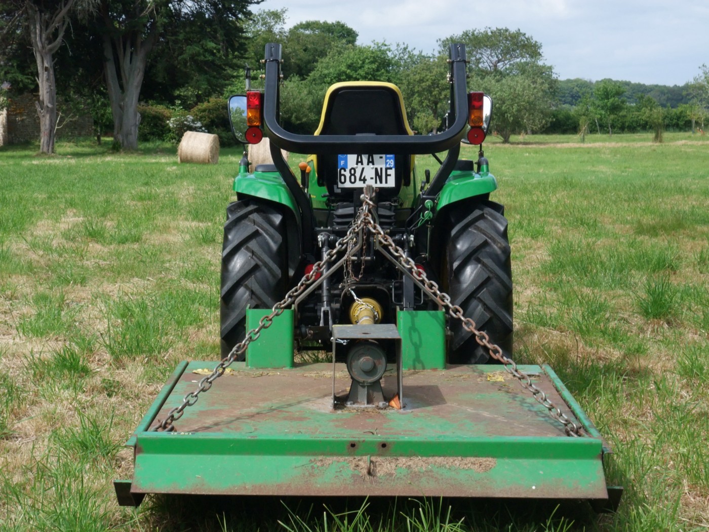

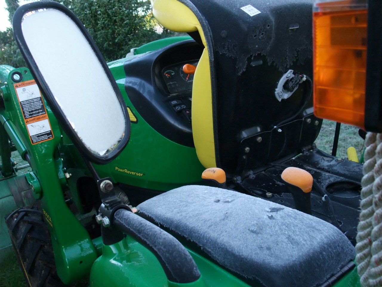

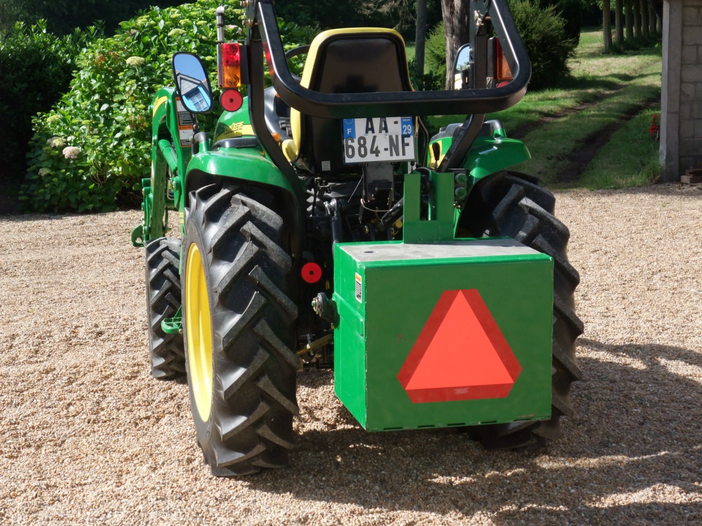

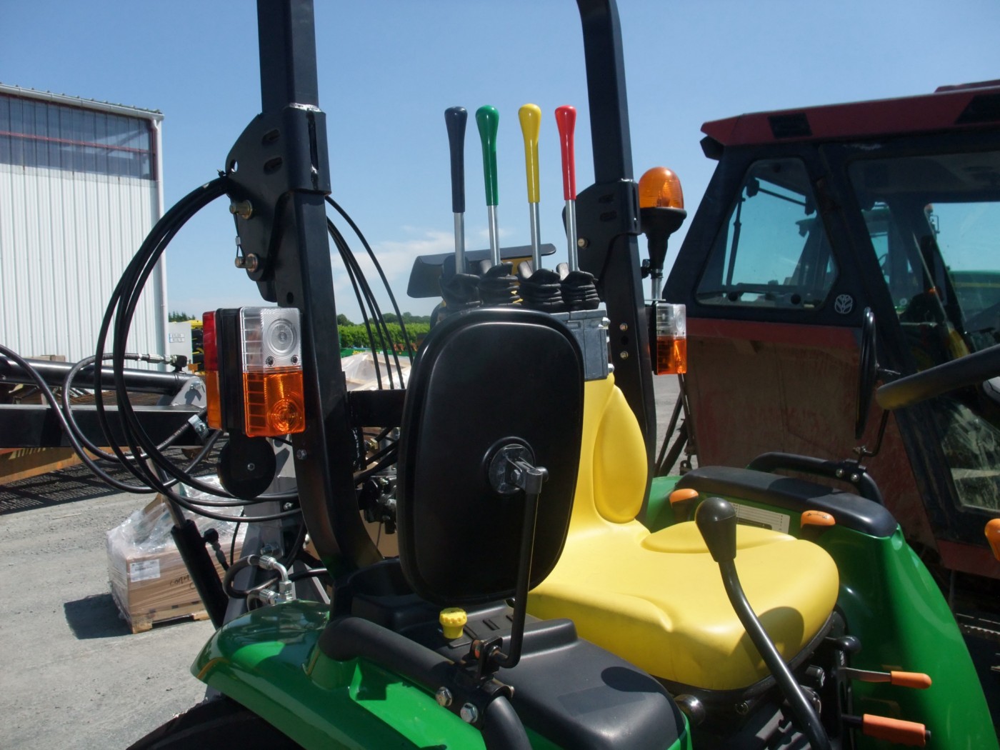

Very clever and inexpensive, congratulations !
But still not as good as the JD stuff.

Yeah...but a lot cheaper.
After you first posted pictures of those mirrors (Europe only, unfortunately), a TBNer did find them on JD Parts. IIRC, they cost well about $100 USD each.
